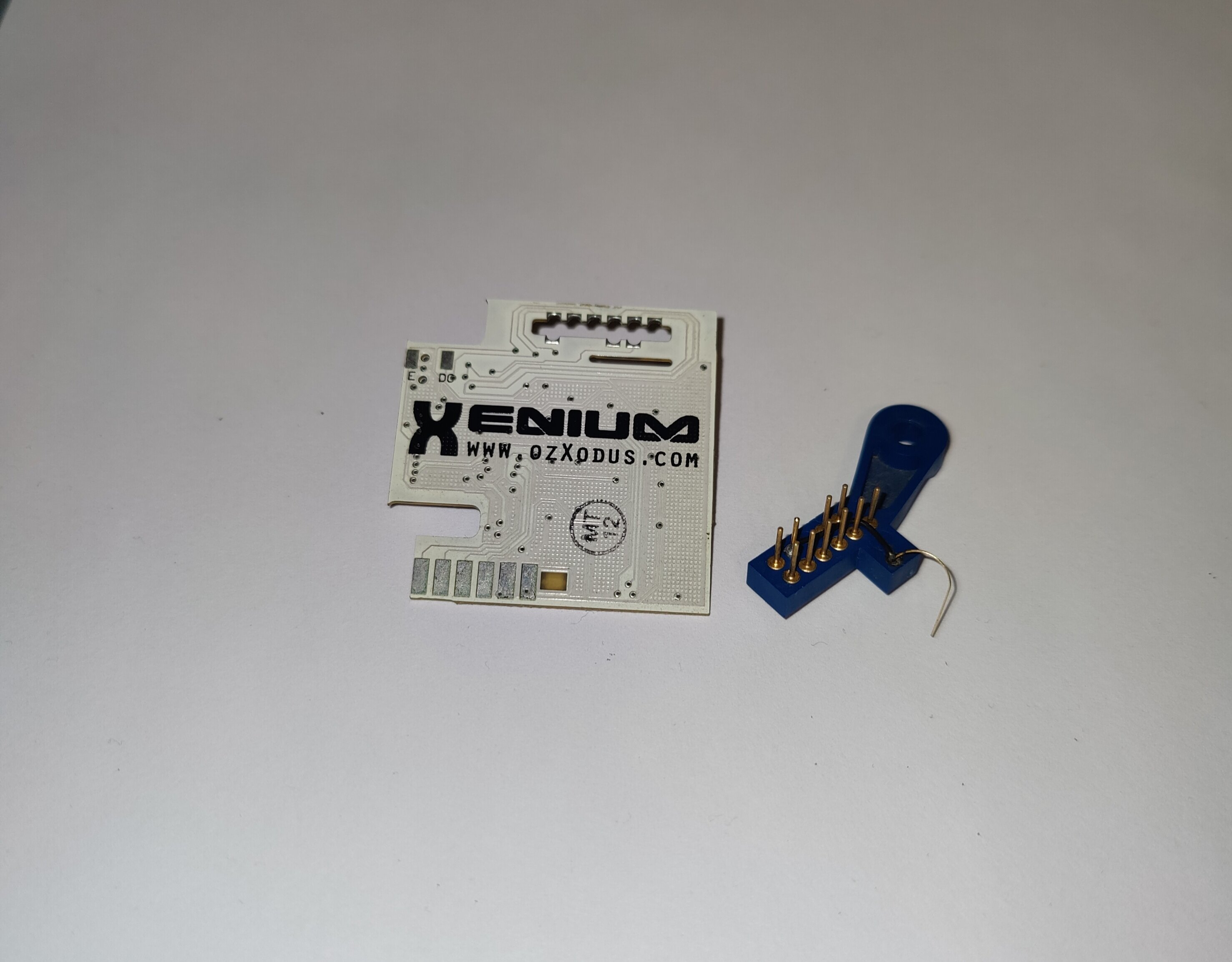

lopenator Posted January 9 Report Share Posted January 9 Does this one look like a clone? The vias in the "X" are black and yours are not. The cutout in the "U" looks accurate though. Quote Link to comment Share on other sites More sharing options...
vekter303 Posted January 9 Author Report Share Posted January 9 I am far from expert! I did a quick check from info linked in the post pinned at the top of this thread. I will have a look again and post... The typeface looks good. The 'D' has little serifs and as you say, what I assume the placement of the via, on the comparison shot looks good too. Quote Link to comment Share on other sites More sharing options...
vekter303 Posted January 9 Author Report Share Posted January 9 In the pinned "4th Generation Chips" there is a spreadsheet, a row "spotting fakes" then links to "1st, 2nd, 3rd Generation Fakes" 1 Quote Link to comment Share on other sites More sharing options...
lopenator Posted January 9 Report Share Posted January 9 5 minutes ago, vekter303 said: In the pinned "4th Generation Chips" there is a spreadsheet, a row "spotting fakes" then links to "1st, 2nd, 3rd Generation Fakes" very helpful Quote Link to comment Share on other sites More sharing options...
vekter303 Posted January 9 Author Report Share Posted January 9 (edited) Lots to learn! I never even knew there were so many modchips. Had an OG at the time and since, but 2019 was my first modded console. You never installed the chip? I am guessing that it was releasd a while ago, the website is not active... Edited January 9 by vekter303 Quote Link to comment Share on other sites More sharing options...
lopenator Posted January 9 Report Share Posted January 9 (edited) hell no. I installed a pin header. Those pogo pins are janky. edit. I misunderstood. yes I installed the chip. this is an old photo I took before installation. Edited January 9 by lopenator Quote Link to comment Share on other sites More sharing options...
