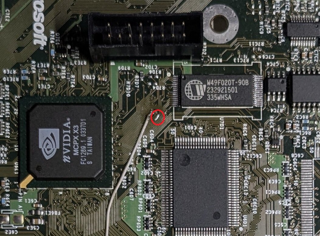

Posted (edited)
Hi again.
I attached some photos of the board.
Also, i touched up a bit the pins of the AV port with new solder, in case there was some pin with a cracked connection, but that didn't do anything to fix the audio issue.
The console continues to do weird shit. Whenever i try to do anything on the Avalaunch dashboard, be it open the file explorer, or to upload something through ftp, the console freezes and locks up.
I don't know what to do anymore. I'm starting to think that maybe it's better to give up and buy a new one.
When the console freezes, there is no change in the power LEDs, it stays  fixed green.
I hope the photos have enough resolution. If you want some clouse up of a specific zone i could do another pic.
Thank you allPXL_20250106_182107638.thumb.jpg.fe643e33ce0fd6da16d0c6308dbfbc8c.jpgPXL_20250106_182155361.thumb.jpg.3e15396433ff0e70383fb2431eae375d.jpg
Edited by aeleequis
7 hours ago, PRince404 said:
These stand out to me:

Now this does sound like a weird hardware fault. Could also be bad ram or somehow the data lines for the mcpx not working properly that it can't read/write data off/to hdd properly. Two things I can recommend now is to check if the capacitors replaced are of the correct value and installed in correct polarity. 2nd would be rebuilding the HDD via FatXplorer on a PC and just testing out a bunch of apps, dashes and games (don't clone or copy from the existing drive). Also are you using a Star tech Adapter or just a generic one?
Hey @aeleequis, forgive me if I'm way off here as I'm relatively new to the xbox modding scene myself, but I was reading back through this thread and noticed one of the issues you seem to be having is booting directly from the TSOP.
On closer inspection of one of your pictures, I noticed there is a solder blob right next to where the D0 wire is soldered, and it looks like that solder blob is bridging two separate traces that go between the TSOP and the MCPX - is it possible this is causing an issue?
I am not aware of any reason why there would be solder there like that that's all:
Again, apologies if I'm way off, just thought it might be something worth checking.
  • Like 3
Photos from a smartphone can deceive a lot. What you are pointing is just... Spent flux (again). I'm sorry because I took the photo just after doing some soldering and didn't clean the board yet.
