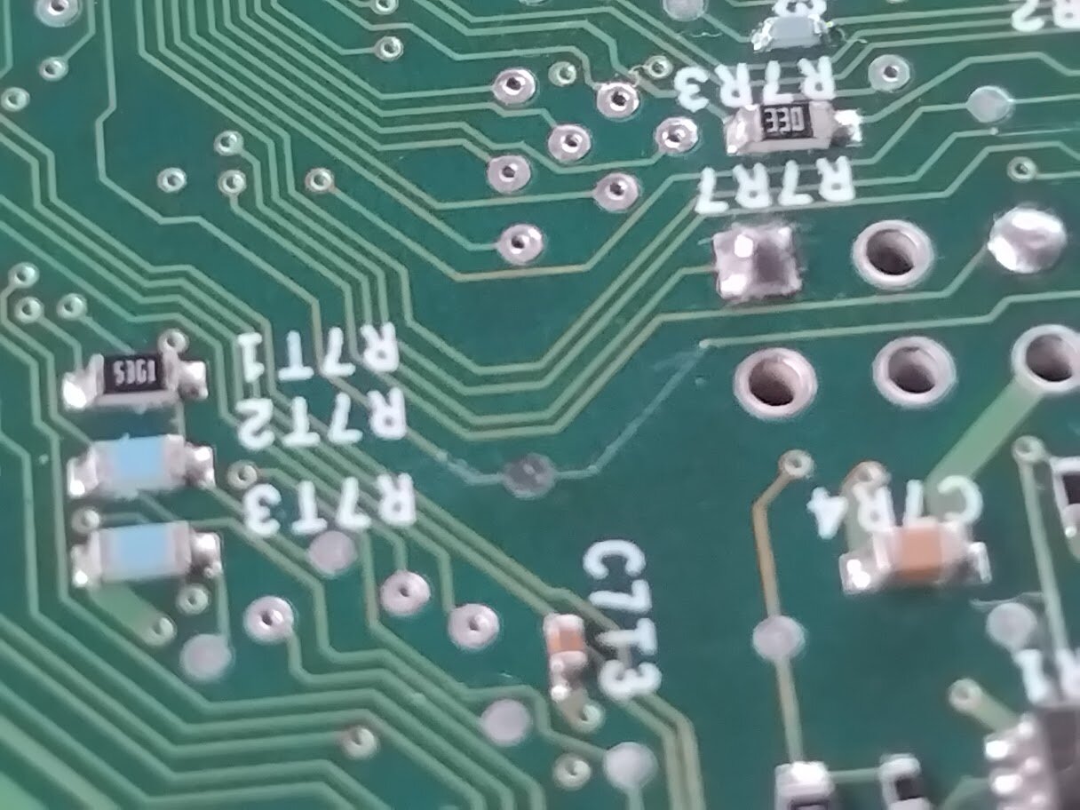

phrunt Posted October 17, 2024 Report Share Posted October 17, 2024 I was FTP'ing stuff to my 1.6, it was going for about 14 hours OK then it locked up, I turned it off and on and it tried to kick in twice by starting to go green then restarting before anything comes on the screen then the third time it started the light flashing from green to red I thought maybe my mod chip was playing up so I desoldered it and tried the Xbox, exact same behaviour, no signal to screen and flashing red and green.. The boards had all new caps only a few months ago. What could it possibly be? I looked at the board under zoom on my phone and can't see any obvious signs or problems anywhere. Quote Link to comment Share on other sites More sharing options...

phrunt Posted October 21, 2024 Author Report Share Posted October 21, 2024 I think I found the cause of my problem. That trace looks like its disappeared. It's a bit beyond me fixing this one, I think. Quote Link to comment Share on other sites More sharing options...
Petrolhead Posted October 21, 2024 Report Share Posted October 21, 2024 Test the trace with a multimeter 1 Quote Link to comment Share on other sites More sharing options...
