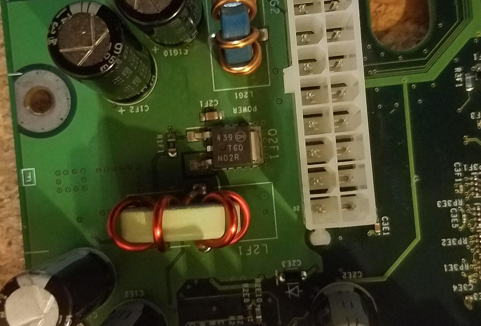

Lina_Inverse_ Posted February 9, 2024 Report Share Posted February 9, 2024 (edited) I have a 1.6 revision board which shut down in the middle of using it. I have tested the PSU which is working correctly (have tried in another system also). I have traced the problem to this MOSFET - Q2F1 not outputting 5V.Can anyone guide me on a replacement? The numbers on it don't give me a good guide on an equivalent/compatible one. Edited February 9, 2024 by Lina_Inverse_ Quote Link to comment Share on other sites More sharing options...
TelaKeppi Posted February 9, 2024 Report Share Posted February 9, 2024 Could be T60N02R, Quote Link to comment Share on other sites More sharing options...
Lina_Inverse_ Posted February 9, 2024 Author Report Share Posted February 9, 2024 11 hours ago, TelaKeppi said: Could be T60N02R, That's it! I made the mistake of searching the numbers along with it. Thanks. Quote Link to comment Share on other sites More sharing options...
FrostyMaGee Posted February 9, 2024 Report Share Posted February 9, 2024 19 minutes ago, Lina_Inverse_ said: That's it! I made the mistake of searching the numbers along with it. Thanks. Were you able to find a suitable replacement mosfet? I may have a 1.6 where this is also the issue but regardless I would like to add it to my list of replacement parts. Quote Link to comment Share on other sites More sharing options...
supasweet Posted May 26 Report Share Posted May 26 On 2/9/2024 at 5:40 PM, FrostyMaGee said: Were you able to find a suitable replacement mosfet? I may have a 1.6 where this is also the issue but regardless I would like to add it to my list of replacement parts. im sure you have tried here this could be a replacement however verify values to be sure STU65N3LLH5 STMicroelectronics | Discrete Semiconductor Products | DigiKey and thank you for the help on my other post! 1 Quote Link to comment Share on other sites More sharing options...
