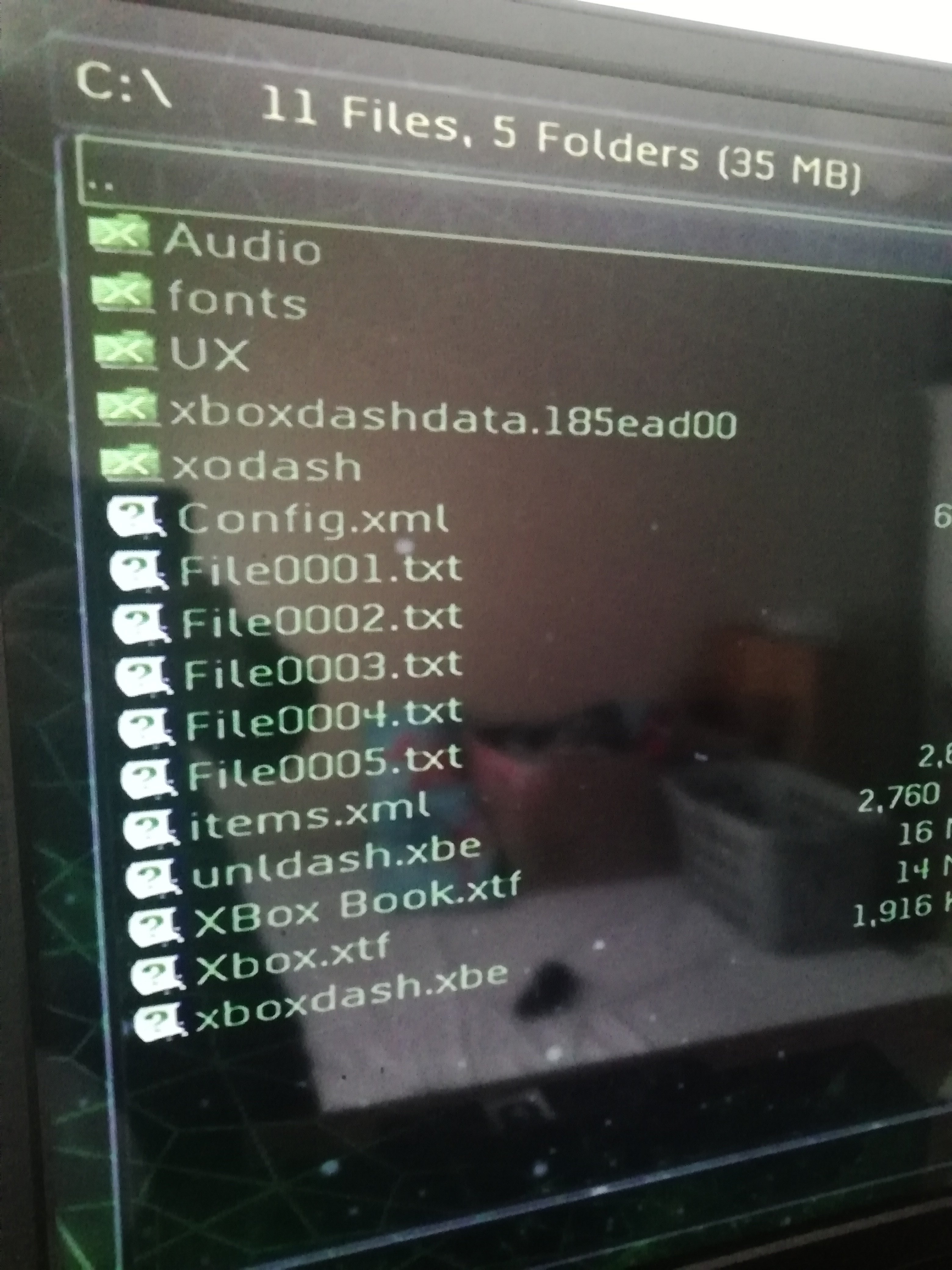

Hi, thank you I just looked through all of c drive and folders and couldn't find it :/ this is the route
3 hours ago, Ging3rguy said:
Using file explorer go into your c partition and load unldash.xbe, if this is your dash just rename this unldash_default.xbe and rename your latest version of unleashx to unldash.xbe and put it in the c partition.
I tried this, it started to load, then showed unleashx as if I did quick report with L,R,Back,Black/White, so I don't know if it booted
31 minutes ago, nikeymikey said:
If you ran that xbe and then unleash loaded then thats your dash. If your unsure you can FTP across the files for a different dash and run that, and then go into file explorer on that dash and run the unldash.xbe  and see if unleash loads. If so that confirms thats your dash and you can go ahead with what @Ging3rguy said above :)
Okay will give that a try, thank you both! So would any dash work with the mod chip? Or am I best just sticking with unleashx like I originally planned, thank you
Depends what you want, if you want to keep it simple then Unleash or Evolution X dashes are fine, Otherwise you can run one of the variations of XBMC as your dash. If you can burn a disc then use Rocky5's softmod extras disc to install the dash you require, if you cant burn discs then ftp the contents of the extras iso to your xbox.
