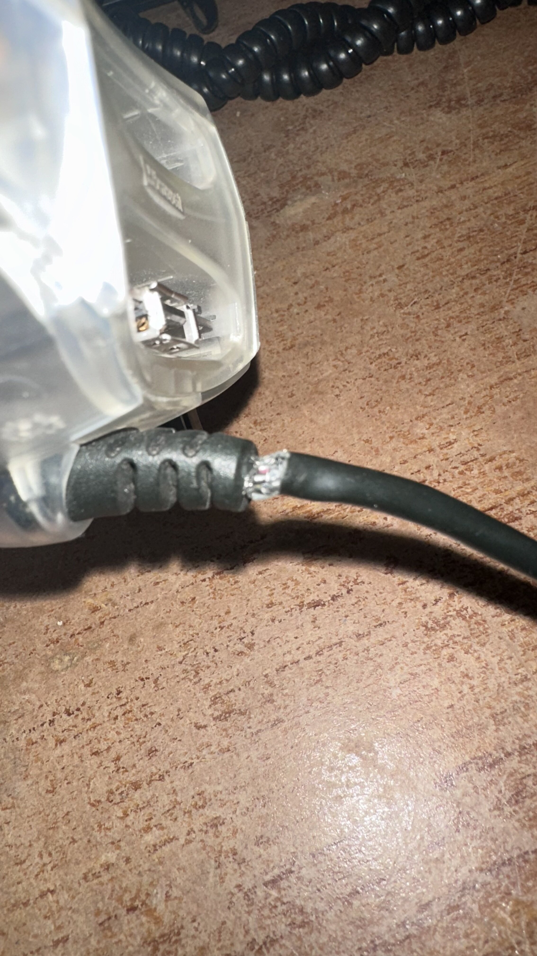

nikeymikey Posted June 3, 2024 Report Share Posted June 3, 2024 As the title says. I have a console that sometime experiences a random power down. I have left the console running for ages on its own and the power down has not happened, then I have been just flicking around in PrometheOS or XBMC4Gamers for a few moments and the console has shut down. This console has been recapped and has no issues booting up at all. However the controller I have been using has a split in the cable right at the top where it joins the cable relief before going into the controller itself. Could this cause a short that causes the console to power down. I am running Cerbios which has a button combo to power down the console and wondered if it could this that is triggering. Pic of cable split for reference... If its not this what else could it be?? I'm stumped lol EDIT - So I have narrowed it down. Its nothing to do with the controller, it only seems to happen with in either the PrometheOS dash OR XBMC4Gamers. It can happen in seconds or it can happen after 15 mins, its totally random. As a test I left the console running with a game playing for 2 hours and no power down. Leaving it on either dash will eventually power down. I have checked and XBMC shutdown timer is OFF. Quote Link to comment Share on other sites More sharing options...
