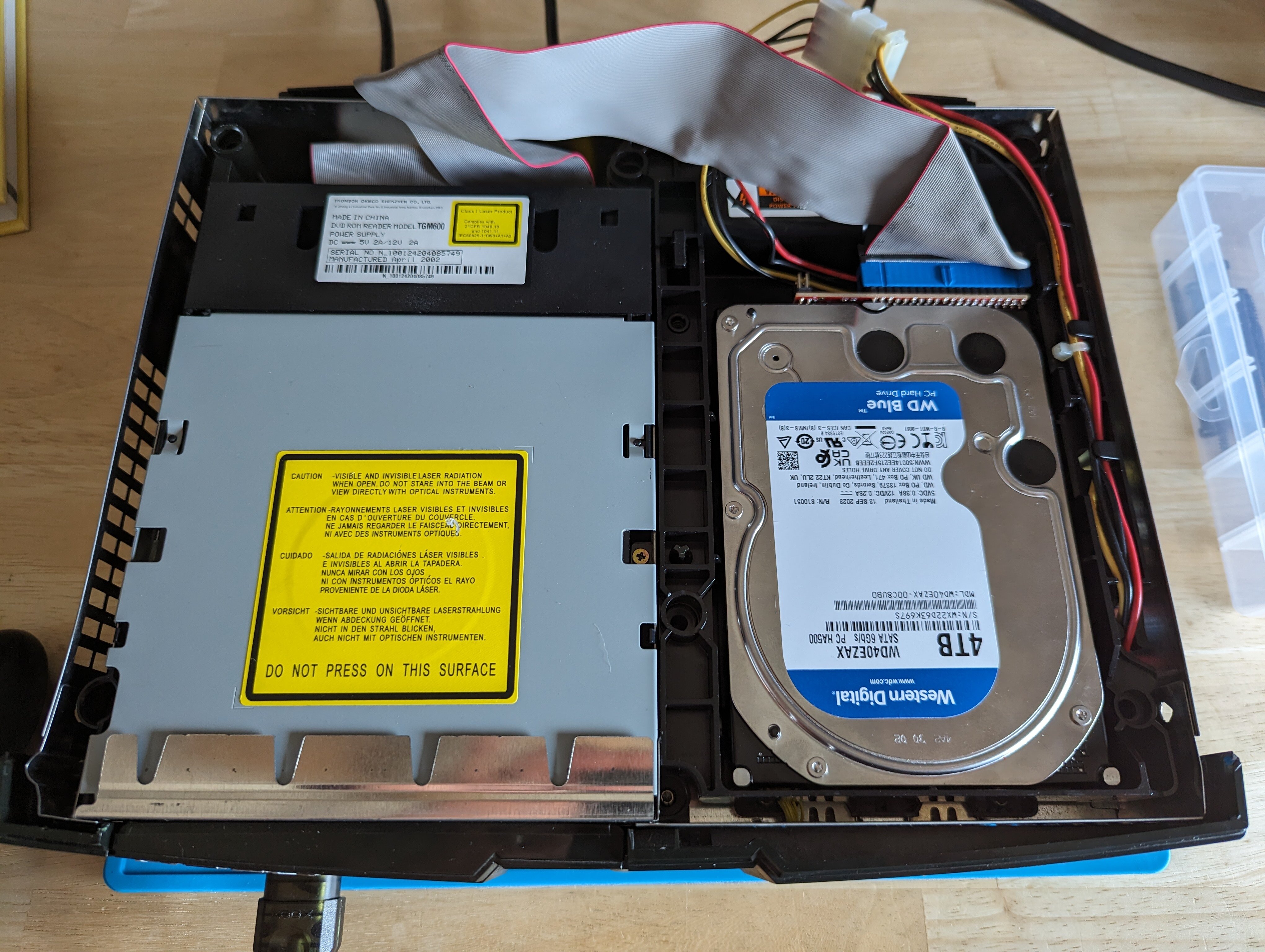

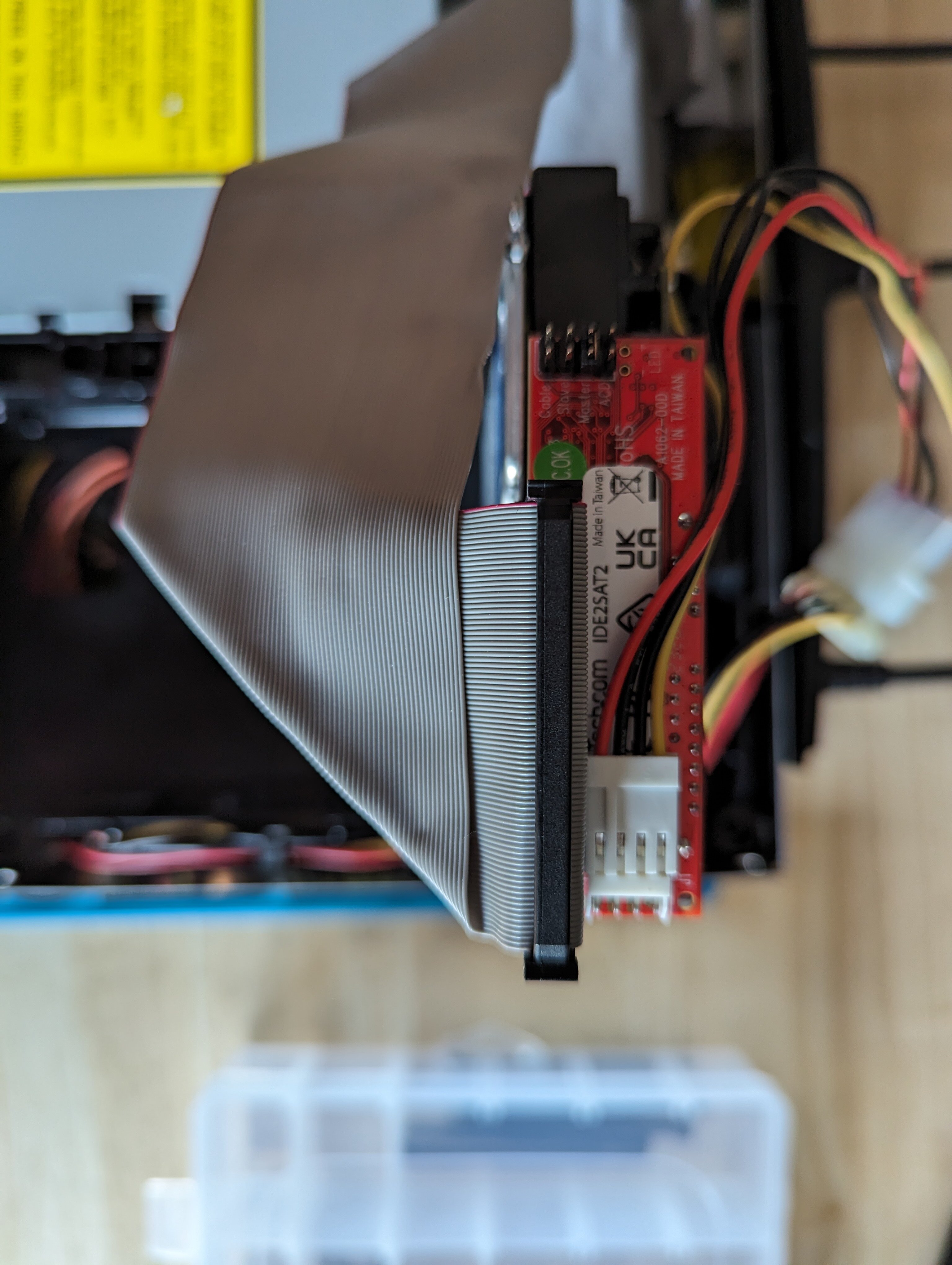

MadMartigan Posted February 2, 2024 Report Share Posted February 2, 2024 Can you take a picture of the adapter and HDD while everything is hooked up please? Quote Link to comment Share on other sites More sharing options...
monkeyjab Posted February 2, 2024 Author Report Share Posted February 2, 2024 23 hours ago, nikeymikey said: If you formatted the drive with FatXplorer it should have selected the correct cluster size for your drive automatically. Mine did for my 6tb drive. I did use that Quote Link to comment Share on other sites More sharing options...
monkeyjab Posted February 2, 2024 Author Report Share Posted February 2, 2024 14 hours ago, MadMartigan said: Can you take a picture of the adapter and HDD while everything is hooked up please? Will do. Give me a bit Quote Link to comment Share on other sites More sharing options...

monkeyjab Posted February 3, 2024 Author Report Share Posted February 3, 2024 Picture of install Quote Link to comment Share on other sites More sharing options...
monkeyjab Posted February 3, 2024 Author Report Share Posted February 3, 2024 View of adapter Quote Link to comment Share on other sites More sharing options...
MadMartigan Posted February 3, 2024 Report Share Posted February 3, 2024 (edited) 13 minutes ago, monkeyjab said: It's was formatted 128. Rebuilt the HDD with 256. That seems to eliminate the issue. I've in game rebooted about 40 times today with one crash. I also have a Thompson drive. That's great! Many times it is the simple things that are overlooked. I'm definitely guilty myself which is why that was my first suggestion. Happy gaming. In addition, sometimes people say they have a startech adapter when they're just mistaking any sata adapter. Wanted to be sure that's what you actually had. Edited February 3, 2024 by MadMartigan Quote Link to comment Share on other sites More sharing options...

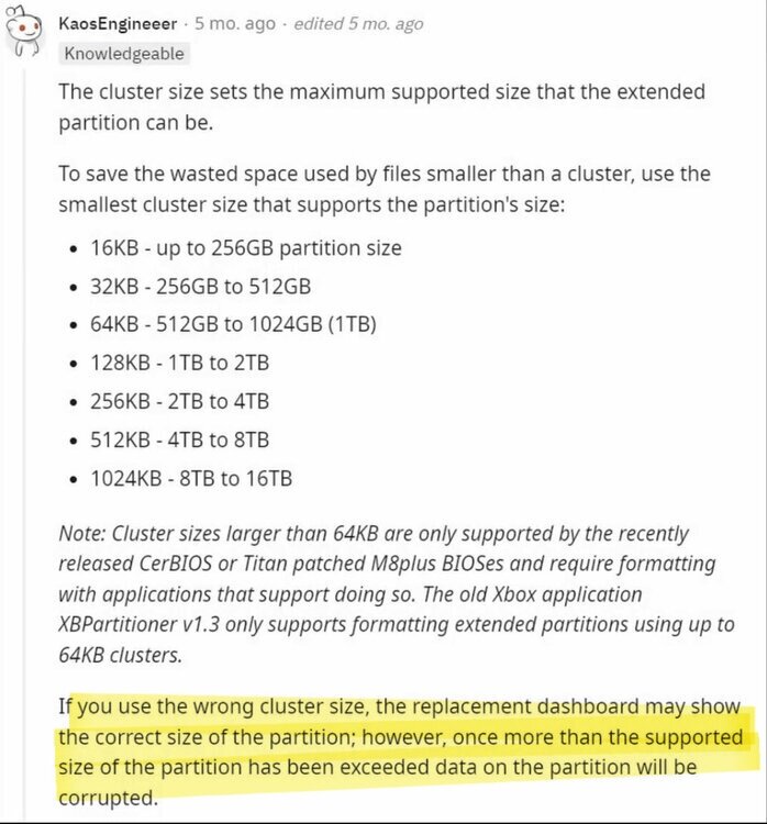

Bowlsnapper Posted February 3, 2024 Report Share Posted February 3, 2024 3 minutes ago, monkeyjab said: Definitely appreciate all the help from everyone. I'm just getting into Xbox modding coming from PS2 and GameCube, so still learning my way. Thanks again But why would cluster size cause crashing like this? Quote Link to comment Share on other sites More sharing options...
MadMartigan Posted February 3, 2024 Report Share Posted February 3, 2024 Coming from the wizard himself 2 Quote Link to comment Share on other sites More sharing options...
