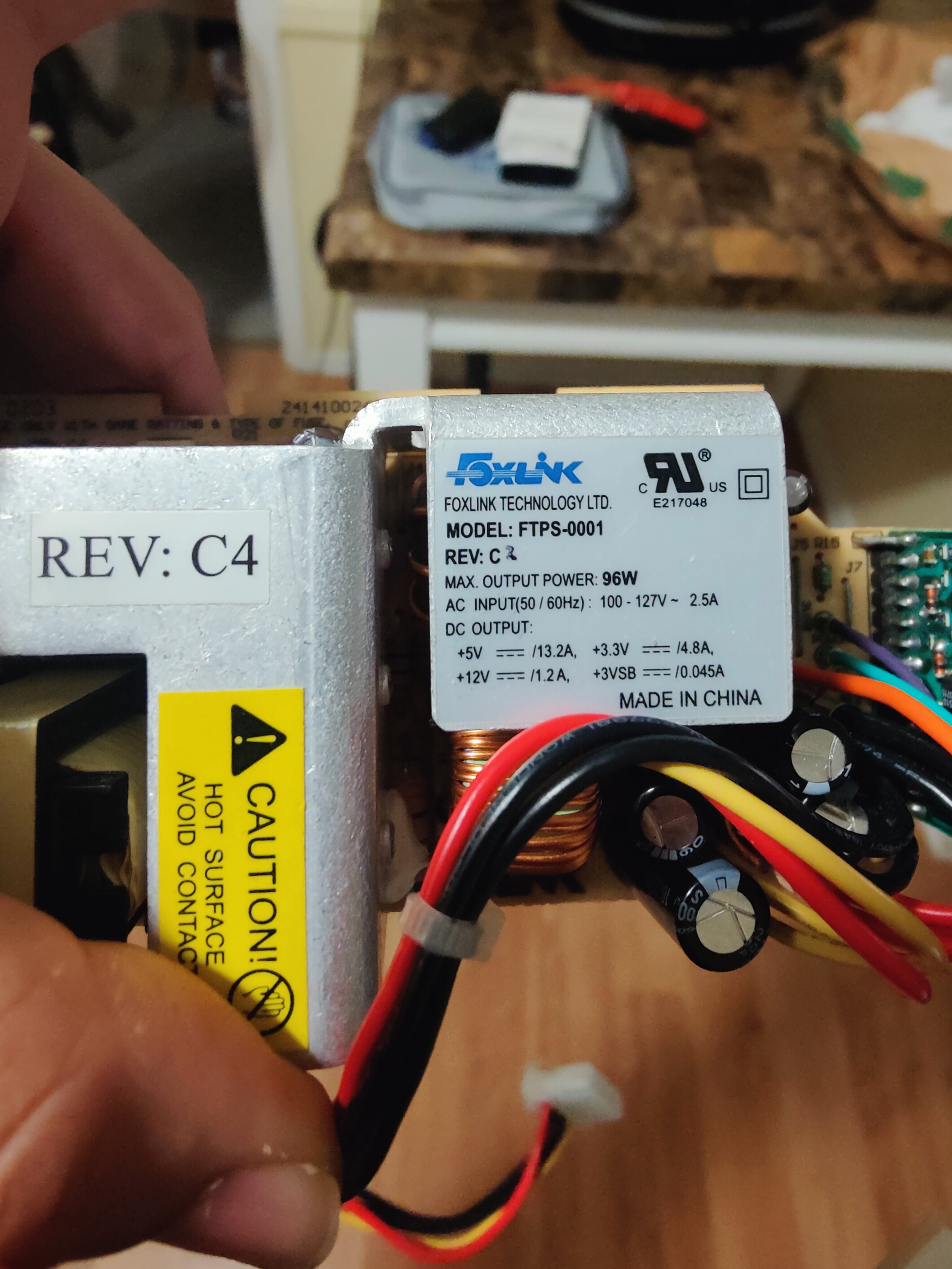

FrostyMaGee Posted Monday at 04:56 PM Report Share Posted Monday at 04:56 PM 24 minutes ago, Bowlsnapper said: I may have one for you. Shall I take a photo? Might as well. I can say this from having looked around to try and find one for @lopenator The deltas don’t seem to have the correct replacement part. Additionally it doesn’t look like all the foxlinks do either. The foxlink rev B might but I’m not sure. The type Lopenator has is a foxlink FTPS-0001 Rev C just in case anyone has that specific model psu. Quote Link to comment Share on other sites More sharing options...

lopenator Posted Monday at 05:29 PM Author Report Share Posted Monday at 05:29 PM Quote Link to comment Share on other sites More sharing options...

FrostyMaGee Posted Monday at 06:01 PM Report Share Posted Monday at 06:01 PM 11 minutes ago, Bowlsnapper said: There HAS to be a way to find a suitable inductor. That’s what I said as well. Lol. I’ve been able to find nothing on it spec wise. There seems to be a dearth of information about the inductors. It has to be out there somewhere. 1 Quote Link to comment Share on other sites More sharing options...
lopenator Posted Monday at 06:02 PM Author Report Share Posted Monday at 06:02 PM if I knew a little bit more about choke inductors I would ask you to take some measurements on yours so I can find a suitable replacement. Quote Link to comment Share on other sites More sharing options...
FrostyMaGee Posted Monday at 06:11 PM Report Share Posted Monday at 06:11 PM (edited) 13 minutes ago, lopenator said: if I knew a little bit more about choke inductors I would ask you to take some measurements on yours so I can find a suitable replacement. That still might help narrow down some replacement parts. Size wise anyway. I don’t recall a ton about them but I think it’s a toroidal transformer. I could be mistaken though. Unsure of the ring configuration other than it’s ferrite/iron coated and wire wrapped obviously. Edited Monday at 06:16 PM by FrostyMaGee Quote Link to comment Share on other sites More sharing options...
lopenator Posted Monday at 06:14 PM Author Report Share Posted Monday at 06:14 PM I gone back and forth between toroidal transformers and choke inductors. it looks like it could be either or. Quote Link to comment Share on other sites More sharing options...
FrostyMaGee Posted Monday at 06:23 PM Report Share Posted Monday at 06:23 PM 6 minutes ago, lopenator said: I gone back and forth between toroidal transformers and choke inductors. it looks like it could be either or. I we could figure out the transformers power rating that would help too. Also if we knew the operating frequency. Did I imagine this or aren’t a lot of these inductors custom made to manufacturer’s specs? Quote Link to comment Share on other sites More sharing options...
