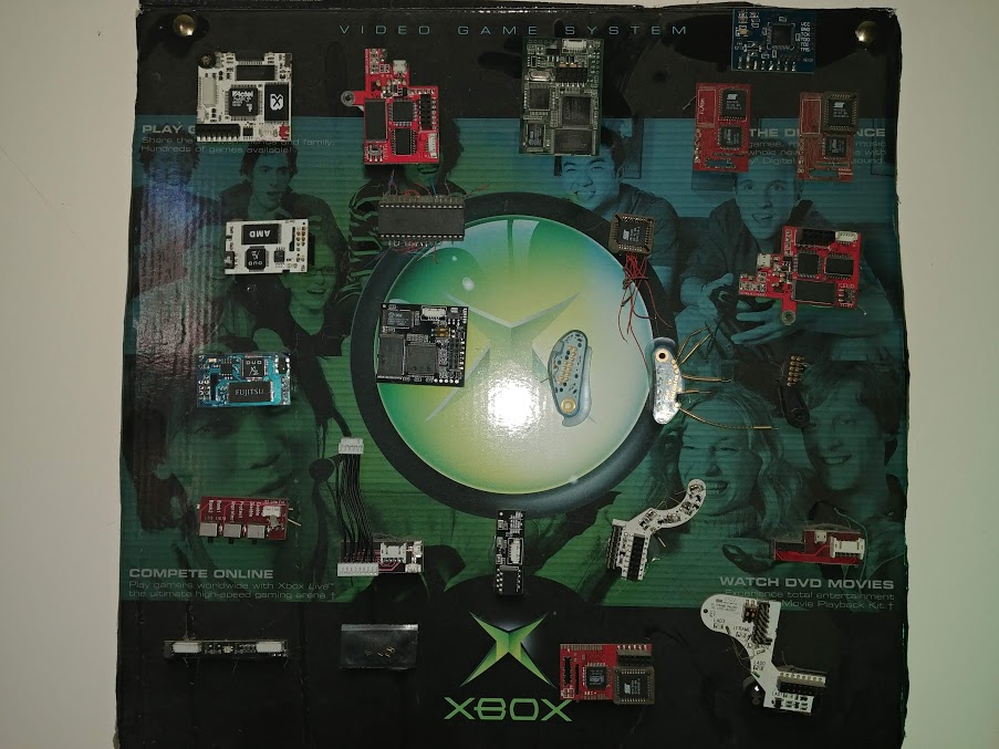

This is a collage I made years ago when I was modding of all the different chips and adapters I pulled out of console when installing new chips. I can give close pics of each one if you wanted. Not sure if this was what you were looking for. As you can see I glued them to the side of a Xbox box.
