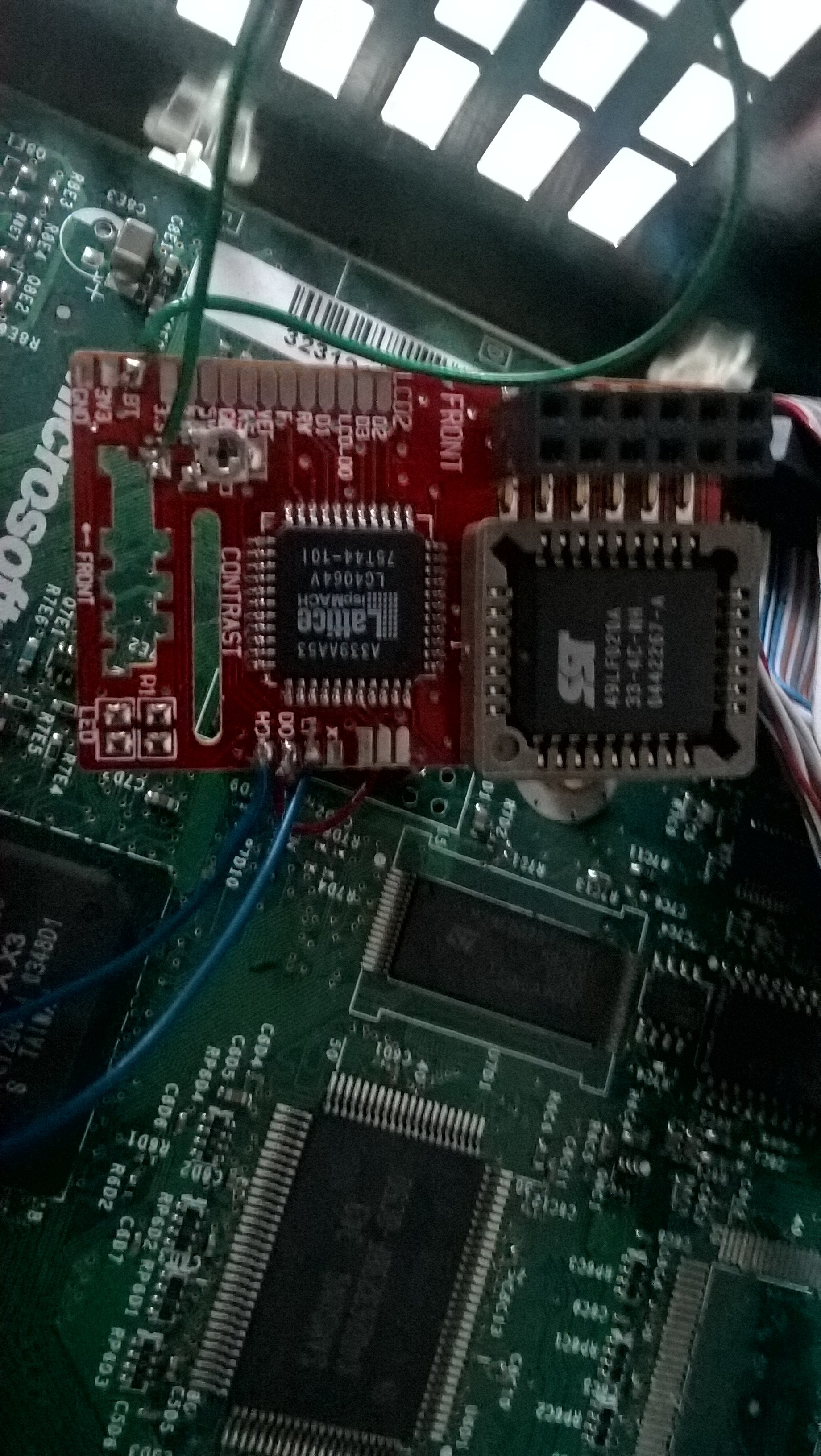

Aladin Lc4064v Lcd Possible?
hi guys;
just opened up a already modded crystal box whit this chip in it.
is this the aladin where lcd screen is supported?
and any suggestionst what lcd screen to look for?
thanks and greetz to al fellow og xbox-ers
