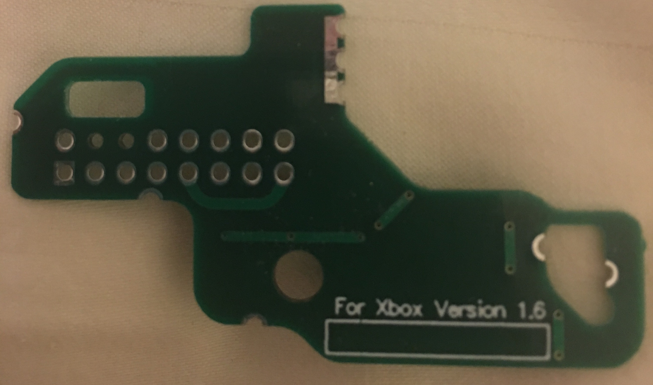

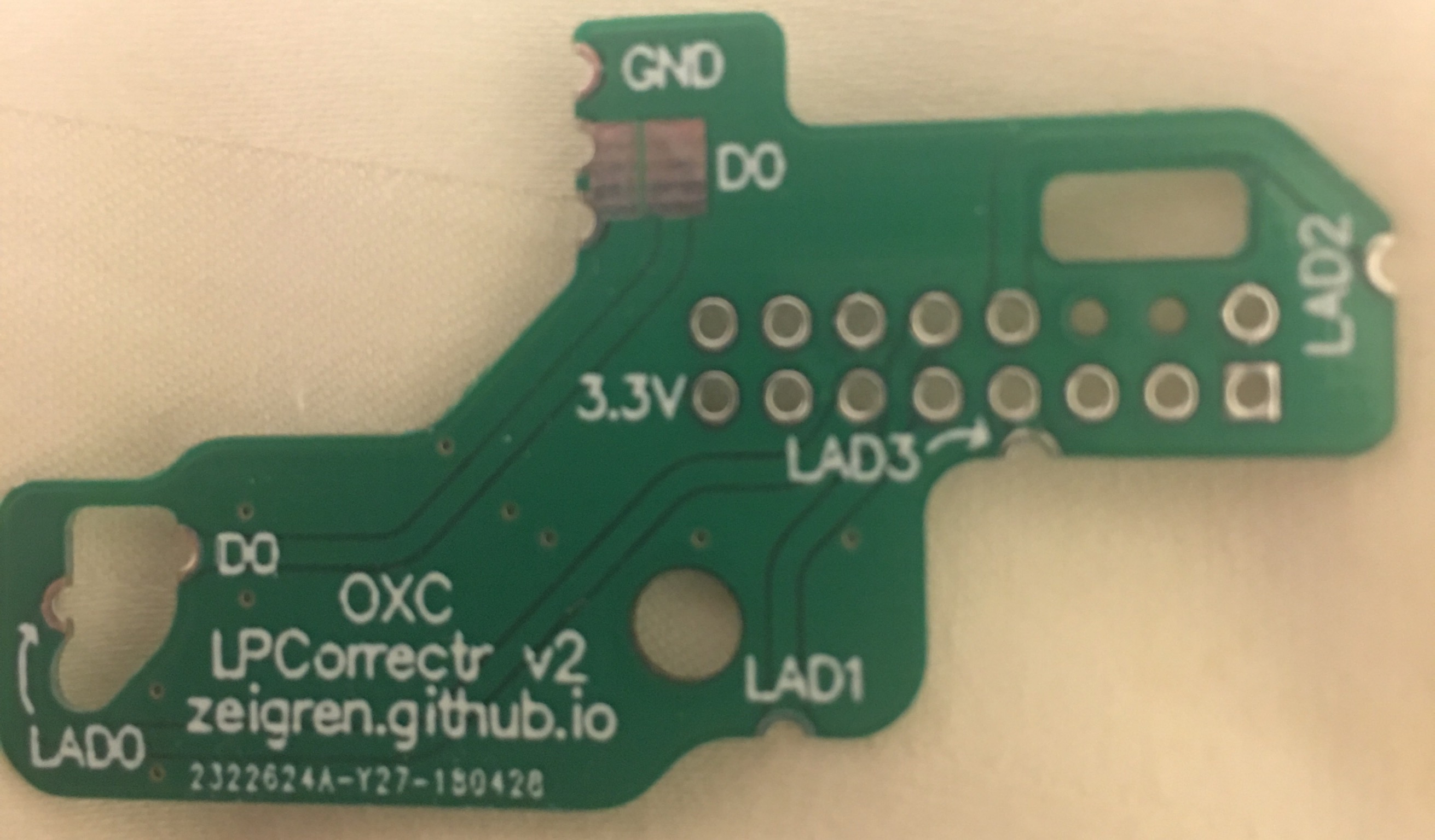

I have a LPC Rebuild Board called the OXC LPCorrectr. I have included the files needed to have it made and it’s completely open sourced. .6 thick

      Just a quick question to throw out to the community. I just did my first 1.6 LPC rebuild using a rebuild PCB. I`ve done many LPC rebuilds the old school way, just running wires to the appropriate points, but I saw these boards, so I grabbed a few to try out.  I have mixed feelings about them. Yes, it was as simple as soldering the connections on the board to the point right next to them, and yes, they do look more professional, but did they save me any time, not really. With all the fiddling around trying to make sure all the points were exactly where they needed to be before tacking them in was a pain, and took way longer than if I had just run wires to where they needed to go.
      What is everyone elses  opinion and experiences with these LPC rebuild boards.
