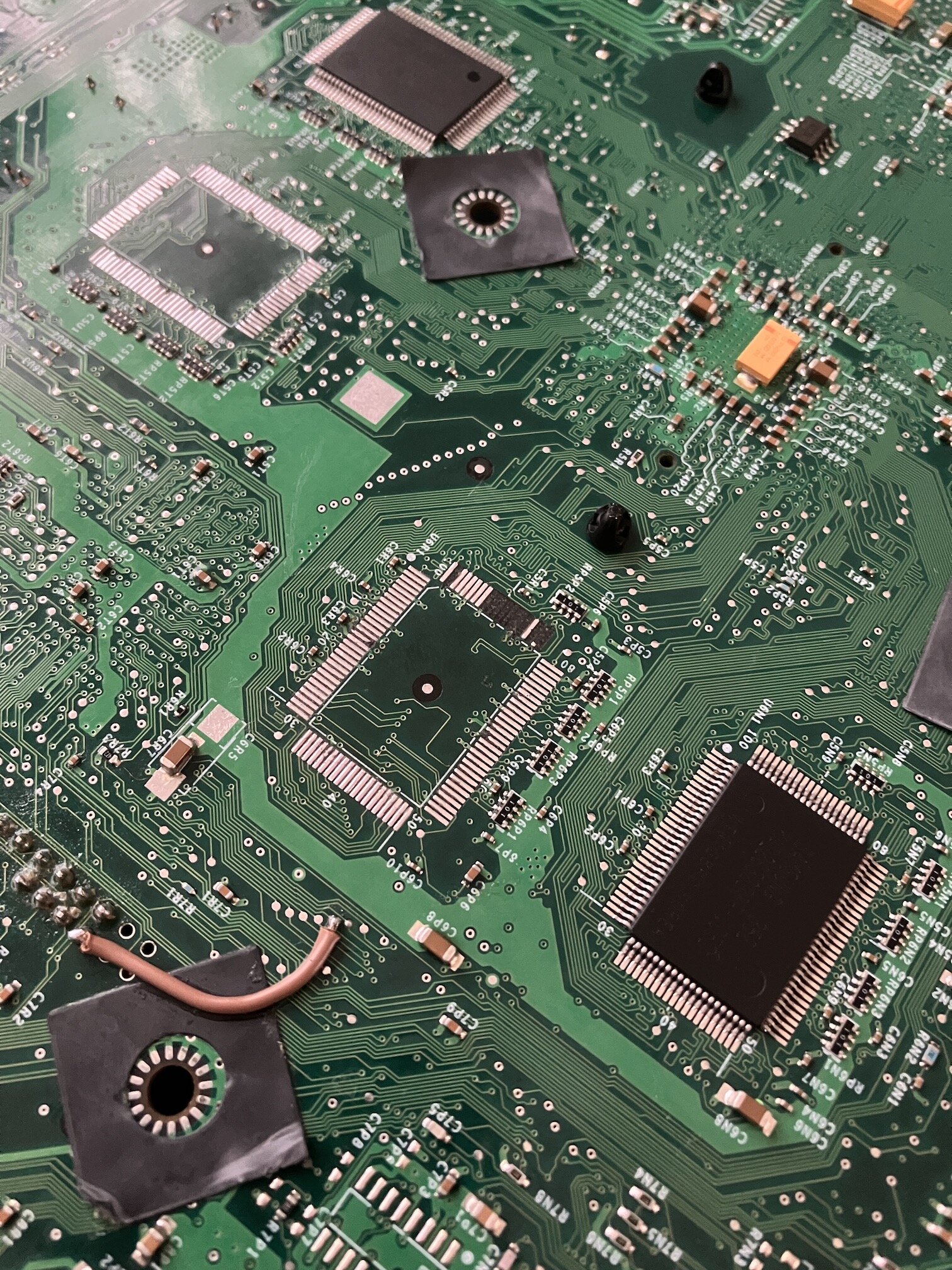

KitMikro Posted November 26, 2024 Report Share Posted November 26, 2024 Hi All, I have a long holiday coming up and to fill the time and challenge my self I bought some broken mainboards from eBay. As you can see from the photo, this boards is butchered! I was wondering if I can use the 1.6 upgrade method to add the missing memory ic? 1 Quote Link to comment Share on other sites More sharing options...
Petrolhead Posted November 26, 2024 Report Share Posted November 26, 2024 Replace trace-plates with thin wire? Quote Link to comment Share on other sites More sharing options...
MadMartigan Posted November 26, 2024 Report Share Posted November 26, 2024 Alternatively, you can repair them properly with rework pads if you're good at soldering. Rework pads You can find much cheaper options elsewhere. The link is for example only. Quote Link to comment Share on other sites More sharing options...
KitMikro Posted November 27, 2024 Author Report Share Posted November 27, 2024 Oh that's something I never knew about. I'll have a look out for rework pads. thanks! Quote Link to comment Share on other sites More sharing options...

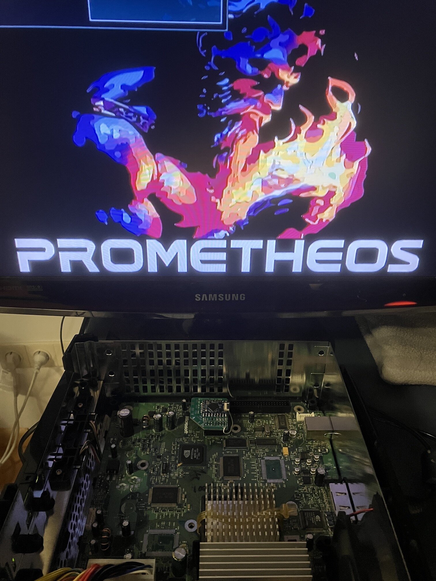

KitMikro Posted November 27, 2024 Author Report Share Posted November 27, 2024 I have started with removing the extra ram chip, and replaced most of the missing capacitors and we have got lift off I was amazed it still booted without all the caps. At least I know the board is still alive. 2 Quote Link to comment Share on other sites More sharing options...
