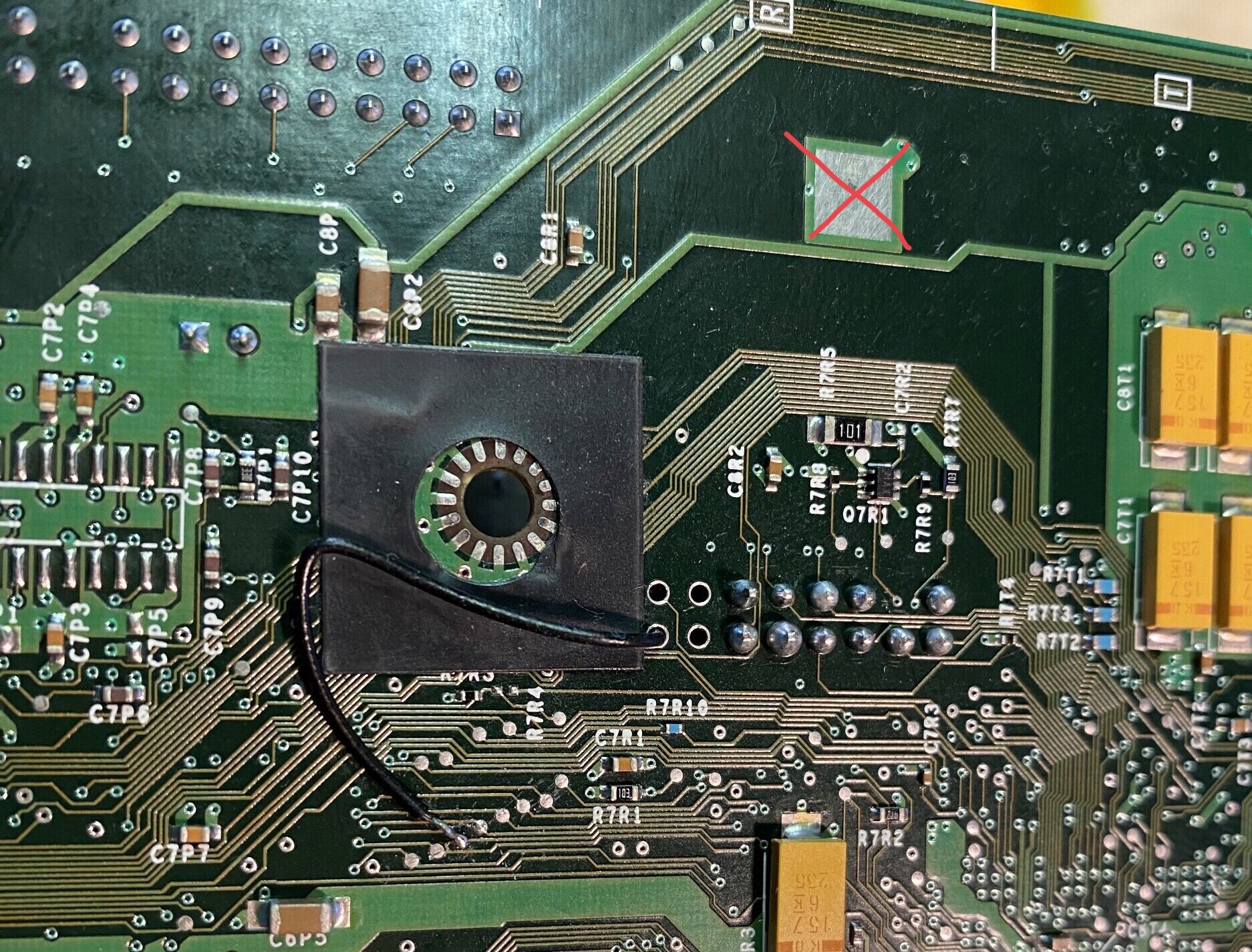

WiZaRd Posted May 1, 2024 Author Report Share Posted May 1, 2024 (edited) ok, after reflowing the header, I power it up and now all I get is green and red ring and no boot. mod is lit red. If I remove the mod I get Factory boot with 05 error. It will not boot at all with mod plugged in. Also, I checked the D0 wire point of solder on bottom of motherboard and it is not a ground. I've attached a pic of bottom D0 solder point. I don't know anything about this mod, but it must have worked at one time as it is. If mod is bad can I just install another? Edited May 1, 2024 by WiZaRd Quote Link to comment Share on other sites More sharing options...

Bowlsnapper Posted May 1, 2024 Report Share Posted May 1, 2024 2 hours ago, WiZaRd said: ok, after reflowing the header, I power it up and now all I get is green and red ring and no boot. mod is lit red. If I remove the mod I get Factory boot with 05 error. It will not boot at all with mod plugged in. Also, I checked the D0 wire point of solder on bottom of motherboard and it is not a ground. I've attached a pic of bottom D0 solder point. I don't know anything about this mod, but it must have worked at one time as it is. If mod is bad can I just install another? Since you are now fragging, I think we can assume that your LPC rework got the chip to be able to trigger D0 through the wire. That's why your TSOP boots when the chip is unsocketed and your dashboard boots with the locking error. You are still unable to boot your modded dash and bios which would bypass a locking error entirely. You are triggering an LPC boot, but your chip is not giving the bios over successfully, so the chip may be defective in some way. The D0 point is not a ground itself. It is a lead to the MCPX for triggering a chip (LPC) boot. IT is grounded in order to force a chip boot. That's why it's going to the Xenium. The chip is grounding the D0 point (pointing to the MCPX) at boot in order to tell the console to boot from it and load a bios through the LPC instead of the onboard flash (TSOP). That's how it works. All chips require this. Shitty chips like the Aladdin do not have a working D0 pad on them which requires you to take that wire and run it from that point on the bottom of the board to aground point anywhere on the console. I use a screwhole ground on the top of the board, but that's just me. If the chip is dead, then you should be able to throw another one on the header, yes. Are you able to boot/power-on with the eject button? That should load XeniumOS. I would assume that a bios was already configured to load based on the fact that the HDD is unlocked and it already had the chip in it, but it's worth a shot. Quote Link to comment Share on other sites More sharing options...

MadMartigan Posted May 5, 2024 Report Share Posted May 5, 2024 I would still try to clean up some of that solder if you have some desoldering braid. There’s just way too much on there. You can also try removing the d0 connection on the chip and grounding it to the pad marked in the picture. Then try to boot with eject. It does seem like the xenium may need reprogramming if you’re 100% sure all the connections are solid. 1 Quote Link to comment Share on other sites More sharing options...
WiZaRd Posted May 6, 2024 Author Report Share Posted May 6, 2024 Ok, I removed D0 wire and grounded it to the pad you marked. it boots to 05 error Quote Link to comment Share on other sites More sharing options...
Bowlsnapper Posted May 6, 2024 Report Share Posted May 6, 2024 1 hour ago, WiZaRd said: Ok, I removed D0 wire and grounded it to the pad you marked. it boots to 05 error .... Which end of the wire? Did you hook up the chip to the pad, or the spot on the motherboard to the pad? Quote Link to comment Share on other sites More sharing options...
MadMartigan Posted May 8, 2024 Report Share Posted May 8, 2024 On 5/6/2024 at 11:13 AM, WiZaRd said: Ok, I removed D0 wire and grounded it to the pad you marked. it boots to 05 error Starting to sound even more like the chip has been fried. Possibly reprogramming it would be the fix. One last ditch effort could be using recovery mode. With any luck, there should be a recovery switch on the chip itself. If so, you can source a Xenium recovery file and burn it to a dvd-r. While the chip is in recovery mode, do a cold boot with the disc inserted. I can provide further details if interested. 1 Quote Link to comment Share on other sites More sharing options...
