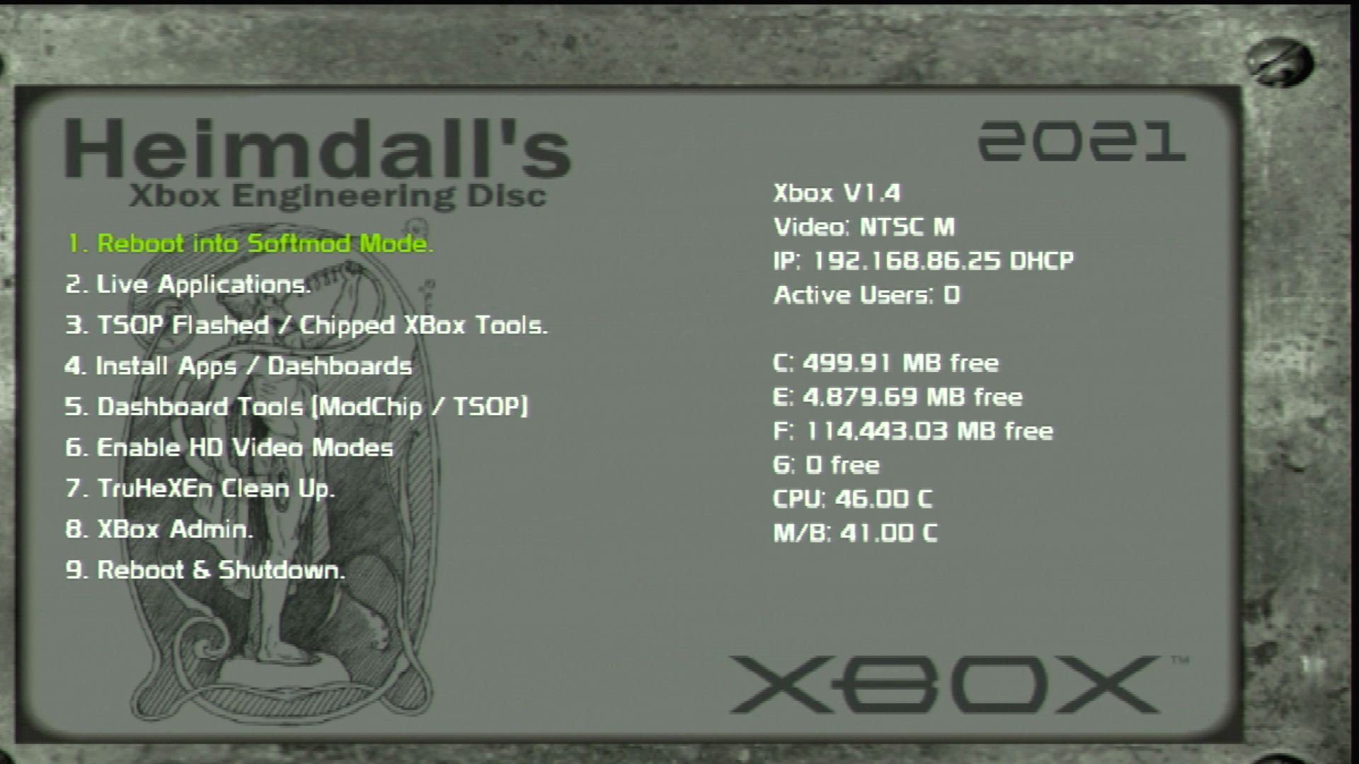

Obviously, I haven't worked with this thing in probably 10 years, so I just don't remember any software/steps I need to install/setup. I burned Heimdal's disc, and it's working fine, but:

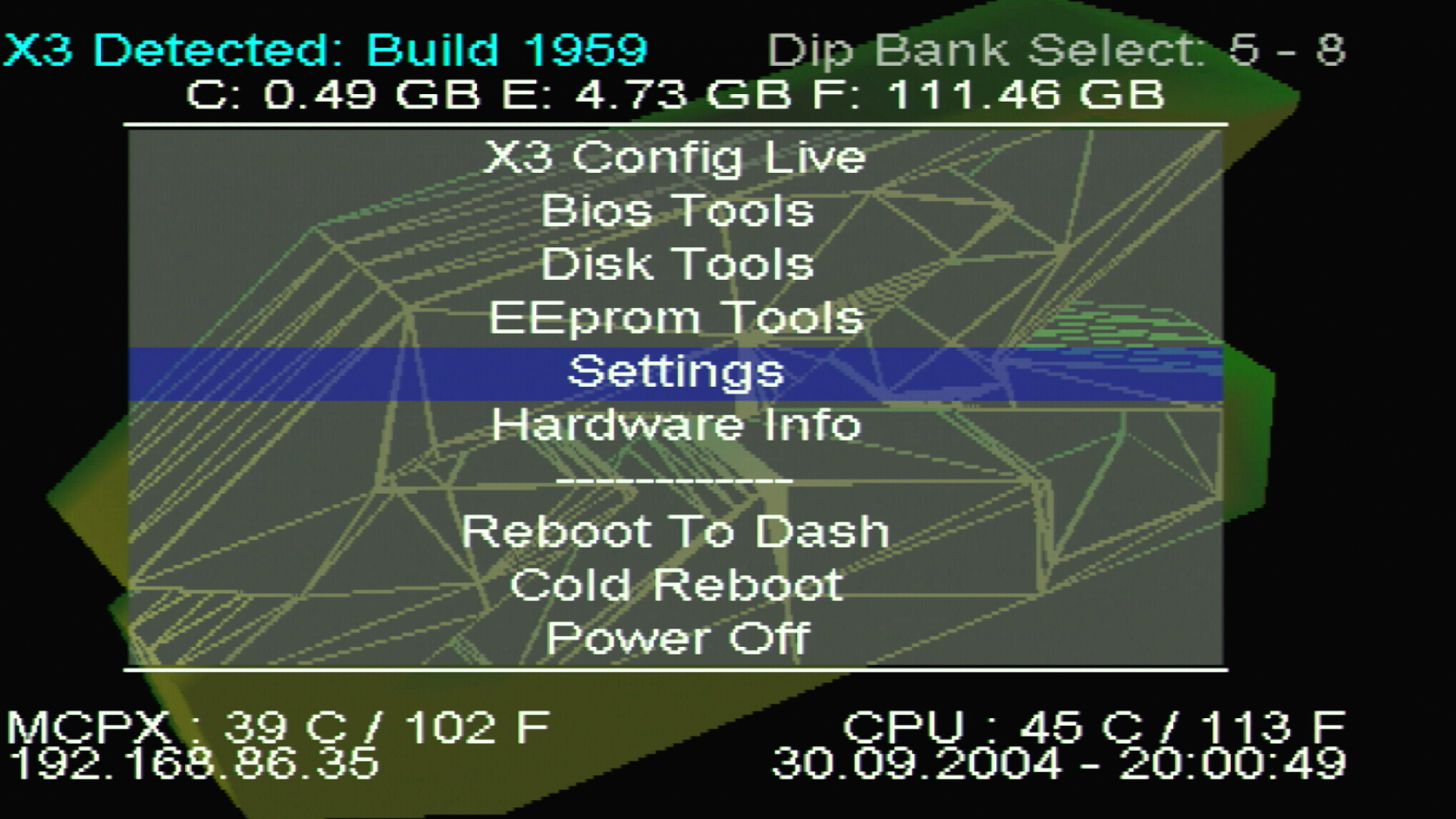

1. I need a new firmware for Xecuter 3, but their site is gone. I assume if I can get the correct file, I can just navigate to the modchip's IP and use the built-in flash utility?

The X3 bios hasn’t changed in years, it’s likely you are using the most recent. If you really want a new up to date modern bios then you should use Cerbios.
Latest release thread here..
https://www.xbox-scene.info/forums/topic/445-cerbios-download-thread/

Also I see you are still using the old Hexen disc. For a much more up to date installer disc go here…

If you grab that installer disc iso I linked to and burn it to a disc you can use it to install XBMC4Gamers and any other apps you need and it should automatically add them to the correct places for you.

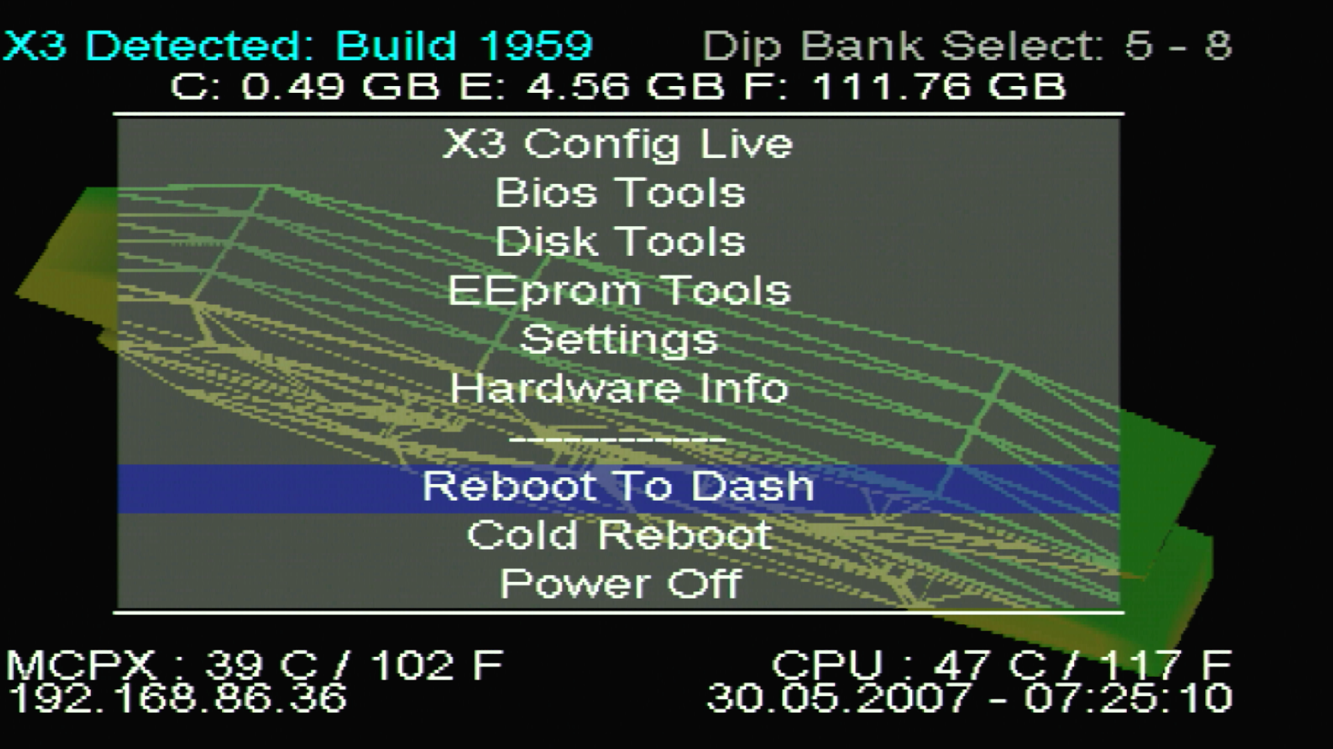

OK, installed from the Cerbios disk, but when I reboot, it's not launching the Dashboard, it's booting to the modchip menu 😕 image.thumb.png.5029d522306e0498e902a13b3b1cec15.png
Ok so X3 Config Live will allow you to tell it where the dash is installed.
Below is a link to the instruction manual for the X3. Click on the X3 Config live option I the screenshot you posted above, then click customise X3 bios and then follow along on the below link. You want the sections starting with Dashboard Boot Priority.
https://x3.bustedchain.com/x3configlive.html
You will need to know where on the HDD the disc installed the dash, use the file manager to find it and make a note of the folder path and which partition it is in. I would expect C or E. These are the details you will be completing in the X3 options.
