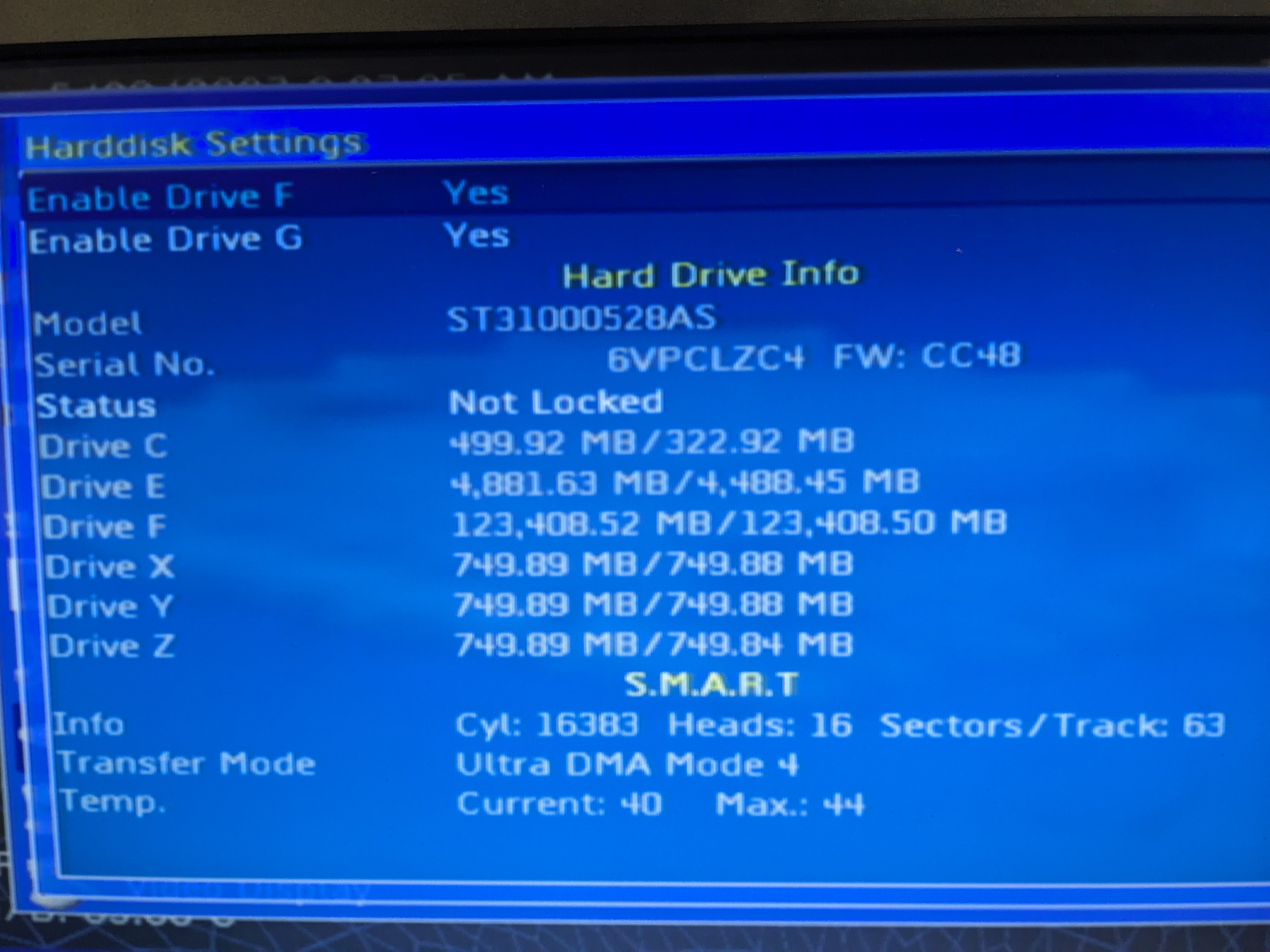

So I'm finally upgrading the HD in my second OGXBOX. After initial issues, I was able to get HeXen2018 to load. I went through the process and chose to have the whole ~1TB for the F. After the process was complete and I booted up into UnleashX I noticed the f drive wasn't showing the full space. In fact it's a hell of a lot smaller than expected. Instead of the ~1TB it's showing 123,408.52 MB for the F. I attached a picture below. Thoughts? FYI it's hard modded with a Xenium ICE.

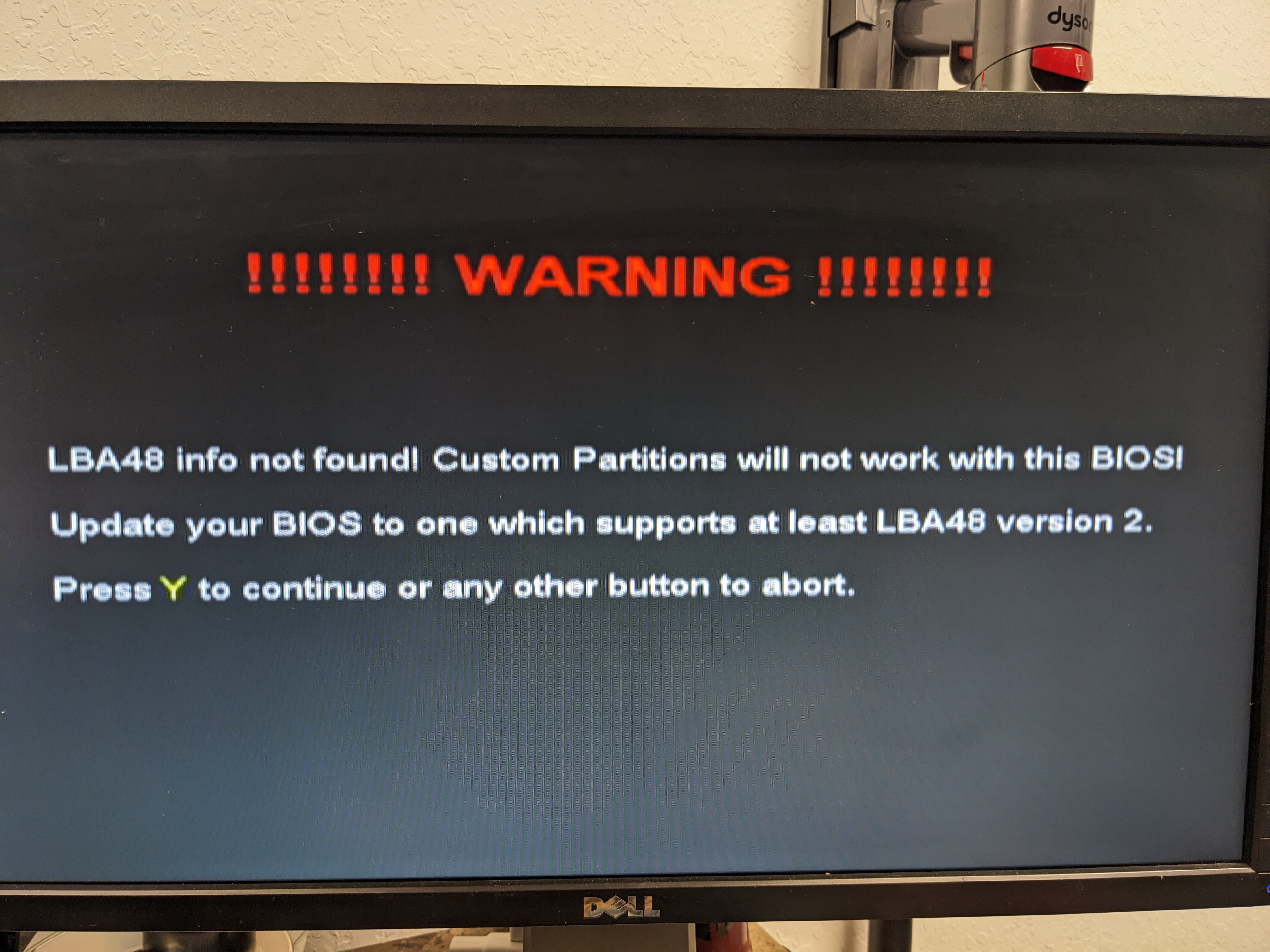

Does your bios have LBA48 support? I would format the hdd in FatXplorer and see what happens after that.
From his post on a related thread he’s got an ER on that partition. My guess is that somehow it used the wrong cluster size or something else went slightly awry in the process. Happens sometimes at random. It’s happened to me enough that I check partitions in xbpartitioner every time before I start copying data. Lol
So funny you mentioned that. I don't know what I was doing but I came across the below error. Not sure how to update the BIOS. I didn't see anything on the HeXen CD.
Okay I also noticed the cluster size. I believe when I was originally setting up I saw 16KB and then the second time around I saw 64KB.
