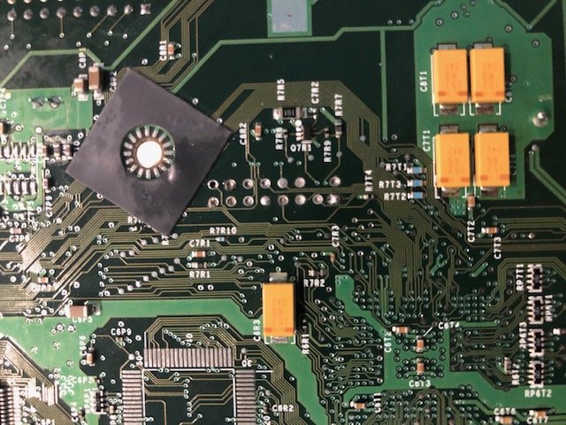

3 hours ago, Eridyne said:
I meant to fix them up nicely the first time I started this whole thing, then life happened and they ended up stuffed in a box and hauled around for a while...
I wasn't sure if the clock cap was also intended as a decoupling cap for a nearby chip, but if it removal hasn't been shown to cause any harm... it's probably okay-ish. I don't think mine have seen power in as long as the whole time they've been stored, either.
Oh, true! Big drives are definitely way cheaper (and bigger), and midsize SSDs are pretty affordable, which is tentatively the plan. I don't need to keep a whole archival library on it, just my own personal (very modest) collection, and I've no intention of using it for storing media or running emulators. I was considering TSOP flashing too, as a backup for the chip since the 2.6's don't have an integrated recovery mechanism, but I dunno. Kinda wish I could've gotten the 3.0 instead of the 2.6 for that.
Don’t bother with ssds for speed as you will not get the benefit, they are a good idea if you plan on making an ultra slim because of the size.
plenty of xeniums available due to the open source version, x3s come up for sale on eBay regularly.
If you can load hexen use the file explorer option to check you have evoxdash.xbe on C. You could always install unleashx as your dash and that should at least get you up and running. Just don’t reformat anything or you will lose all your games.

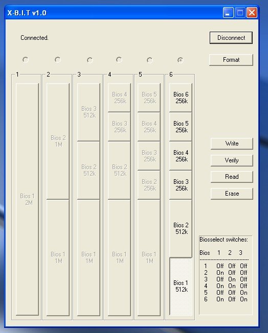

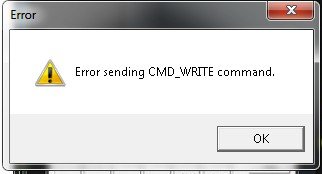

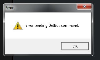

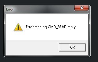

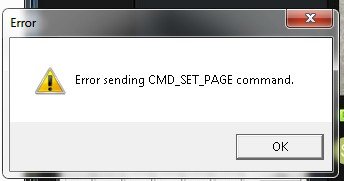

XBit 1.5 Chip Help/Info
in Modchips
Posted
you need windows xp or older, like I said in my earlier post I spent hours trying to flash it using vista in compatibility mode with no joy. I had no problem from the xp desktop I was given this year.
