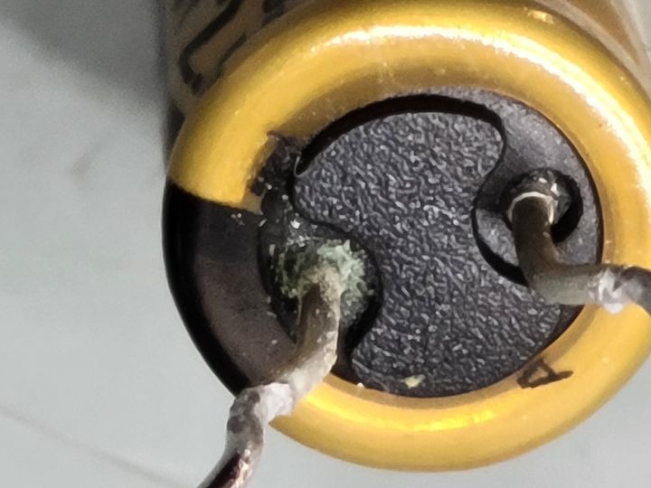

You can open the Xbox very clean, when you take some time. The serial number label is no issue, the other label is a security seal, but also with some time you can extract the part to recover the screw hole as clean as possible. The previous owner of mine has chosen the quick way and screwed down through the labels. Don`t like that.
And you have to open it, because there is a risk the caps around the CPU are blown and the clock cap is leaking. Doing nothing will result in an non working Xbox with trace rot and a hell of a job to repair. So open it, replace leaking caps, clean everything and enjoy the console,

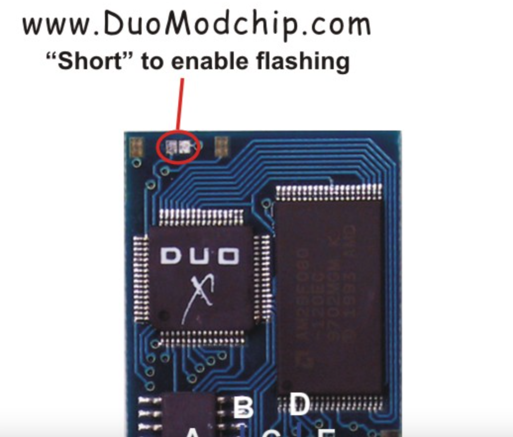

12 hours ago, Bgsmods59 said:
It's not swollen. It's the light and a bit of junk sticking on it. It's not an Duo X2 and therefore there is no bank selector if I remember correct. The layout of that part is also different.
When do this manually I discovered several times that is doesn`t work. Use the EEPROM. Use the altered eeprom.bin file to lock the drive and don`t do this manually. I tried it a few times and it gave me headaches. After using the eeprom.bin for locking and unlocking with xboxHDM all the trouble was solved.
On 7/20/2023 at 1:04 AM, SS_Dave said:
At this moment I remove the clock cap from 1.6 boards (as they indeed commonly are leaking, hidden under the legs) and replace them with a new super condensator (which the clock cap is). So it will be good again for 10+ years. Using a 220ohm resistor is also an idea. Will keep that one in mind. Besides of that I'm checking my consoles internals every 3 to 4 years.

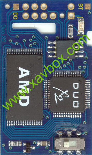

Hi,
I've found a Xbox with a Duo-X modchip installed. When booting it says Executer2 with the blue logo. It doesn`t recognize all the partitions on my 500GB S-ATA harddrive, so I would like to flash the BIOS.I tried flashing through the EvoX dashboard and also with Xblast OS, but both aren`t working (I tried Cerbios and M8plus). Normally I can flash almost everything through Xblast. In the EvoX dashboard it says the Flash isn`t writeable (Manufacturers ID 09, Device ID 00). I can`t find anything regarding write protection. From the info the current kernel version is 1.00.4979.67
Change the drive belt. When it's worn out, it wouldn`t close the drive far enough, which causes to eject it. Sometimes it could also be caused by a lot of junk inside the drive.

On 6/9/2023 at 5:00 PM, Bowlsnapper said:
This is what I was wondering. Thank you for the confirmation. What is the value of the capacitor?
I've missed that question, but I bought a 2.5v 1F super condensator in this case from Eaton.

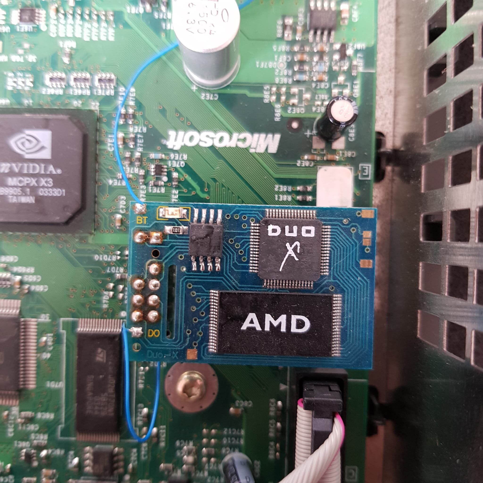

Well, when I use the D0 to ground instead of the one on the Aladdin chip, it frags again.
And modzville does not sent to the Netherlands and when they do the shipping costs are more than the chip. A lot of chips you can buy in the Netherlands are also from Ali Express so that wouldn`t solve anything at this moment.
Well finally back from work, so I re-flowed all the pins of the LPC pinheader, also made the exposed wire thing better. But still fraging, with or without the BT wire.
So, I have a working 1.6 xbox which has an Executer2 chip in it. Replaced that chip with the Aladdin and also that one starts fraging. Solder the wires back to the Executer2 chip and the Xbox is booting again. Placing the Aladdin back in my (I believe 1.4 xbox) and it's also fraging.
Now I used the D0 on the Aladdin chip and no BT connection. The Xbox boots without an issue, but the chip had a led burning, but does nothing.
But it would be strange that all the chips I have should be bad, but I`m out of options at this moment. -
18 hours ago, MadMartigan said:
The chances of the chip being bad are slim and it’s a good sign that the LED works on the chip. Those connections don’t look good at all. As @Bowlsnapper has suggested, it’s highly recommended to use some flux and add just a tiny amount of solder to each connection of the LPC. I recommend doing the opposite to the D0. The solder is a bit globby and a little too much exposed wire. Not entirely sure what gauge wire you’re using, but the smaller the better in that case. Around 30g or smaller makes for an easier connection. Flux can be your best friend on all connections. Take your time!
I used flux, but maybe a bit to much solder on the LPC, because it didn`t work and solder was hard to see. I use 30awg wire. I can remove all the solder and do it again with a tiny amount / small blobs. The wire has multiple small strings in it, instead of solid core, which seems very hard to find here.

I've tried to make a good photo with the magnifier from the LPC header, ignore the wormy stuff, that's from a cotton swap and I didn`t blow of before taking the photo. Do you mean the top left and the one besided the empty slot that aren`t good? -
29 minutes ago, sweetdarkdestiny said:
As long as you have D0 connectet to ground your xbox will still frag. Reason for that is that, when you link D0 ground the XBox tries to boot from the LPC no matter what.
And watching at the pics make me shiver. The cable on the D0 pad could sort to the near by pads, way to much exposed wire there. And 2 pins on the header seems not soldered very well. They maybe make didn't good contact.
Okay, that D0 remark is a good one. I've used my multi-meter to check for shorts and there isn`t one. You are correct that the part exposed wire could be a bit shorter, but as long there is no shorting I think it will be fine (it's an ecstatic thing and I've some electrical tape under it, when it works I can make it cleaner). Under the magnifier all the LPC pins looks good on solder, but that's why I would be helped by points on the board to measure between with the LPC pins to verify it.
