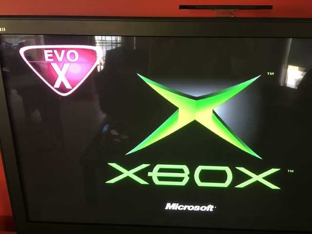

Recently purchased a Xbox pre modded. I thought it was soft modded but upon Futher reading it was hardmodded due to this appearing when booting the console.
I stupidly yesterday tried to FTP rocky5s softmod upgrade thinking my console was softmodded. I'm unsure if it's a TSOP flash or a mod chop waiting for screw drivers to arrive from eBay now.
If it was TSOP flashed is there anything I can do as after running the softmod upgrade from jrocky5 the console won't power on or make a sound to even power on. Nothing happens
