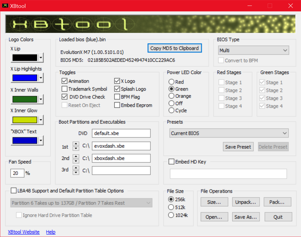

    Lots of info lost on how they modified the older BIOSes.  The oldest EVTool that Xbins FTP server has is v1.0
    Missing are 0.8.0.b1 and 0.7.0.b1 (thanks @SS_Dave for it. Do you happen to have the 0.8.0.b1 version?)
    On nghtshd's - the dev of XBTool and EVTool - old web site, the History of EVTool shows all the diffs between the versions.
    Older versions up to v1.0.7 are for M8 or M8_16.  No EVTool tool for M7.  Not sure how these were patched other than hex editing.
    v1.0.8 and v1.0.9 are for Evox M8+ (1.6 and 1.0-1.5 versions) and metoo BFM versions
    (http://web.archive.org/web/20041111034638/http://home.alltel.net/nghtshd/evtool.html)
    Hey KaosEngineer. So it doesn't seem that Evtool will work, but I did manage to get it to populate the fields in XBTool 1.0.23a. Looks as though the boot order is evoxdash.xbe, and then xboxdash.xbe.

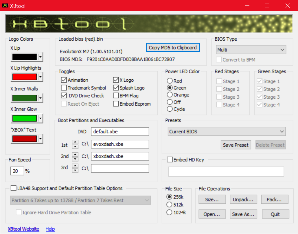

  2. 3 minutes ago, KaosEngineer said:
    It has an ALX2+ rev 4 modchip installed.  Currently boots the ALX2+ (kernel version 1.00.5101.01) blue BIOS in the 256KB user flashable BIOS bank or the Red colored version stored in a non-writeable 256KB section.  The devs of the modchip say it's a ROM but the flash memory chip they use is a 49LV400BC-90 chip. A 512K x 8 bit flash memory chip (or 256K x 16 bit accessible with a BYTE# control line).
    I believe their CPLD's logic code prevents one half of the flash memory chip from being writeable not a separate ROM chip on the modchip.  However, there are 3 chips and I cannot make out the labeling on the CPLD Xilinx 95?? chip or the other part - .
    These images are hopefully easier to read for the ALX2+ rev4. This one from a Reddit post, and the image on this page, though it's labelled as a different modchip, but looks the exact same.

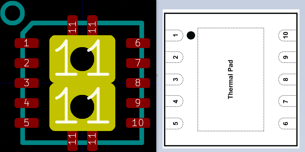

  8. 7 hours ago, ttsgeb said:
    I just threw together revision 2, and still have the issue with the 5v line not producing any voltage.  I'm not entirely sure what's going on, and I've been struggling to find the motivation to work on this project for a while.  I also learned that I chose the transistors for controlling the power poorly, and picked new ones out that were supposed to be the same footprint, but they turned out to be about 30% larger, which makes them completely unworkable on this board. I'll have to look more into what happened there and apparently work on my datasheet reading skills.
    I will see if I can create a design too, as I have a few xbox motherboards that need power supplies and I'd rather not buy a bunch of old psu's for them.
    Reading datasheets can be tough sometimes, and we all make mistakes so no worries. Hopefully though, you gain valuable skills from this project. And good luck with trying to figure out the issue(s).
    DobaMuffin
  9. 5 hours ago, ttsgeb said:
    I found the problem: I made the footprint wrong.  Good thing boards are cheap these days.
    Lol. It's always something simple. Glad you could figure out the issue. Hopefully it's the only issue there was.
