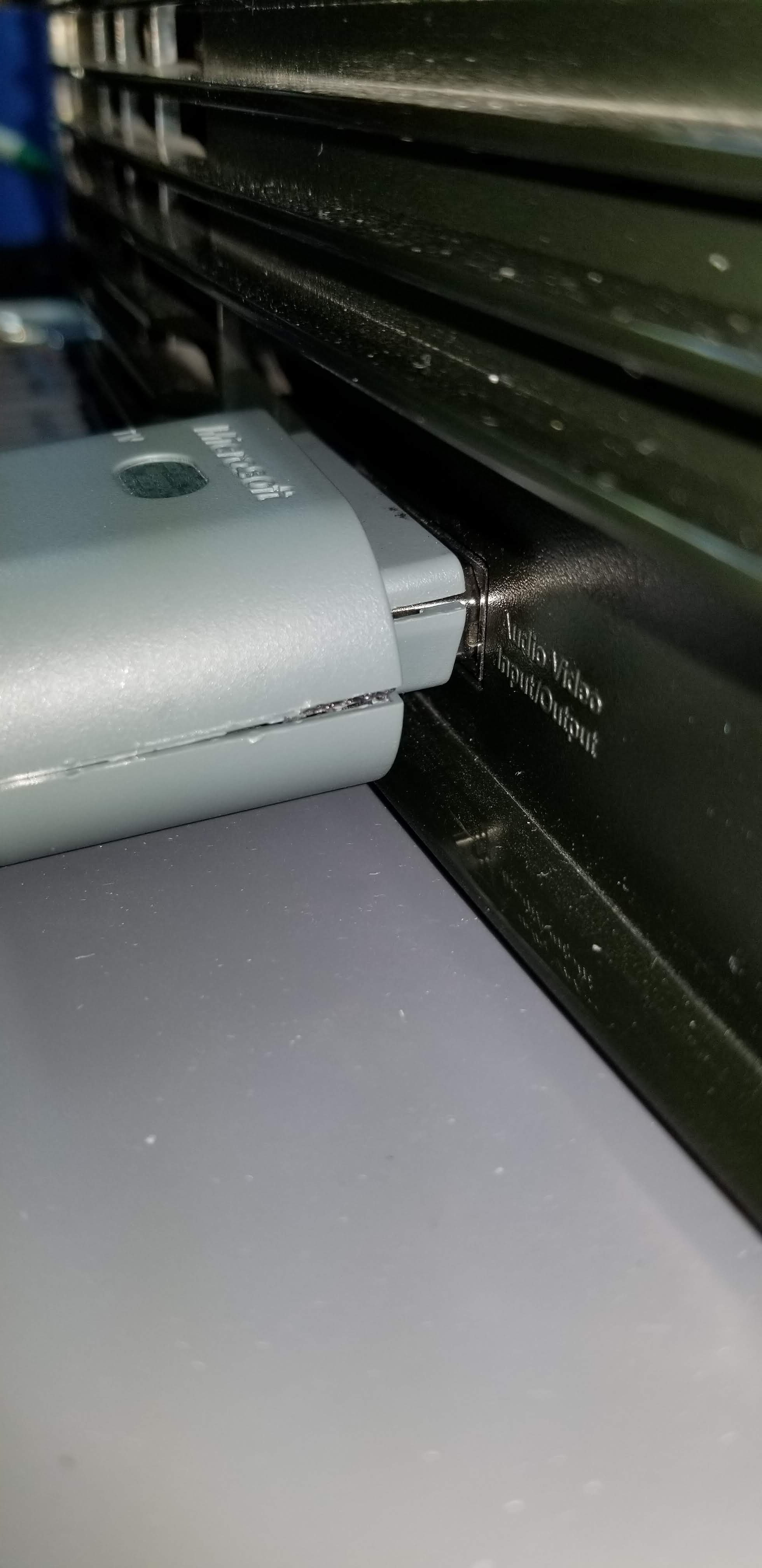

It wasn't easy, because this was the version of the cable with the filter at the beginning of the cable. It makes it super hard to work, I had to even trim the OG Xbox "neck" plastic a little, so it could give me enough room to work.
Also I don't know if it's the version of the componente cable, but the OG Xbox plastic case hardly slide through, this compnent cable is very thick.

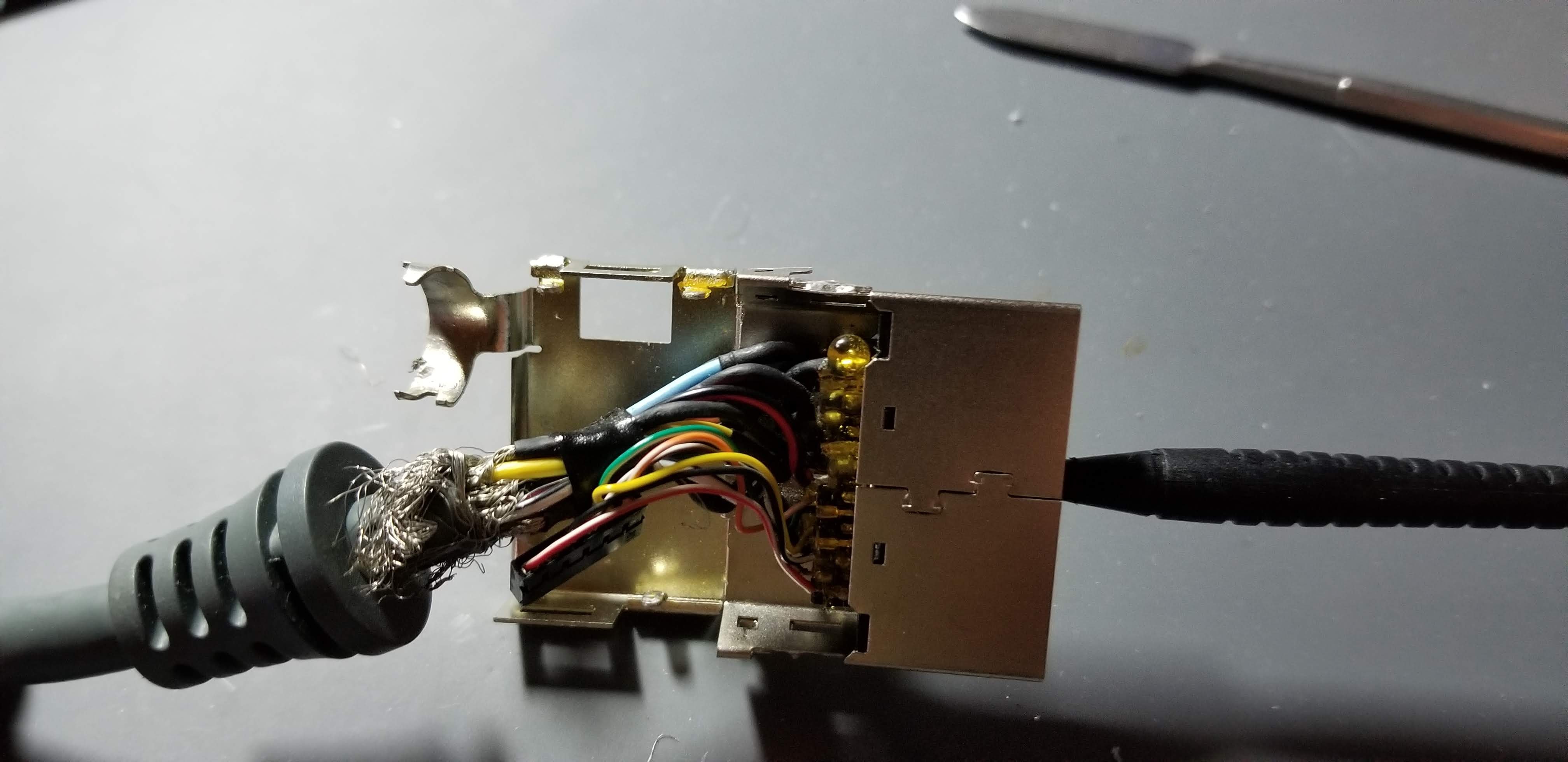

Personally I like to unsolder the 360 wires instead of cutting them so I don't have to mess with the shield braid.
You may have to add some "Fresh" solder to get them to flow better.

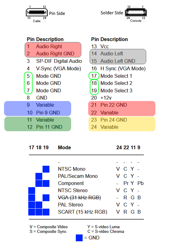

I have found some variations in the 360 cables where the wires for the optical audio is either Black/Brown/Red or Blue/Yellow/Green
Red/Blue go to VCC
Black/Green go to Digital Audio
Yellow/Black go to groundThe Black/Brown/Red combination seemed to be more common in my neighborhood.

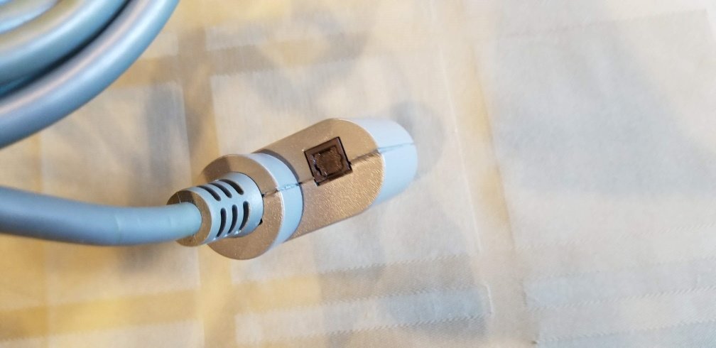

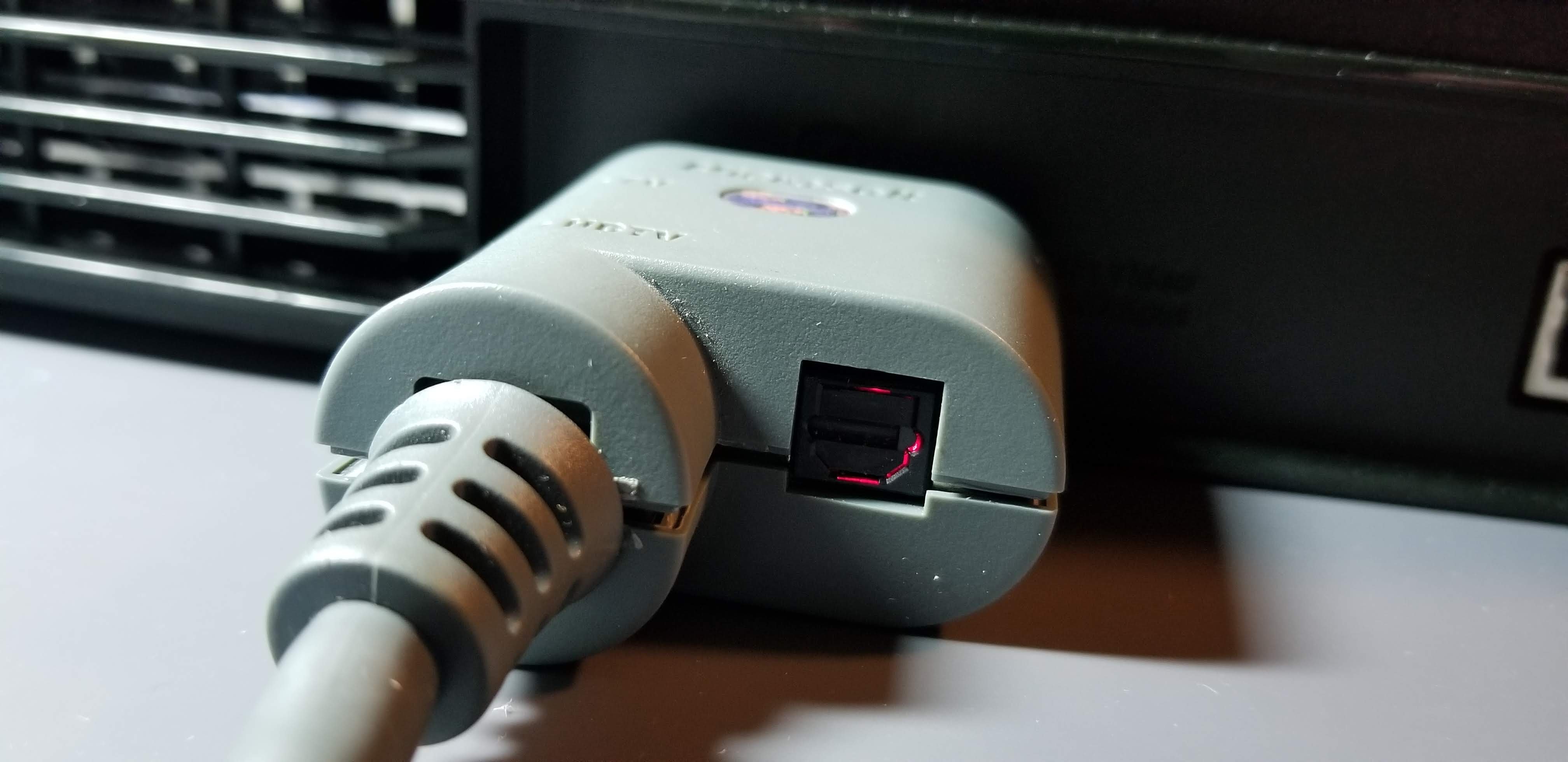

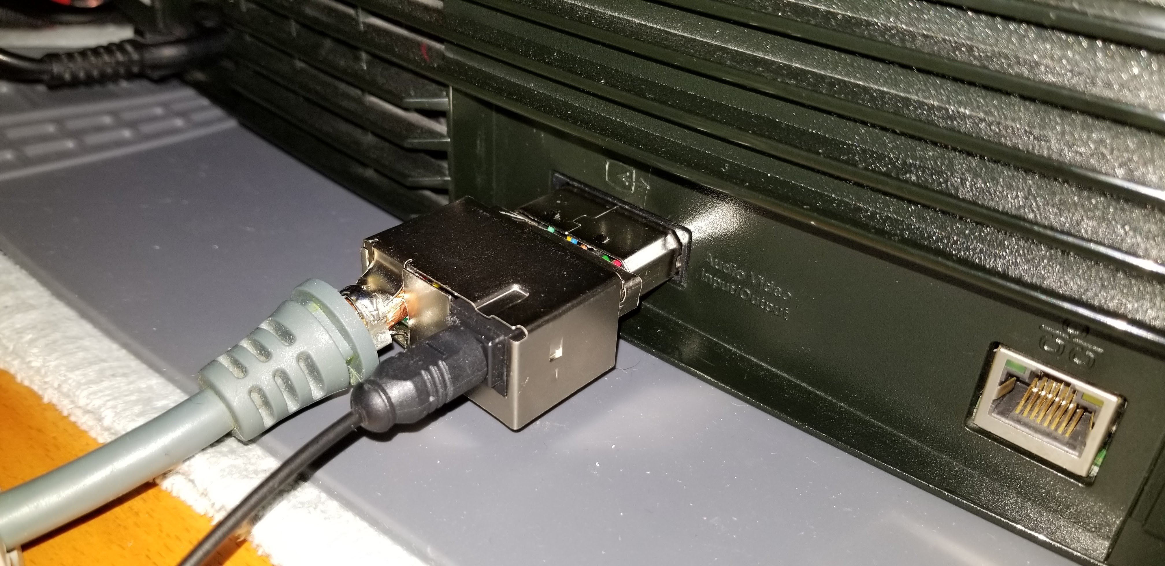

Personally, while in there and soldering everything up I prefer to just do it once and have all the bells and whistles. The optical transmitter in the 360 cable is compatible with the OGXBOX and the little board has a capacitor on it already. You never know if you are going to upgrade your audio system (or get wireless headphones with Optical Inputs) so it is nice to have it there already.

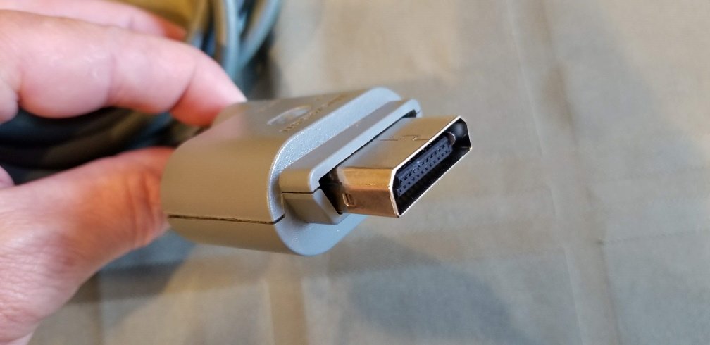

The metal housing for the OGXBOX connector is thicker than the 360 so it take a lot of fiddling to get "just right" without removing too much material. Wish I had a 3d printer. Ultimatly you probably will not be looking at the minor (the pictures make it look huge) gaps; but enjoying the OGXBOX in 480p or 720p and much more clarity than the composite cables for much cheaper (these cost me about $7 in parts...total... each)I did a bunch of these and found a lot of variations in them; not only with the internals, but with how much glue holds the casing together and if the metal shielding was soldered heavily, lightly or not at all. But they all work the same. How well yours turns out will depend on how much time you spend on it.
I would guess that about half the time on these is spent on the plastic housing getting them "pretty good". They will never look "perfect" because they can sometimes take a beating getting them open.

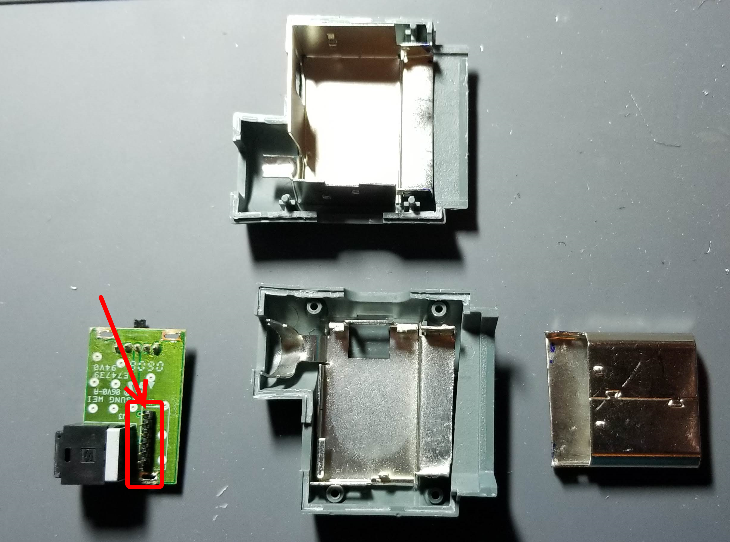

It changes which outputs are used: HD = Component (YPbPr Aka the Red, Green and Blue connectors - Pin 18 and 19 to Ground) and SD = Composite (Yellow - Pin 17 to Ground).
They way I wire it up with the original XBOX, it changes which "Mode" pins are connected to Ground. -

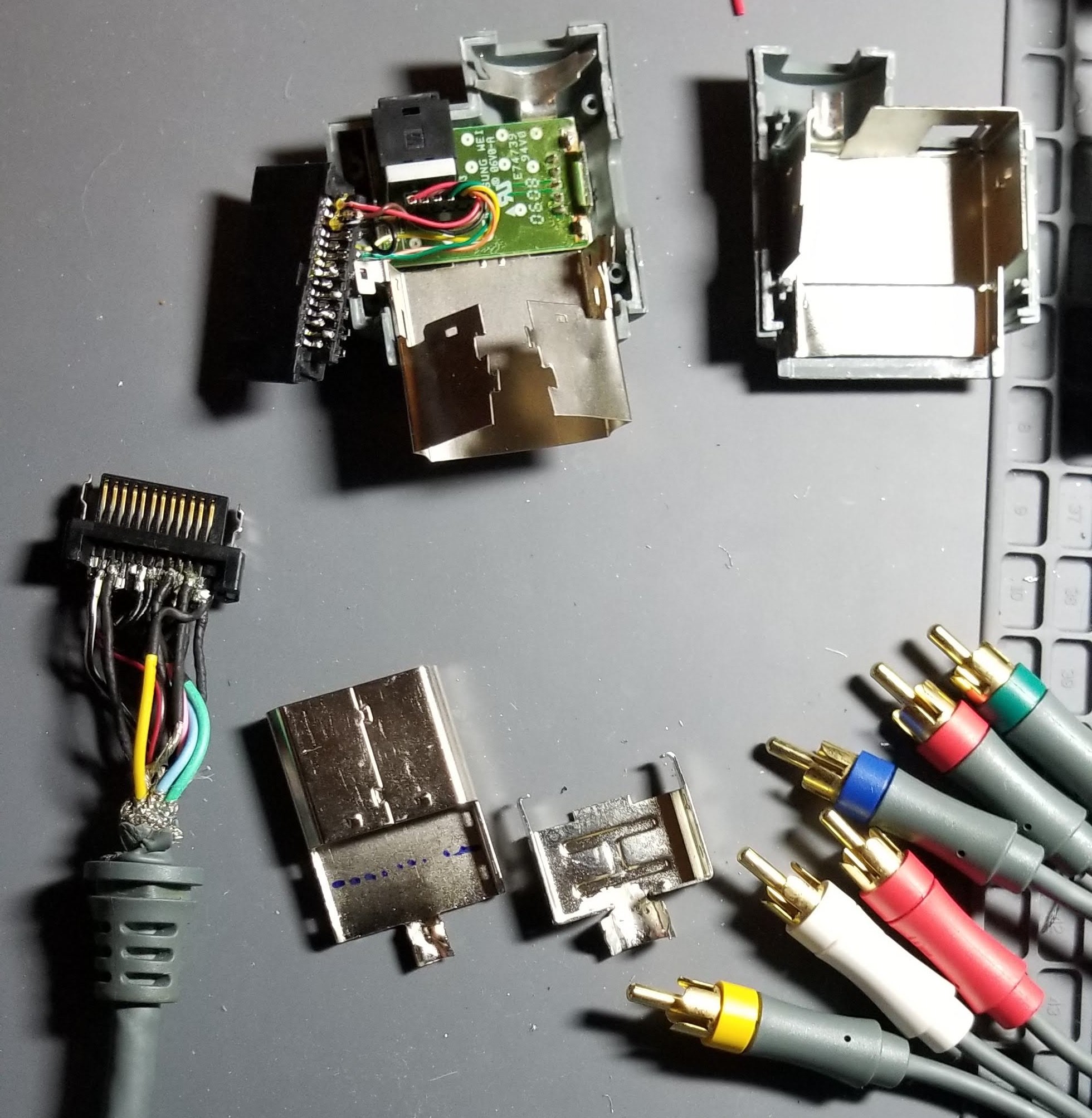

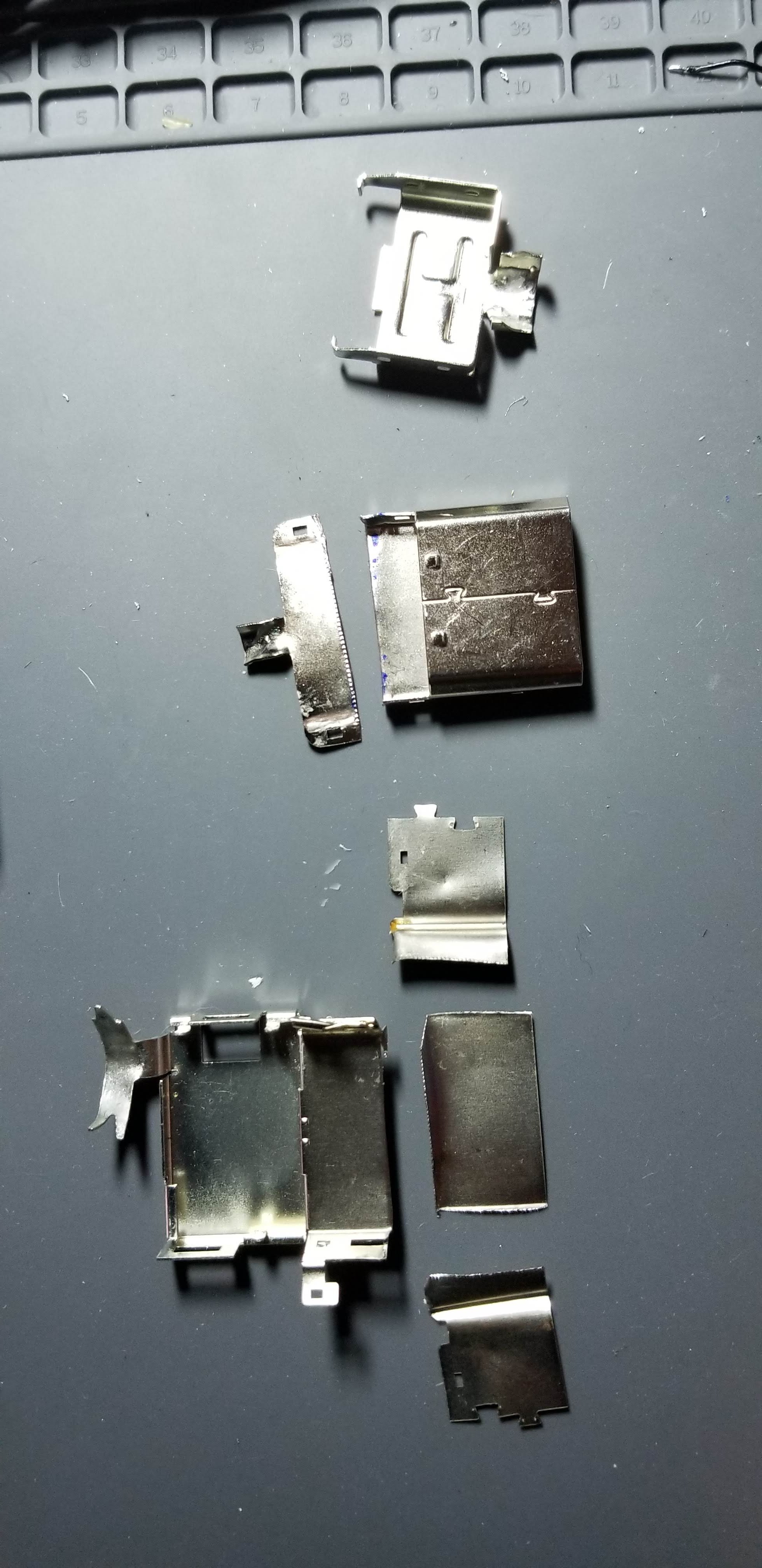

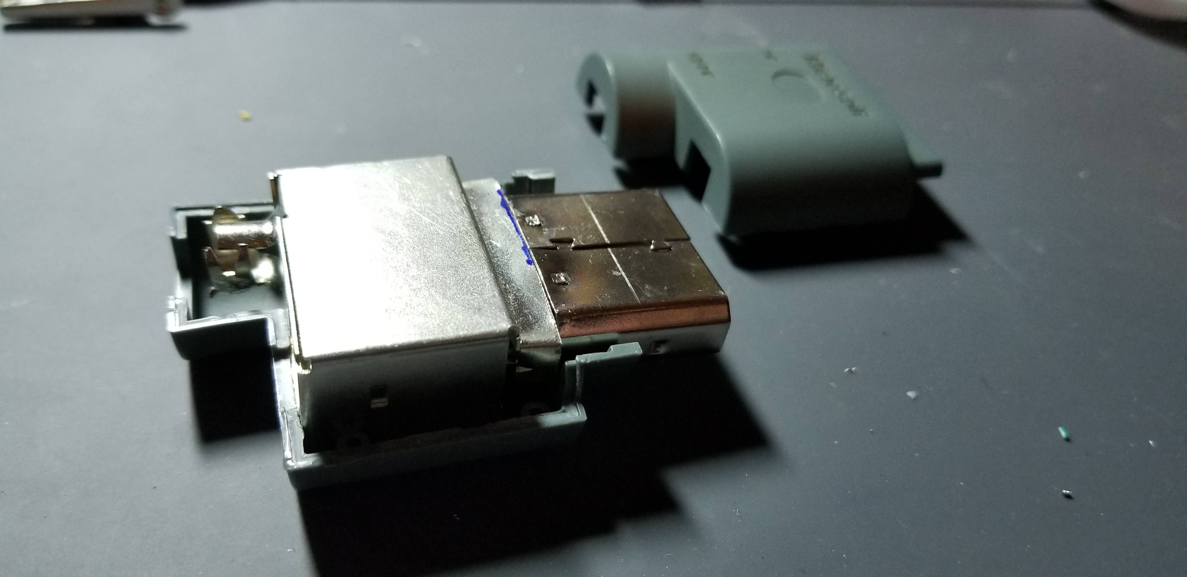

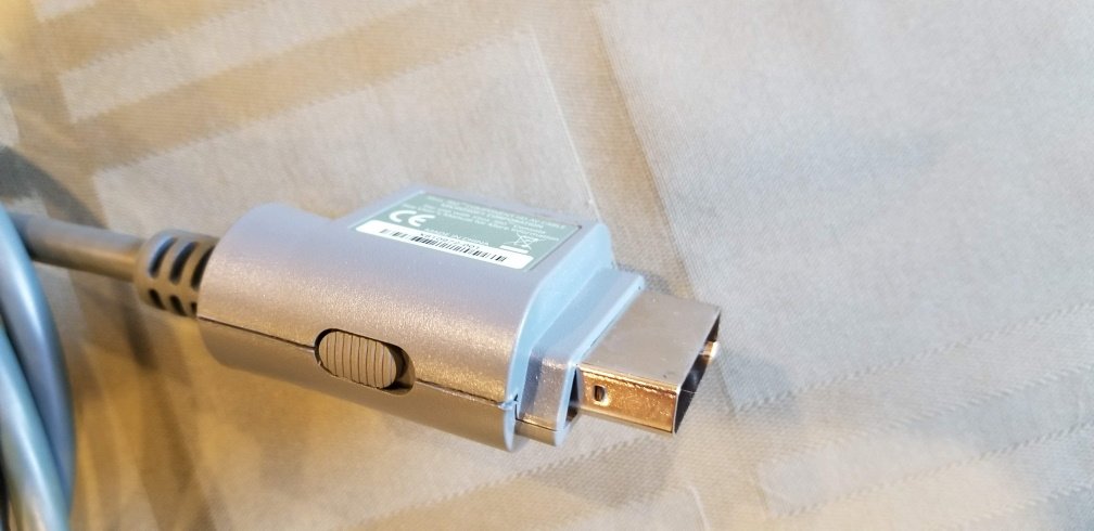

It takes a lot of work, but it can be done with patience. You have to cut the OGXbox metal housing down (I used a dremel cutoff tool) to be a length that can be soldered to the base piece. Difficult to explain, but it can be done as you can see from the pictures the parts need to be cut up to and re-joined. Before you disassemble the OGXbox component cable, I would recommend scribing (marking) the exact length. Take a screwdriver or sharp edge and mark where the plastic is on the metal so you know how much metal you need to cut. You might be able to see the mark on 20190603_210457.jpc picture.
Good luck on your project. Take your time and would recommend de-constructing things non-destructively as possible (unsolder instead of cut ~ at least the 360 cable which you want to re-use). Done properly you can re-use the optical out and housing (with some filing).
Once you get the 360 housing open you can push the connector out; remove the hot-glue like stuff and unsolder the wires. I used two different tip sizes, one for the ground wires and a smaller one for everything else.
Converting an XBOX 360 Component Cable to work with an Original XBOX is a pretty good project depending on your soldering skills.
If you go that route I have some tips since I have done about a dozen of these with working optical ports and SD<-->HD Switch.Unlike some of the videos; I recommend unsoldering the wires from the 360 connector instead of cutting them to keep the length long enough so you can reuse the 360 housing (with a bit of filing).

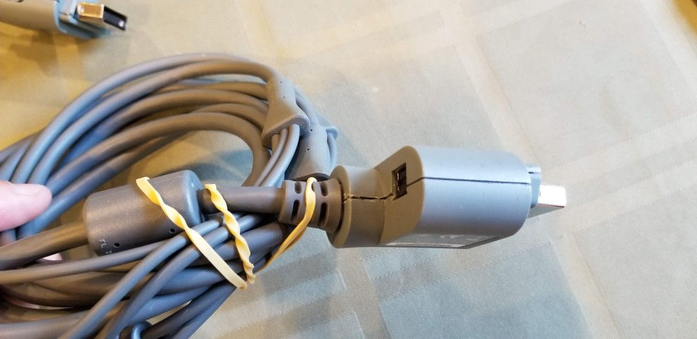

Are they Actual Microsoft Component cables or the cheap ones?
The cheap ones (typically under $10 on amazon/fleabay) will product horrible images because they are not properly build or shielded.

You have to cut a trace on the little PCB, then wire the middle post of the switch to pins 5,6 and 7 (GND).
With the switch in the "SD" position wire to pin 17
With the switch in the "HD" position wire to pin 18 and 19
Use a blunt plastic object to push the original 360 plug into the housing where it can be removed; however that part of the shield is discarded.
I used a Dremel to cut the metal shield down to size and a file to debur the edges.
