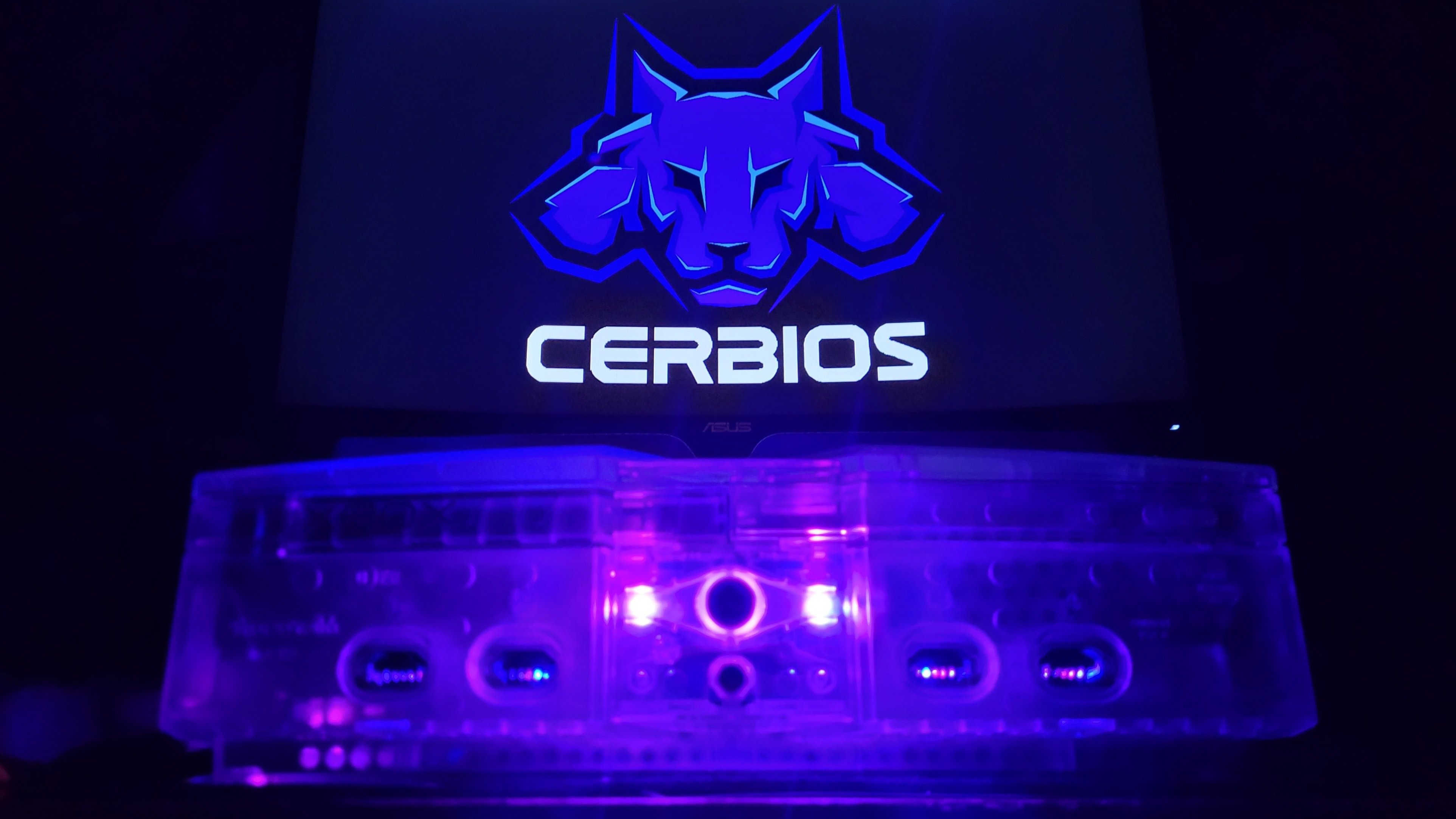

  1. Works with my Maxtor Quickview and Cerbios. Should work in your case!
