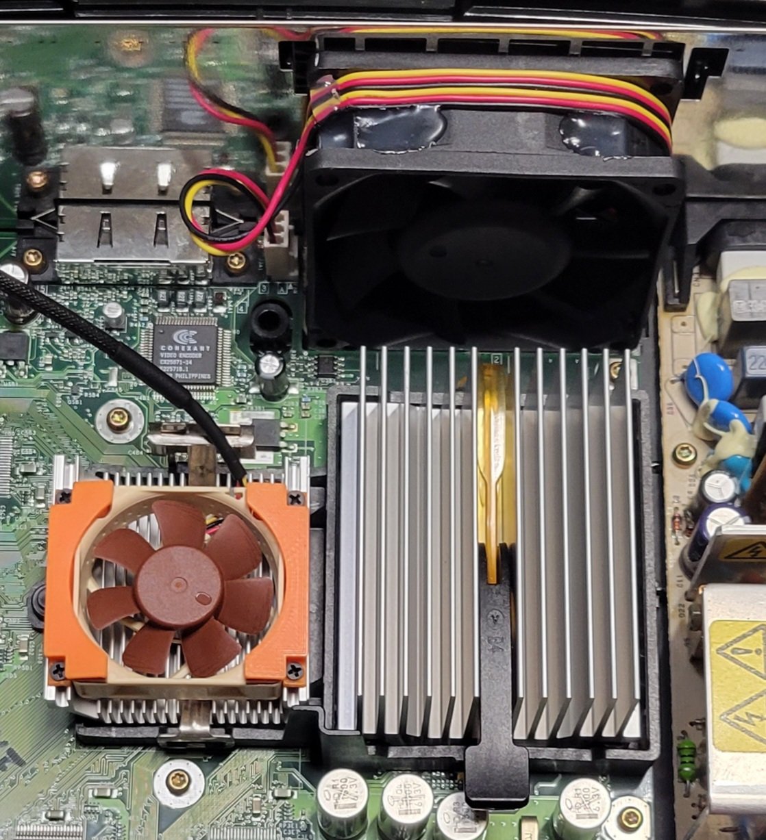

Been using that brand fan in PC’s for a while now, they are as good as the reviews say. Is that a 3D printed mount?

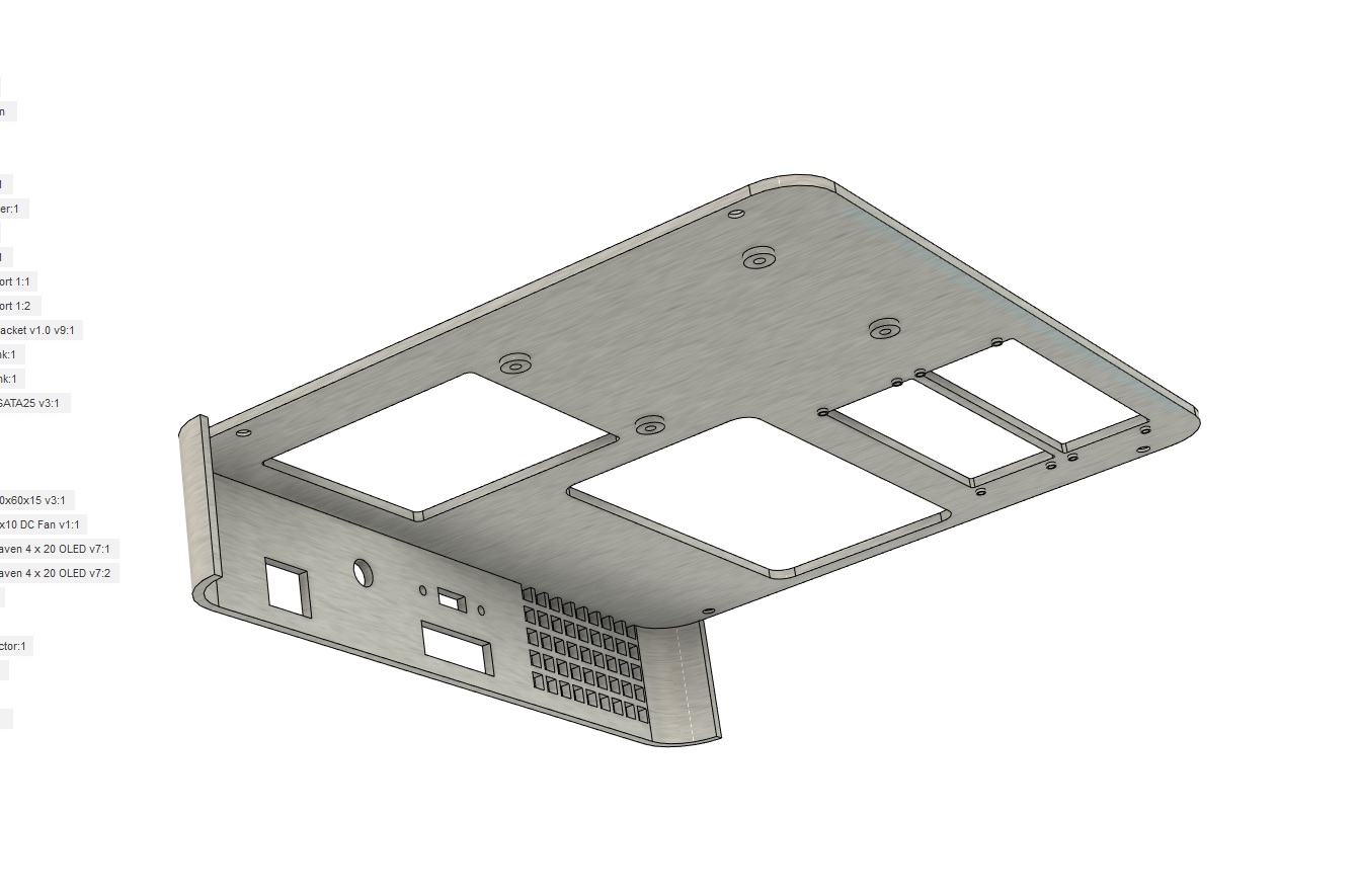

So I've revised things again, now the HDD attaches to the underside of the top piece eliminating the need for a hdd bracket at all, thanks for the idea @sweetdarkdestiny
This frees up more motherboard mount points for different CPU and GPU heatsink options, I might be scrapping my cpu bracket and going with 2 Evercool VC-RF VGA & Chipset Coolers, only £10 each on ebay.
Just waiting on the Star Tech SATA to IDE adapter and more filament to re print the entire case after lots of adjustments, I've gone for some Geeetech silk silver PLA, hopefully it'll look good
