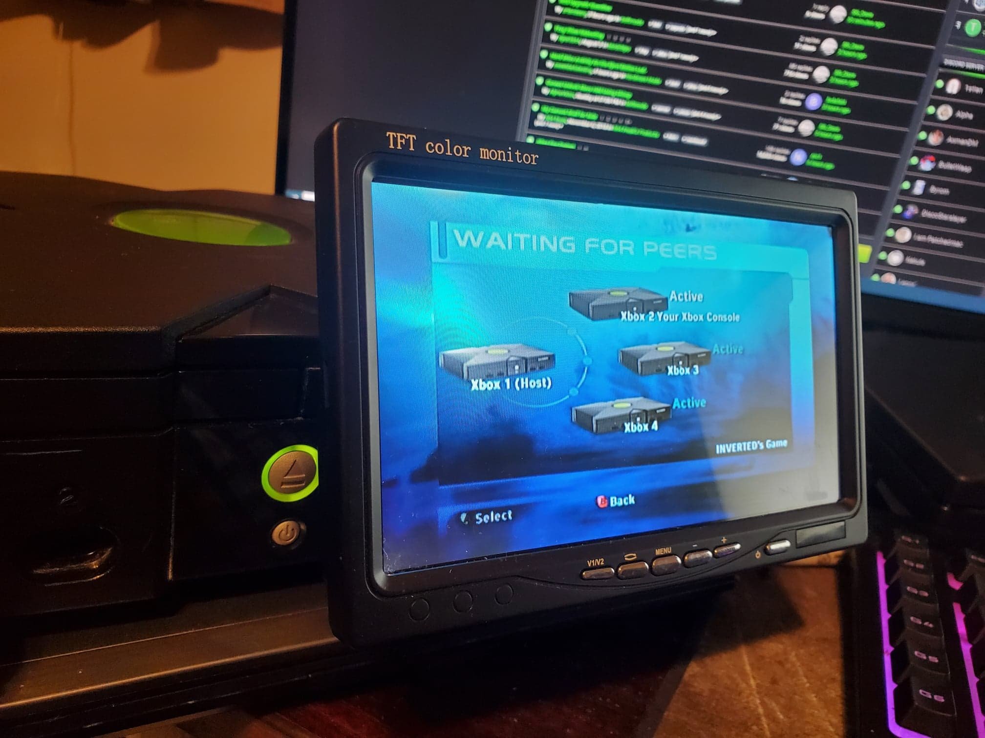

  10. 9 hours ago, xicat487 said:
    Man WTF I don't get it I must be mental, I will keep tinkering with it. Thank you again for your time and effort. If I get it sorted an update will be posted.
    Just to verify it would work I set up an xbox in various rooms and various network drops on various switches. Here is the result.
    Any time my friend. Good luck with your troubleshooting. I will say though, if one xbox is not receiving an IP address, that proves you have something wrong on that link. If you know dhcp is set up and working, you could have a bad switch port, bad cable, or bad nic in the xbox.

  12. 12 minutes ago, xicat487 said:
    Of the xboxes you used do any of them have XBMC or a softmod on them ? If so what BIOS ?
    I don't softmod. Never have. They all have xbmc.... but that doesn't matter. Once you load a game, the dashboard is completely flushed from memory as well as any settings it set such as IP address, etc.
