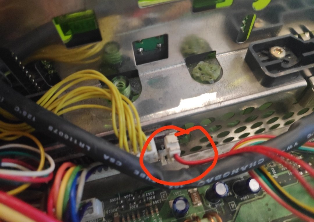

21 minutes ago, hastings298 said:
I think one socket is for the switch panel input and the other is to go out to the X3. Look around for a disconnected molex.
