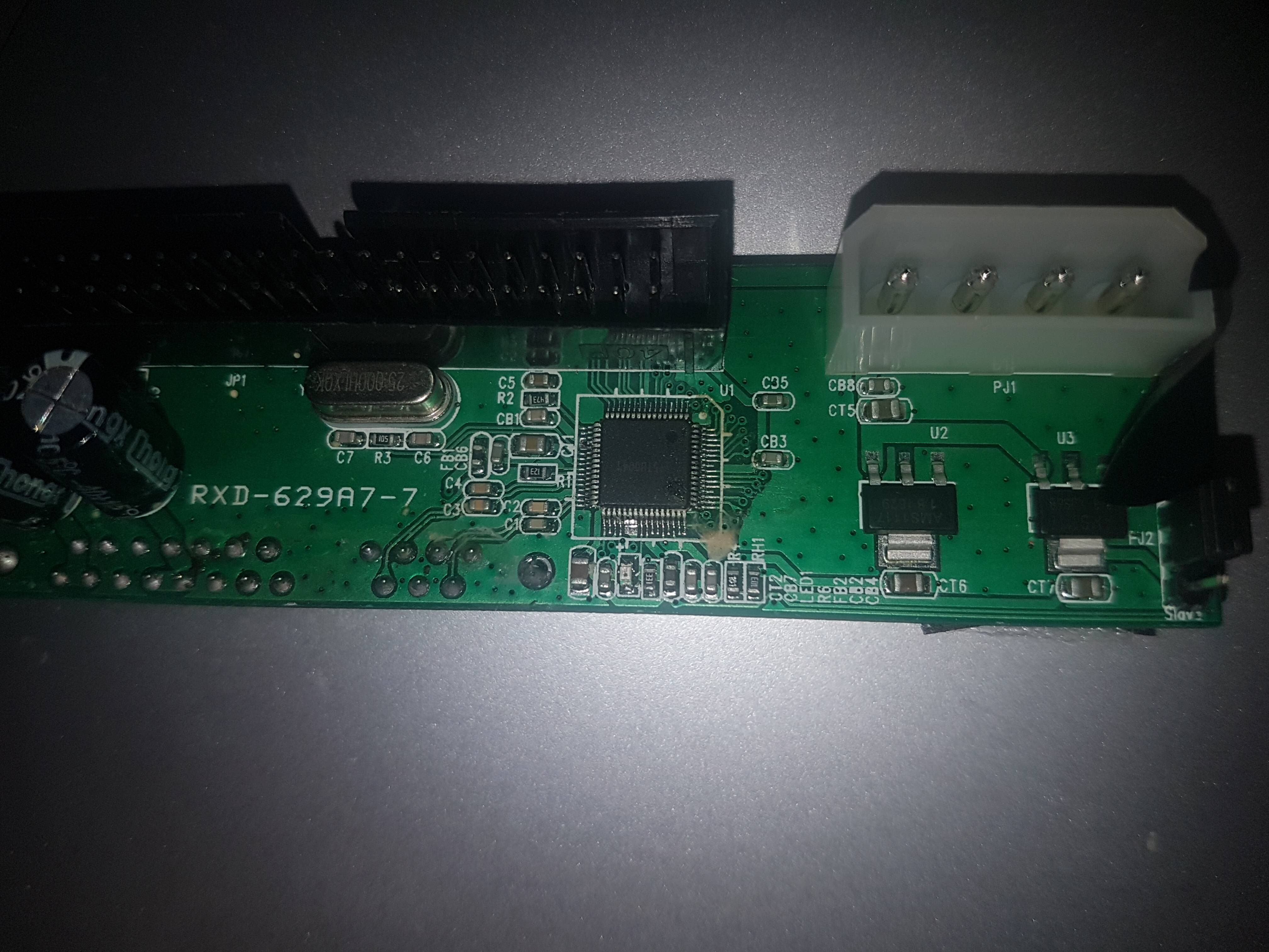

  12. 12 hours ago, Raidernick said:
    That green china adapter is fine as long as you put a 0603 100ohm resistor at R4. Doing that will give instant boot times and allow the adapter to run in UDMA6 mode at near UDMA6 speeds(around 90-95% speed). It's not as good as startech, but close enough at a small fraction of the price. Also, the startech chipset does have that incompatibility with newer cerbios versions, samsung b dvd drives and hdd's over 1tb in size(this may be hit or miss for some people).
    my adapter has it, interesting
