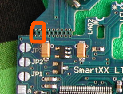

It seems like the OS is corrupt to me so I'm trying something new. I have a working SmartXX chip coming which has the pinheader section still on it. Going to meter the connections to see if it changes connections to the LPC. from pictures I have noted that it disconnects 2 points (pictured) when the pinheader section is removed. Need the new chip to verify.

connecting the "eject" pad on the chip to the motherboard point in the instructions. This allows me to boot the motherboard TSOP. When I press eject It boots the motherboard bios fine, which loads my XBMC. When I press power it frags frags and then... frags. I tried jumpering JP1, JP2, and JP3 in all combinations and it still frags.
Tried it in my v1.4 which has a working X3 modchip with the same results. It frags when I try to start with the smartxx. if I press eject it boots the motherboard TSOP.
The pinheader section of the modchip is snapped off for installation in a v1.6, which the instructions say to do. I have a 1.2 though, but this should be fine. the video I found shows a wire install in a v1.o which the pinheader section is snapped off.

the instructions said that the eject wire is not needed, so I did not do it. now that I have it soldered it will boot my TSOP. this tells me that the chip is controlling the boot process. just cannot get the OS to boot. I do not think there are any bios's flashed to it. I believe the chip has never been used, none of the pads had any solder on them. they were all like new. of course someone may have tried to install via pinheader but the DO point is on the chip and was never soldered.

I am starting to think the chip is bad, but I am going to mess with it for a while and see what happens. I see that the smartxx v3 has 2 easy solder pads labeled "recover DO", the OPX has 3 of them labeled JP1, JP2 and JP3. I am going to see what happens on all button press combos when these pads are shorted.
