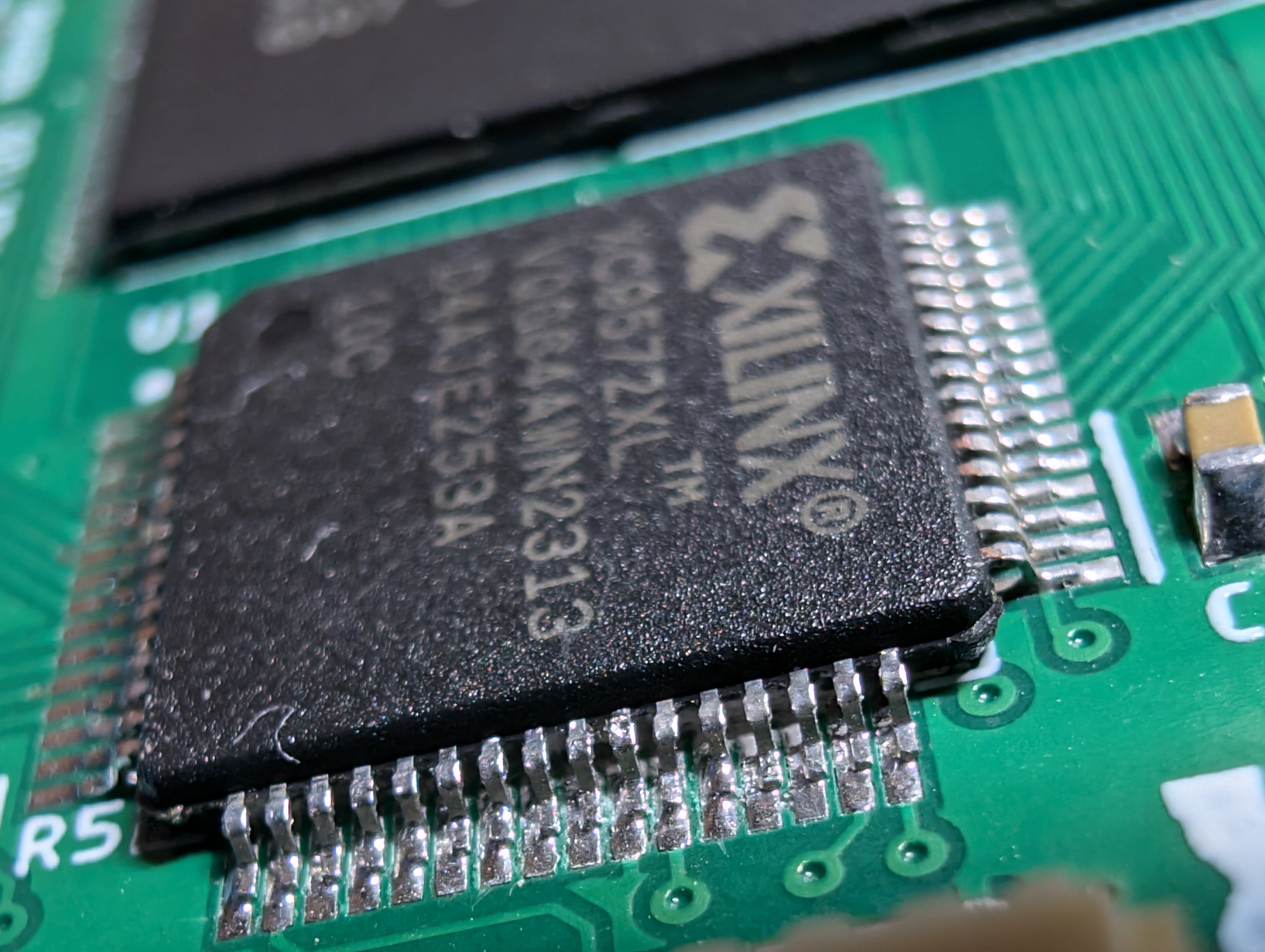

    -recap the motherboard or at least replace the five gray power caps near the cpu if they’re still the original. These are a common point of failure on the Xbox mobos. I like to do a recap of the whole thing when I work on them but at the very least I do those.
    -Once you remove the old hardmod you could install a pin header in the lpc port which would make your next chip install a bit easier with most of the modern versions of the hard mods. You’d still have to do D0 but that’s easy enough.
