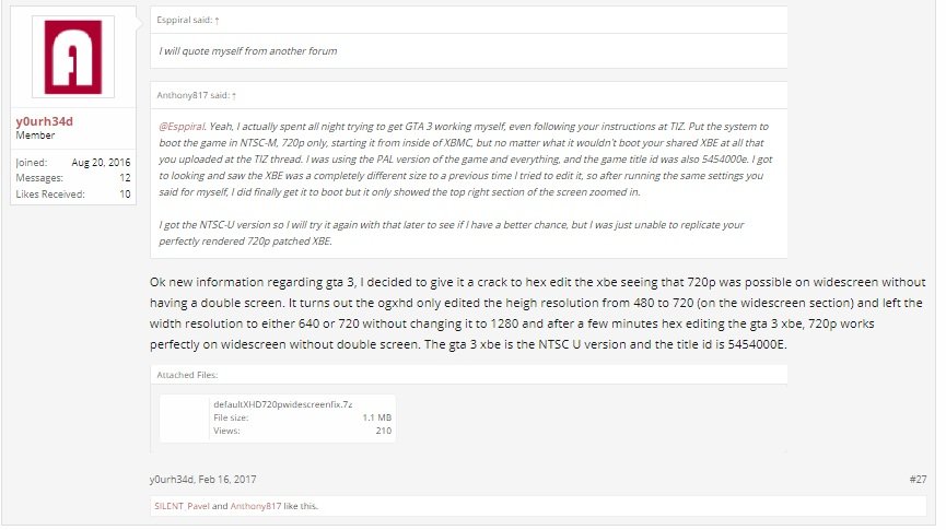

3 minutes ago, y0urh34d said:
I couldn't overcome the double screen on Gta Vc, for anyone interested whats happening is the game is running at 720x720 not 1280x720 so you get the double screen,
similar thing I got in Halo 2

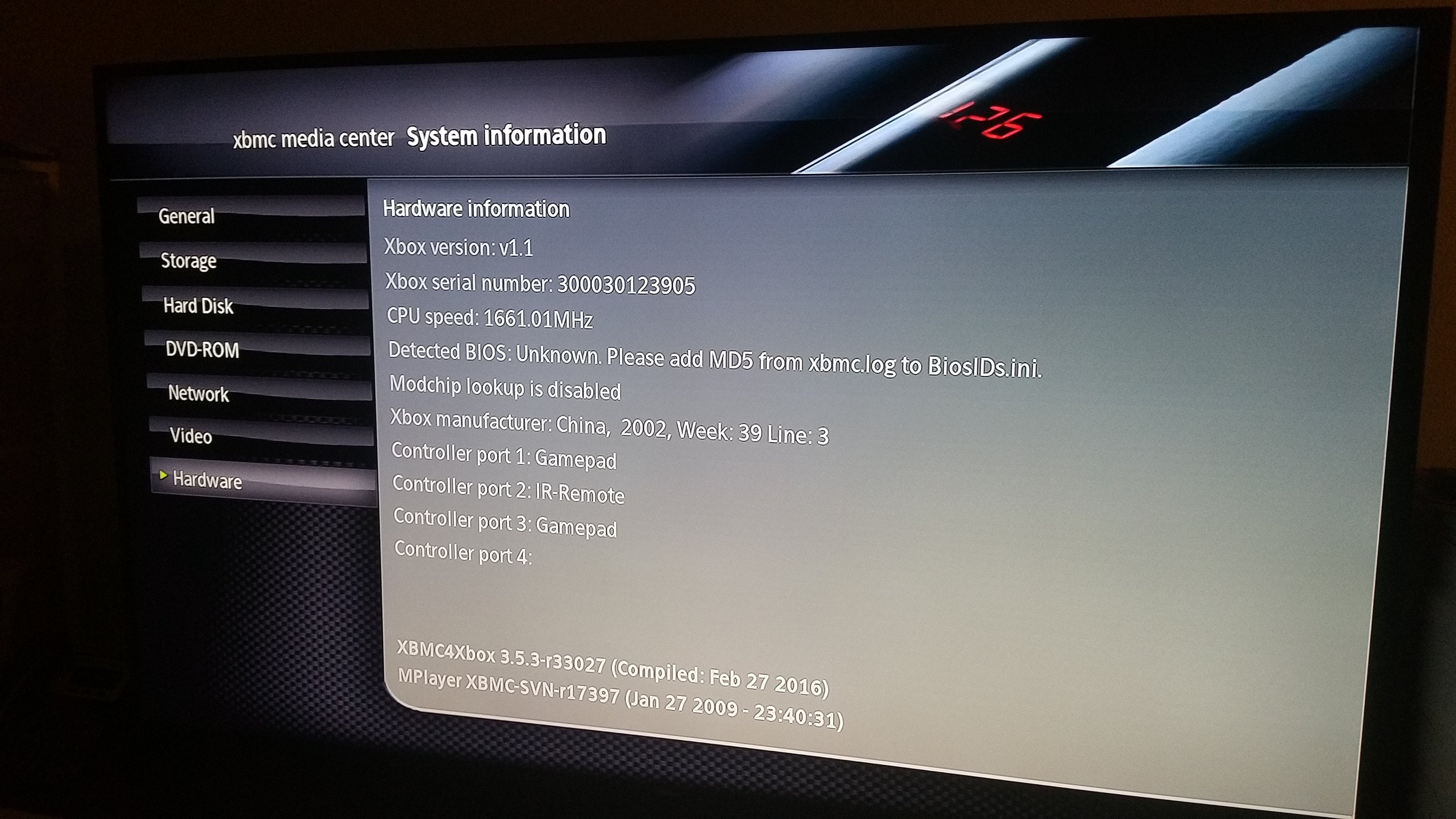

With the overclocking tool, I managed to get 280mhz on the gpu and 158.3mhz fsb which is 1660mhz on the cpu (I did both overclocks at the same time). I couldn't push any higher on the cpu and I know the gpu at 290, the xbox freezes up on boot. My xbox is a v1.1 with the x3cp mod with the 1.4ghz cpu replacement and the 128mb ram upgrade.
So far the only thing I tested was Goldeneye on N64 emulator and the game so far at the start, there is almost no performance hit with 720p with the overclocks. I'll test some more stuff if anybody wants to know the performance of any other emulators or whatever. Maybe I'll test my other 1.4ghz xbox which is a v1.4 with that different gpu and see what I'd get.
nice, did you add more cooling to the board?
did you patch the xbe for new 1660mhz speed?did you try to watch 720p mp4 videos?
