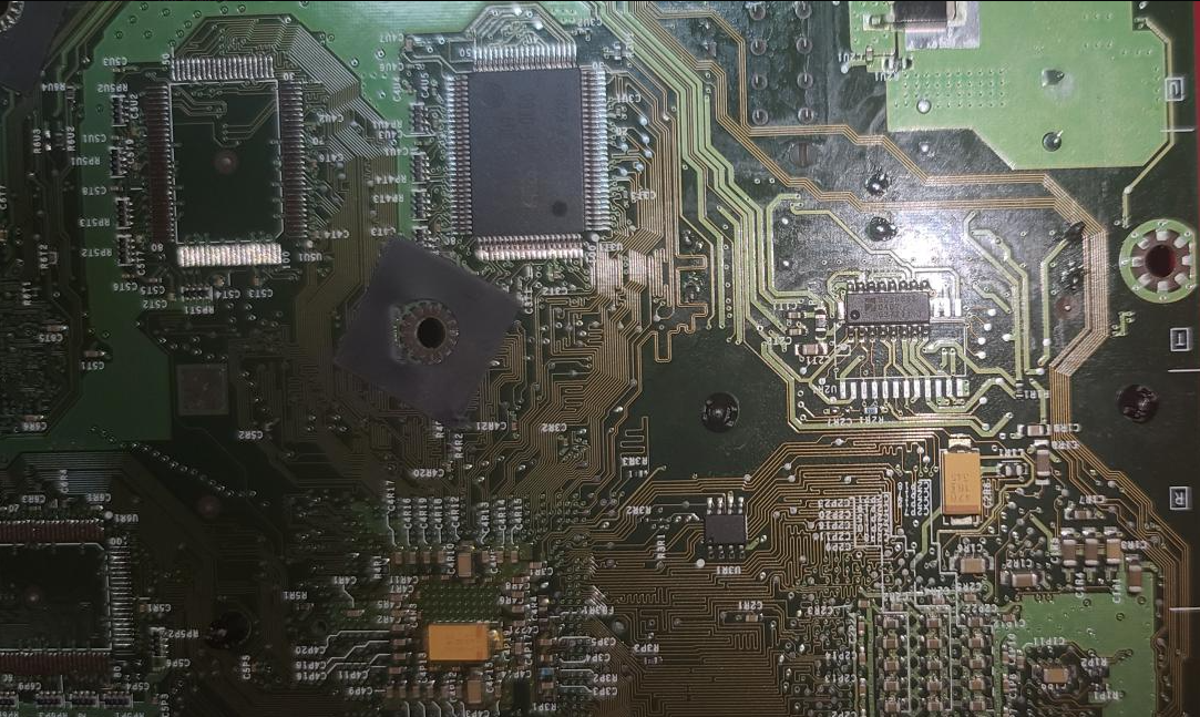

10 hours ago, russlb said:
Definitely needs a better picture. Lighting without the flash would be much better due to the glare it causes.
But, wth is going on with those faces over by that screw hole on the right? Did you pool solder on top of them in the left bend?

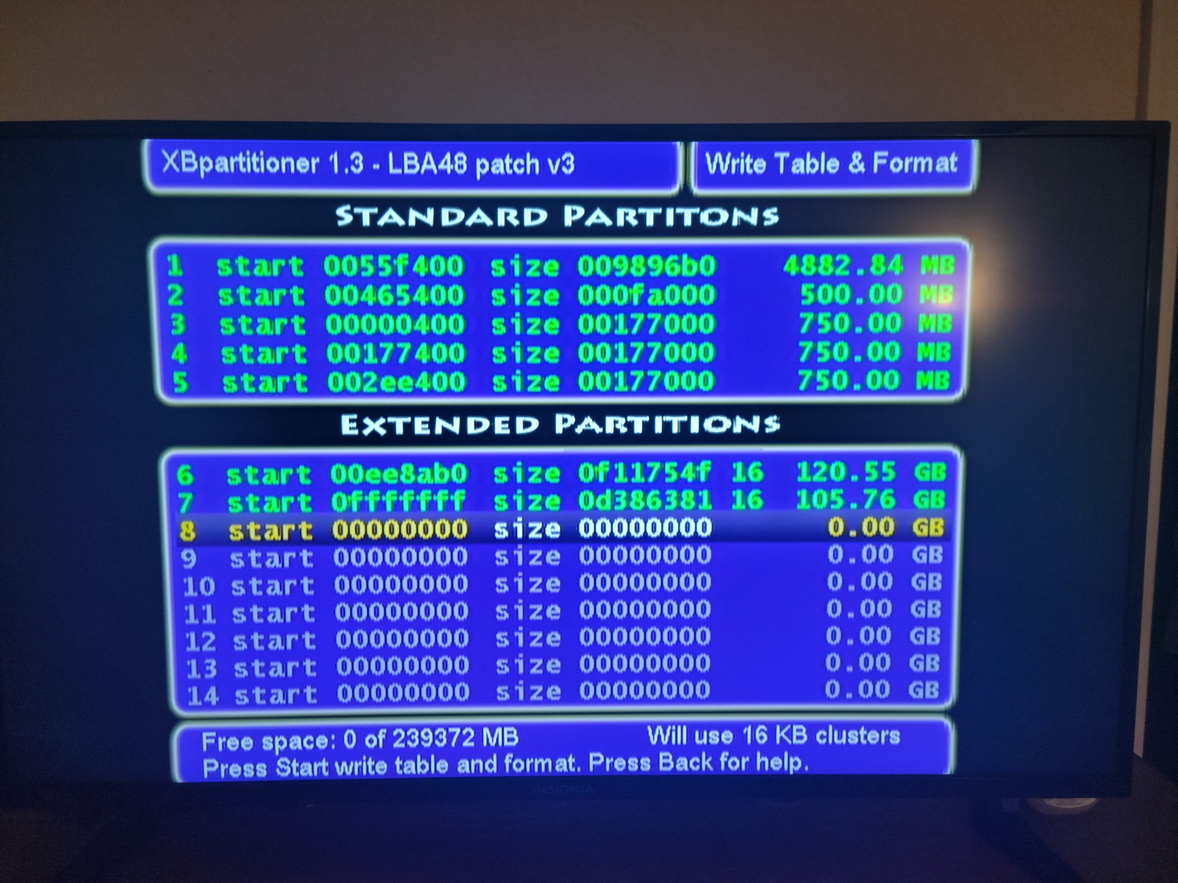

4 hours ago, Donnie-Burger said:
I don't have any other drives to test with, but I had no graphical glitching in xbpartitioner that I could tell. I was ftp-ing in xbmc at around 4-5MB/s which seems fairly typical. And like I said, everything plays perfectly fine including Xbox games from the HDD. The only thing that's been slow is the menus. Unfortunately, I also don't have any ide interfaces for my computers anymore... And not to interested in purchasing a usb-ide adapter (this Xbox is just for my daughter to play on, and she has a 360 with pretty much the same stuff on it).
I can live with things as they are, I just wanted to make sure I wasn't missing something dumb/obvious that would cause this as far as settings went.

1 hour ago, Donnie-Burger said:
put up:
hard drive
addapter
cable
models
The harddrive is a Maxto 4A250J0, which i'm just realizing is an old 5400rpm drive... so I can't expect much out of it. It's not locked. There's no adapter, and it's just the OEM ribbon cable. (Partition Layout attached)
I ended up deleting the XBMC-Emustation folder and copying it back over via FTP and just putting 1 NES rom into the roms folder on 'E' and letting it scan. The menu does come up a lot faster like that, around 3-4 seconds. The gameslist.xml was only 2kb though, so that's not so surprising. It might just be an issue with a slow hard-drive. Though, I thought that the XBOX only gets like 10MB/s through its IDE controller anyway so I wouldn't have expected it to be *that* slow off of a slow drive.
I went ahead and rescanned them all back in and the gamelist.xml is around 47kb for that system (NES) and it's back to ~25 seconds for the game list menu to open in the basic view. I know that the list has to be processed and all that, but I can't imagine that the hard-drive speed would have that huge of an effect for a 47kb list to be read off of it. Is it trying to validate that everything exists as it processes the list or something (this would make sense for hdd seek speeds and such to slow it down)? Is there a way to disable that so that it just shows the list without validation? Obviously, if something doesn't exist anymore since the games were scanned this could cause a crash... But I'd rather that being a problem and the list opening quickly.
I have fast game parsing on per your previous suggestion.
1
15 hours ago, Rocky5 said:
Run Emustation from E and have the emulators, media and roms folder on a larger partition.
don’t run it from F and defo not G as the seek times are horrendous the more you fill those partitions.
That's probably where I'm going wrong. I put the roms on f and put the media on g. Emustation is on E
I'm only using a 250gb hdd, with the f/g partitions around 115gb each. If they shouldn't go on e/f/g where *should* I put them for better results?
Or should I have made an extra partition with like 10-20gb to store them?
1
