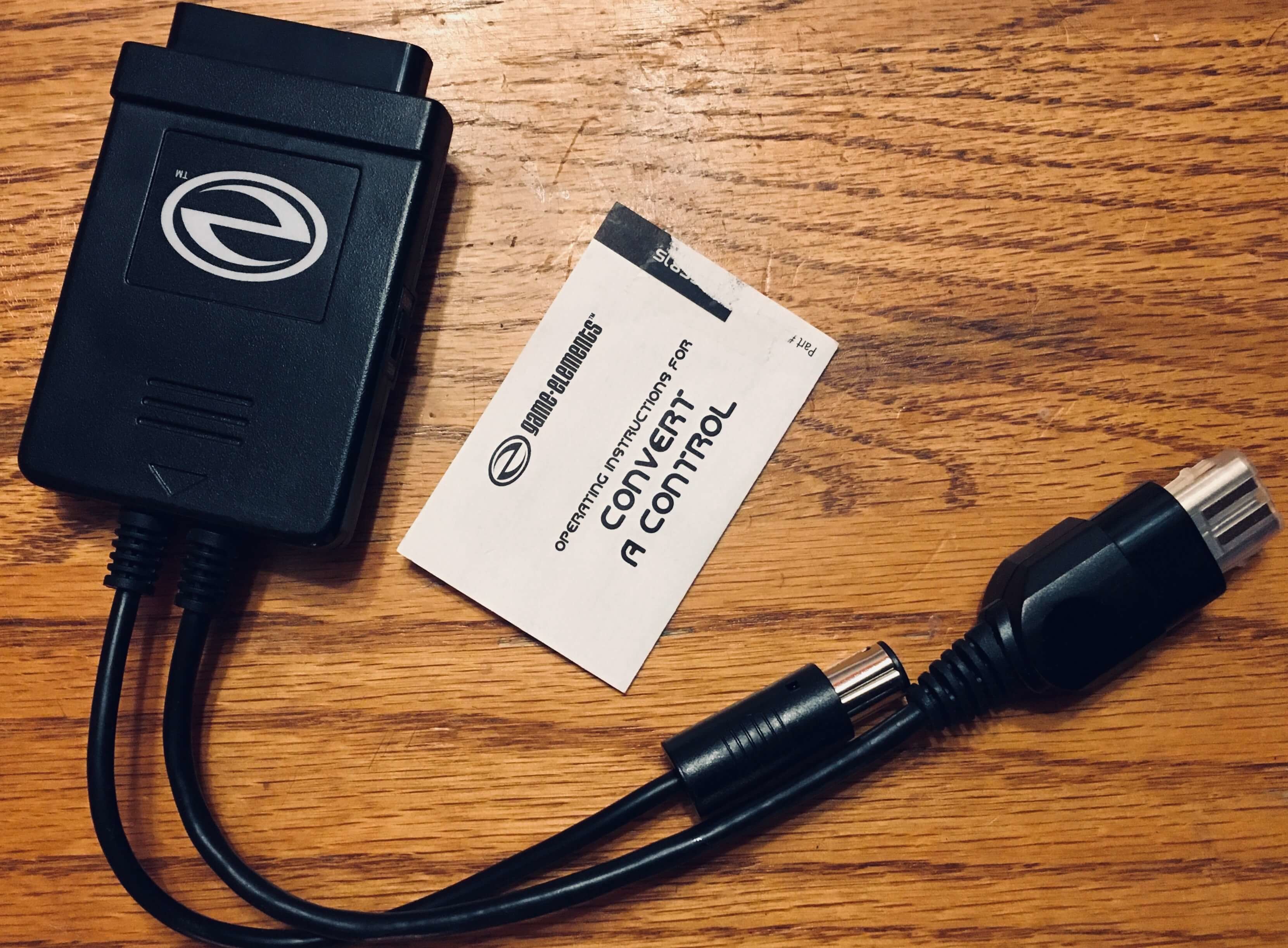

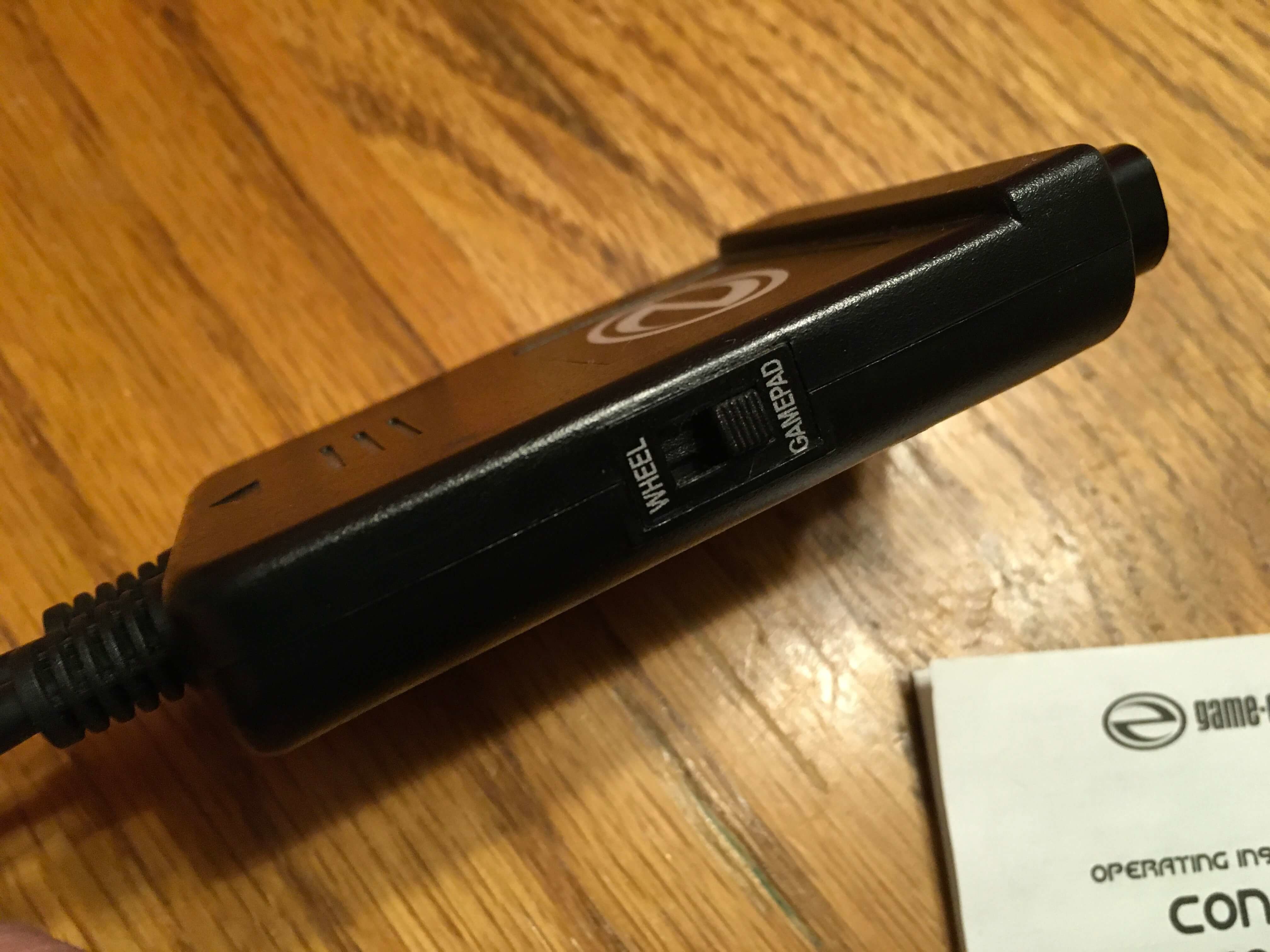

Upon further research(eBay), it looks like this device is only for PS2 controllers.
