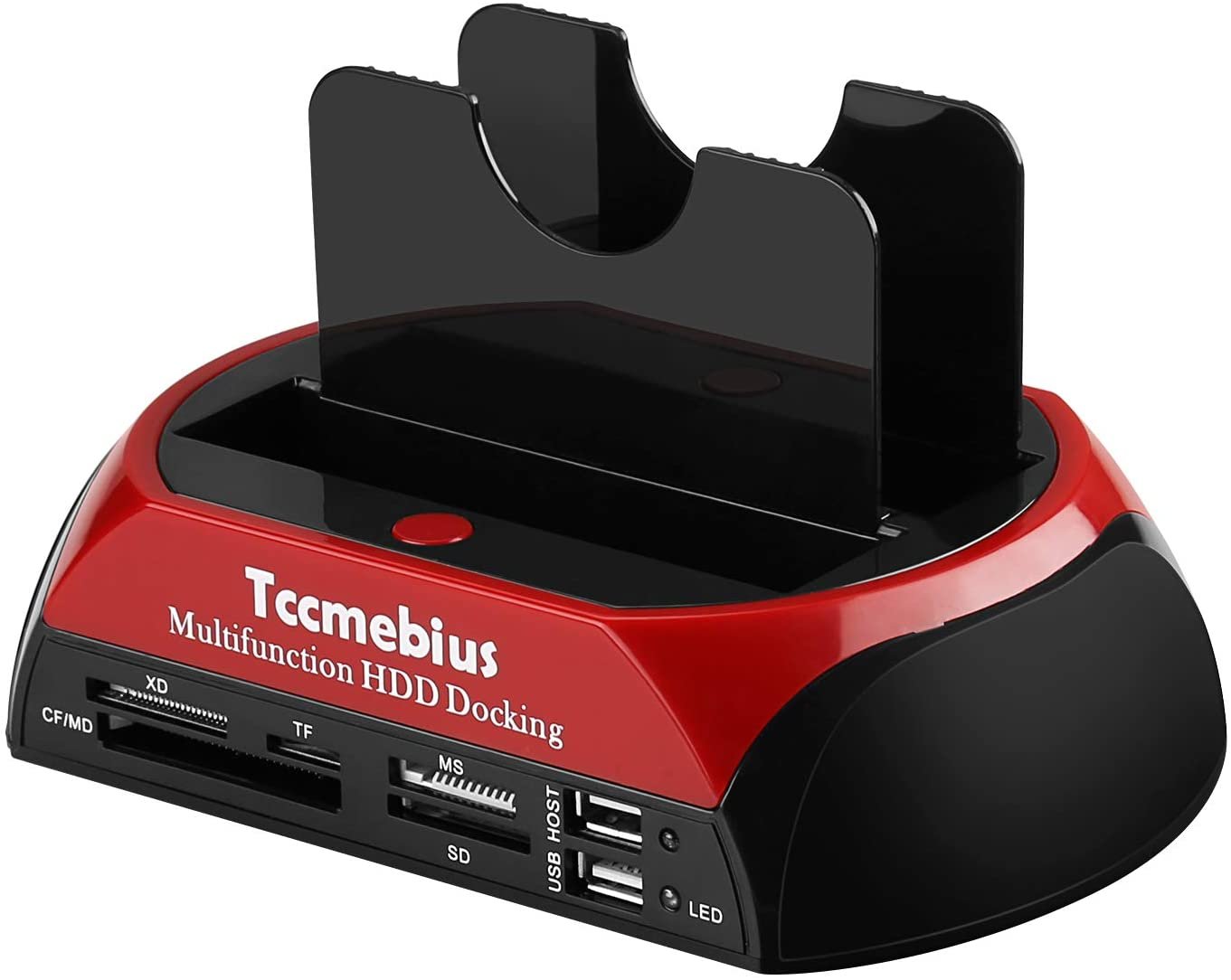

7 hours ago, KaosEngineer said:
Possibly. The hard drive has to be unlocked for it to have any chance of working.Does it have a standalone cloning function?Next, it depends how its cloning function is implemented - some devices do known file system copying while others do sector-by-sector.It needs to do the later, sector-by-sector cloning, to work.Oops, I was thinking of the wrong question.
Yes, you can connect that to your PC and use FATXplorer Beta 3.0 to copy files to the Xbox hard drive.
Again, the hard drive has to be unlocked. With a hard modded console, the hard drive can be left unlocked. For a softmodded console, the hard drive has to be re-LOCKED with the correct password.
yeah thanks i'll give it a try
one more question how i can make my xbox unNoisy because it has laud noisy sound and how i can add emu music and cheat codes for my xbox games
Connect the hard drive to your PC and use FATXplorer Beta 3.0 to copy files to the various partitions.
look i have that device will is it do the job?
