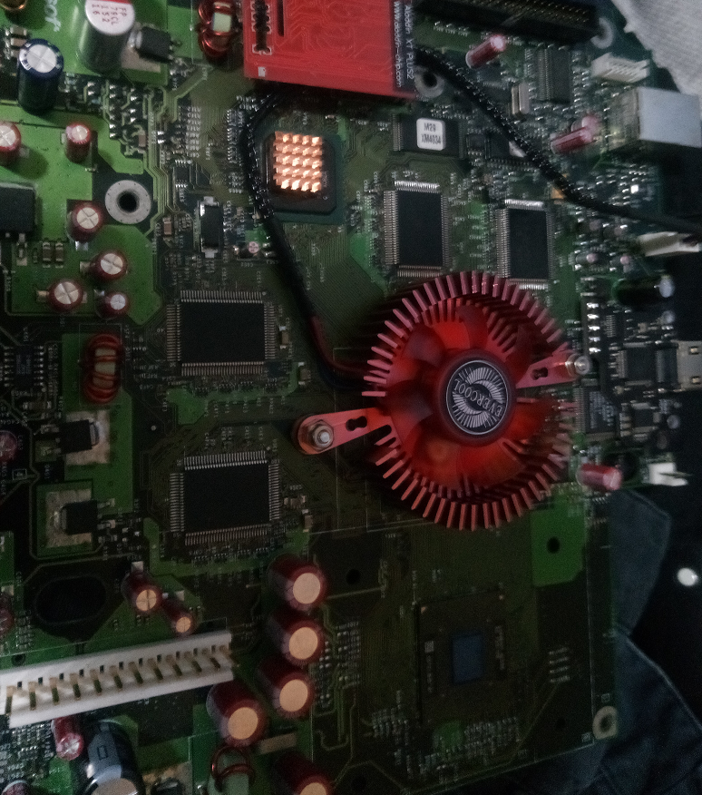

  12. When the temperatures start to get too high for my liking I tend to replace the heatsinks with VGA coolers. Having said, the last time I did this yesterday, I heated the original heatsinks too much in the process of unsetting the glue, teaches me to use a temperature controlled gun to gently heat rather than a hairdryer! Now the board FRAGs and is irrepairable. I'm really not proud of myself for this and don't know why I tried that on this occasion when I normally use a temperature controlled gun. I guess I was acting out of haste, but it's a vital lesson learned to be much more careful with these things. My usual equipment I don't have to hand due to the COVID-19 lockdown.
    Anyways, I've found that Evercool UFO VGA coolers fit well for both the CPU and GPU, although you'll need to remove the existing plastic retainers from the board, and cut away two screw fittings from the bottom of the case under where the GPU area is. This will give you room to use bolts to hold the new heatsinks on.
    https://www.ebay.com/itm/332248005105 They aren't too noisy and do their job well.
    I keep meaning to make a tutorial for this process, but after wrecking my board during the last time I did this, I feel the need to brush up on my skills before doing such a thing. I have got a photo of one of the heatsinks attached on an earlier board I did (and is thankfully still working!):
    For the avoidance of doubt, I have already posted about this over on the XBMC4XBOX forum.

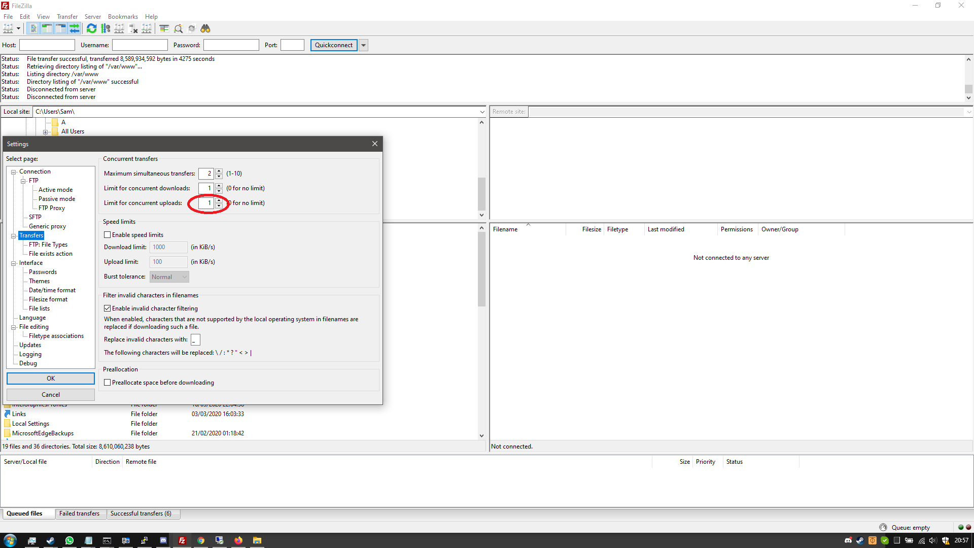

    With regards to the slower 2TB boot time: this can happen, especially if you are utilising a lot more of the space. One way you can try to keep this slowdown to a minimum is to reformat the partitions and then transfer data *one file at a time*. The reason I mention this is because many people use Filezilla to connect via FTP, and by default Filezilla sends multiple files at a time. This has the effect of fragmenting the files on the hard drive! You really want to keep this to a minimum for as long as possible.
    See the screenshot below where I've changed this setting for uploads to change this:
