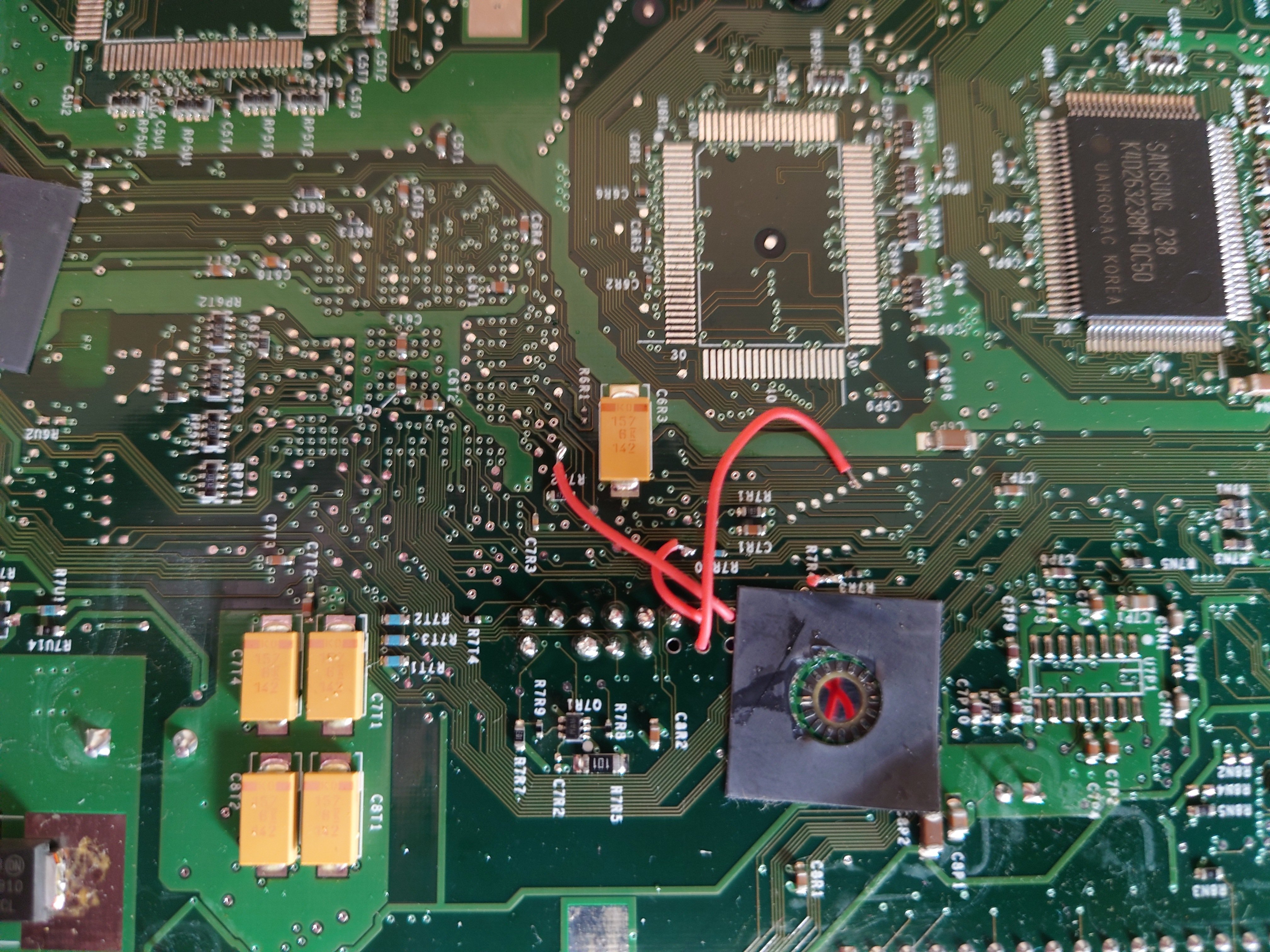

Added a pic of my soldering, the lpc isn't the greatest but that's not given me an issue, there's no solder balls just excess solder.
I've also tested alternative a15 and A19 points on the motherboard with a multimeter and the same points on the chip, both give indication of continuity
I'm going to close it up as I'm starting to think this is not related to the internals anymore

Hello
I'm having an issue successfully flashing a split Tsop using the xblast lite modchip.
I've albeit believe I've successfully soldered d0, a15 and A19 to the modchip.
I can see the split in xblast os, I can boot either split but it currently has a 1mb cerbios 2.02 on there.
I can boot either bank from the modchip.
My issue is with tsop_m7, I flash this to the 256k bank of the modchip and proceed to boot with hexen inserted that boots off the other bios. I get no display and a solid green lights, eventually the Xbox power cycles back to xblast os.
I've also tried setting the front switches to boot the 256k bank on power on same issue but it'll power cycle every minute or 2.
I've tried setting xblast os to boot bank 2 with the power button. Same issue
The option "force tsop recovery" has been set to both tsop banks - no change
I've also tried tsop_m7 on the 512k xblast lite bank - same issue
I'm stuck, not sure what to try next with the exception of shortening the a15 wire as I know I gave it too much ( approx 8 - 10 cm) but would rather not mess around with it if it's fine.
Thanks for reading, any help is appreciated
