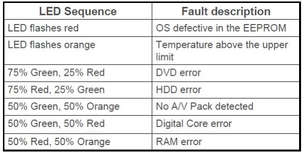

Blink pattern one: solid green then turns off and on then solid green then off and on then blinks red and green.
Blink pattern two: sold green once then it turns off and on then blinks green twice then turns off and on then blinks red and green.
The blinking pattern might be unpredictable but my last test showed that blink pattern two happened when the HDD and DVD were disconnected.
The Open Xenium connected or disconnected from the header didn't make a difference.

I also found page 78 of this old manual says that the boot behavior above is broken traces. XBOX REPAIR GUIDE (adriancallaghan.co.uk) In that case it might be impossible to find where the problem is.
The blinking pattern is different with my Open Xenium install attempt compared to without it. So that's interesting, what does that tell us?
6 hours ago, SS_Dave said:I'm not sure which either of them fit your table. Maybe 50% Green, 50% Red - digital core error?
Here is the blinking pattern with the Open Xenium install attempt:
Here is the blinking pattern without the Open Xenium:

Hi, I am just wondering if anyone with more experience than me can tell me how bad this looks or about any diagnosis clues I can be aware of. The first XBOX I found on ebay last year was surprisingly not modded and I guessed it might be a 1.0. Because of that I didn't want to mod it or open it so I bought another cheap one that had already been opened. I had some fun with that one then I gave it away. In the meantime that 1.0 was calling my name and I bit the bullet and opened it up. Softmod went fine of course. HDD upgrade went fine. Then I wanted to try something more interesting. I looked up the RAM upgrade and it didn't look too bad. That actually went smooth. Luckily the 1.0 is the least work to short circuit the TSOP. So TSOP flash and 128MB RAM was working. I kind of surprised myself. I was fumbling around not really thinking through things and I wanted to see if I could flash an original BIOS back to it. That was the end of the fun for me. After the flash it reboots and goes into the blinking red. I realized the BIOS probably didn't like having 128MB RAM so I used my heat gut to remove my just added RAM. That wasn't it. I knew it I had a big project ahead of me. That was when I found the Open Xenium modchip that apparently is supposed to divert the boot to it's own BIOS. Hence my question in this forum.
I didn't see how I was going to remove all that solder from the LPC ports with a solder braid or any other way for that matter. I realized I might be able to use my heat gun again. I had some bad luck and didn't realize how hot I was getting my board in the process either. I almost lost 3 components all together but I managed to get 2 of them back on. I circled the remaining problems in my pictures below. Is any of this repairable? The Open Xenium chip makes it to a red LED but XBOX still only boots to the blinking red lights. I was pretty happy with my soldering of the wire but not so happy with my soldering of the LPC jumpers. The board took some damage. From what the pictures say is this beyond repair? If the Open Xenium chip is making it to a red LED am I close?

This failure happened after I flashed a Kernel. Then, I read I could bypass the built in TSOP by installing the OpenXenium. Everything that I tried in the process of attempting to override the bad flash with the OpenXenium had no apparent affect on the behavior of the XBOX. It fragged when the flash broke it and it fragged all the way through the hardware mods in attempt to bypass the bad flash.
Assuming the hardware is working correctly what could be going wrong?
