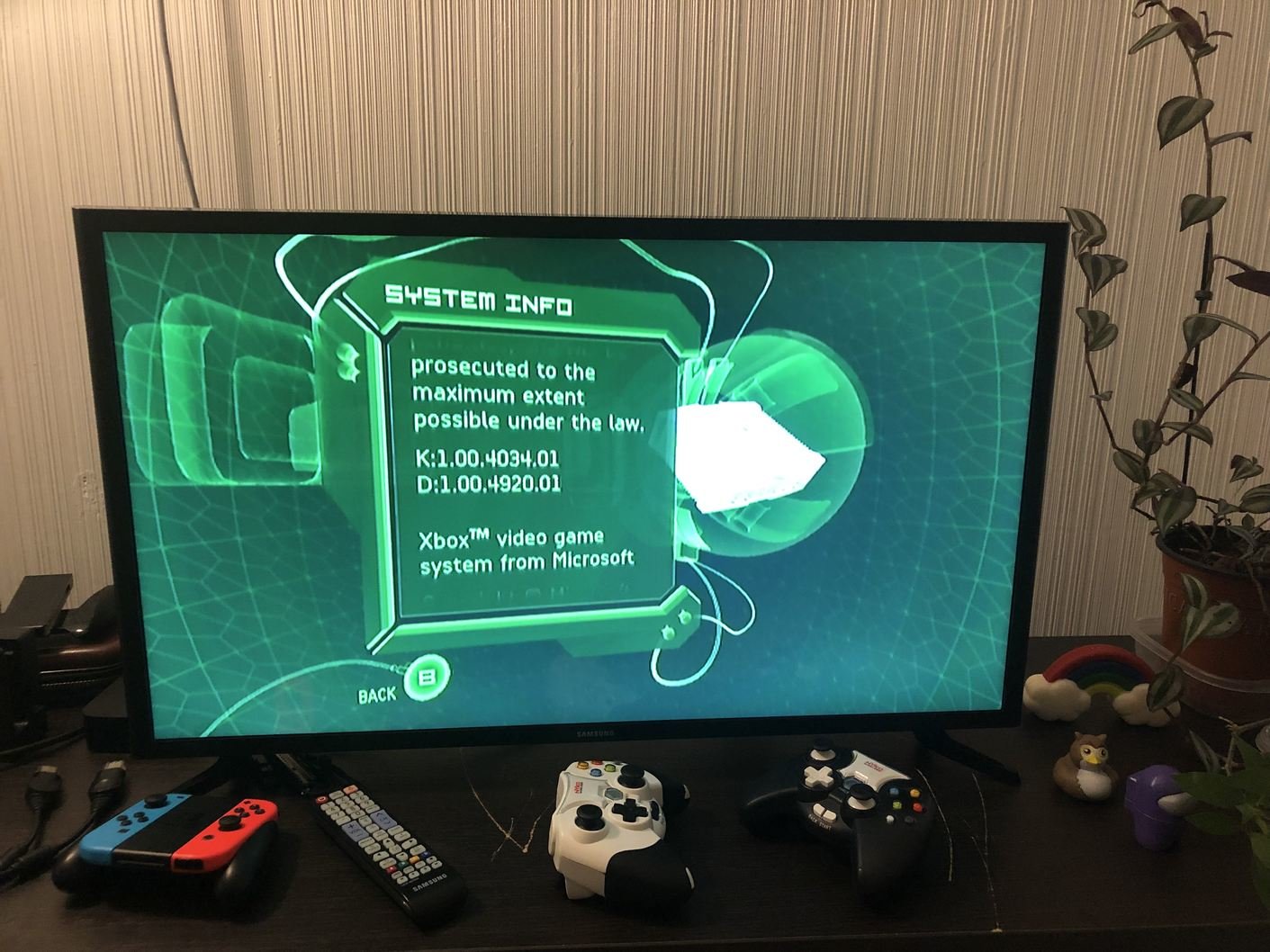

Ah ha, found the source of the info on the font + audio exploit that was posted at biline.ca.

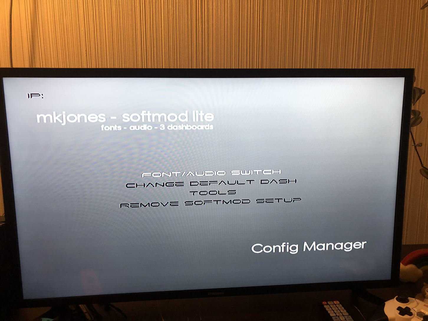

Cool, that seems like the hack alright! Do you still want the C, E and F bios drives, or would that be redundant since the hack is already archived elsewhere? Either way thanks' for all the help.
7 hours ago, KaosEngineer said:
I found a bit of info about old softmods / font exploits that change the Xbox Live tab of the stock 4920 dashboard to Phoenix.
http://www.biline.ca/xbox_ude.htm:
I emboldened the text that mentions the XBOX LIVE to PHOENIX tab change.

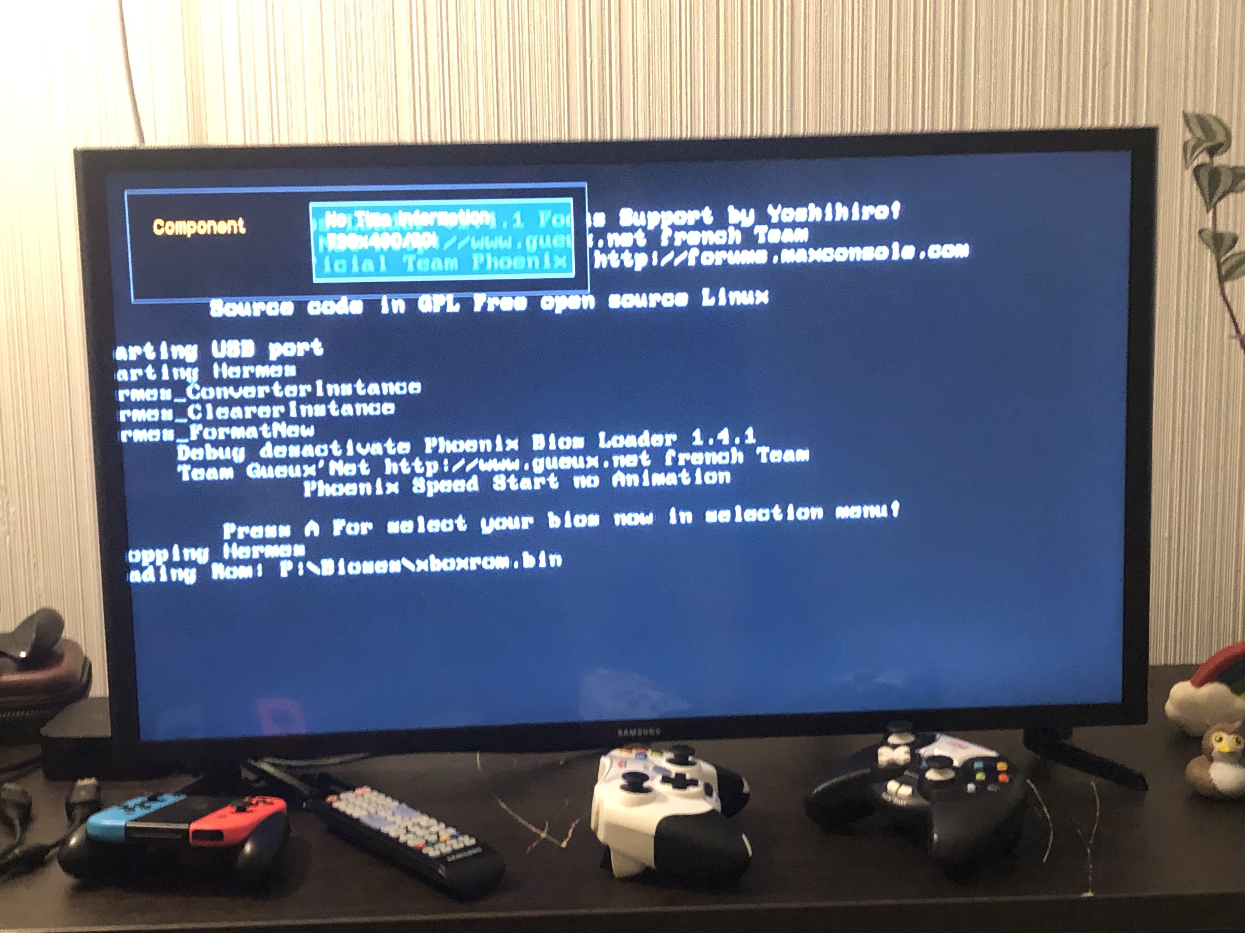

Well that explains the booting / fragging issue then. The clock cap is most certainly dead on this puppy so it goes into a boot loop trying to load the clock screen. It somehow powers through it eventually though. Oh the innocent early modding scene that thought an exploit that relied on the clock cap was viable.
Can you make a backup using FTP to download all the files from the C:\ and E:\ drives as well as the F:\Bioses folder.
Edit: Then, share it. I'm interested in determining how your console is softmodded. (edit 2, 3, 4, ...: Oh, so many typos!)

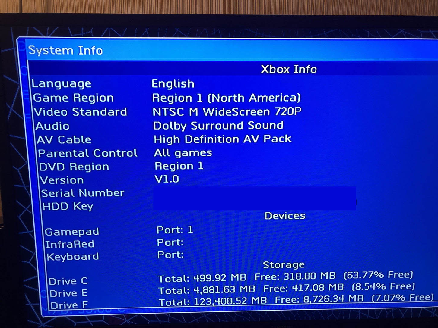

When in UnleashX, press the (Y) button on the controller to display the System Info page.
What is the kernel version of the BFM BIOS that the Phoenix BIOS Loader (PBL) installed?

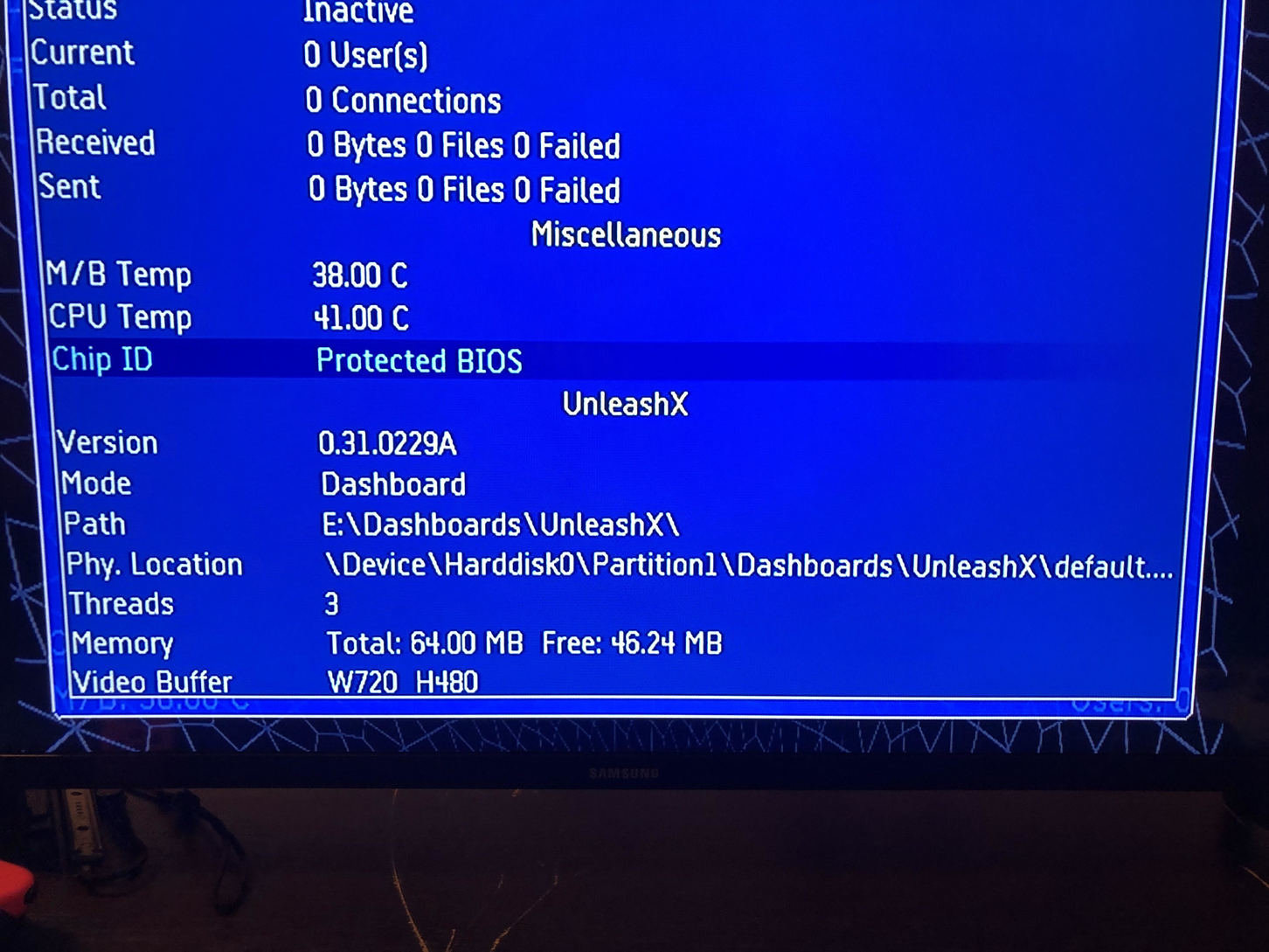

Here's what I got, Looks like the kernel version is absent from this version of UnleashX. I put the dash version just in case that's of any use. I'll ftp over the folders in the morning. I also poked around a bit more and found the softmod menu, Included a pic of that too. Also this is probably a hardware issue but the picture appears to be... wobbling constantaly. I KNOW its not the cables. Its the official Microsoft Component cables & they work absolutely fine on my main XBOX unit. This one introduces a constant slight wobble. I know that's a hardware issue but I just thought I'd throw it out there. One more thing, the PSU appears to be aftermarket since it has the plug for the 1.0 and 1.4 boards (this one is a 1.0)
33 minutes ago, KaosEngineer said:
Hmm, looks like the E drive has a lot of content stored on it - original size 4,895 MBs down to only 417.23 MBs free.
Looks like the original owner loaded it up with emulators and roms. They don't appear to be up to date, but since they off loaded it, they probably didn't use it for a while.
I'll Check the kernel and get some photos
Hello, I recently bought a used OG that was modified by its pervious owner. It appears to be a soft mod.
The Xbox first boots into the stock MS dash, but with the "Xbox Live" tab replaced with "Phoenix"
Selecting it boots into the UnleashX dash.
I like this setup since I think the stock dash is cool, and has a better game saves system than any of the dash big replacements. However, when I first tested it out it was fragging, and the HDD (which was replaced at some point via chimp with a 128gb one) seems to be in poor shape based on the sounds it was making. I am considering on giving it a tsop flash for the sake of keeping it alive, but It would be cool if I could keep the dash replacement.
Any info on this "Phoenix" softmod and its viability as a hardmod dash replacement would be great.

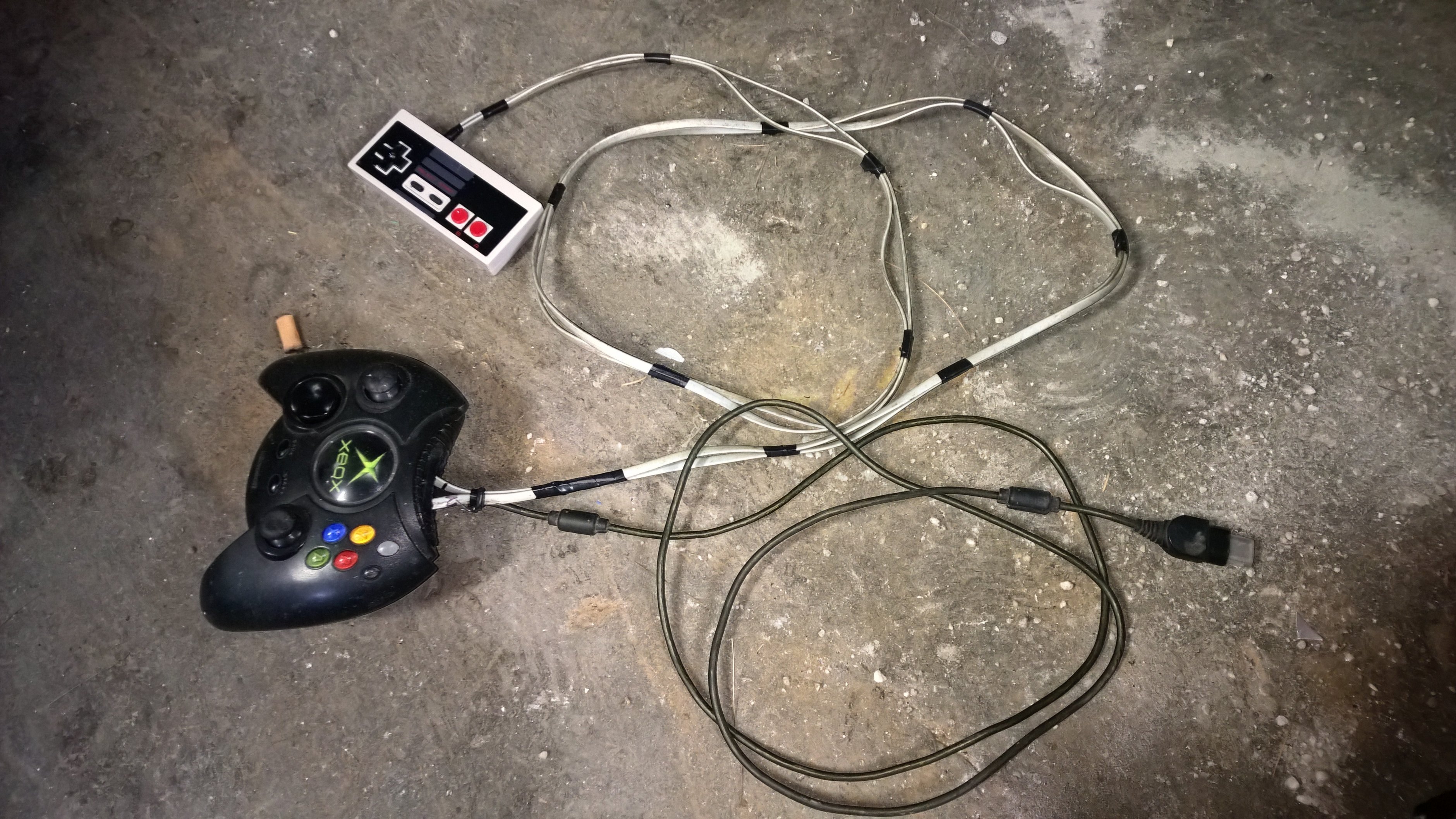

On 11/6/2020 at 8:53 PM, nerdbombing said:
Well, now things are better, well, sort of. Up doesn't trigger any other buttons, but B isn't responding. Mario is just walking around, and won't spit flower-fire balls... GD, wtf??
How dumb am I??!! I need to reset some of the controller mappings in the emulator, cause it defaults using the X button for B and I'm wired the Dukes B button , not X!! hahah, ok, simple fix and viola, mario runs and spits fire balls!!!! YAY!!, but he jumps funny, seems like a latency issue. he's a little delayed...
Ok, last attempt but this time I've attached a regular, non modded Duke, fire up the Xbox and emulator, then switch the non-modded with the NES-hack-job-controller and it's picture perfect. I'm playing NES games, with an NES controller, on my modded Xbox. The concept is proven, works, and is up my alley. Cost to complete= $0 for those with wire, solder supplies, and spare controllers. I priced out the controllers at the local game-spot equiv. and for under $20 I could get both controllers to hack apart.
What can I improve? Find 9 or 10 wire so I don't have 2 wires run like some mad max sex toy. Then I could even put connectors on the Duke, and pigtail from NES, SNES, or Sega controller to easily switch them out. My project is only an Xbox/NES controller.
This fills my needs 100% though. I dont want to use the NES controller on any other device, I dont mind the wires, I still have an xbox controller too, the price was right, time to complete was less then ordering something and waiting for it to be shipped and still might not have worked, so yeah, I'm happy. I hope someone else likes it too. I'm not sure I'll put too much more time into this other then a few tweaks on V1.1 (so I can play 2 play on NES emulator). However, I'll jump on a smooth riding bandwagon to the more technical endpoint if someone else get's to making this better with a Arduino or other angle of attack. And thank you all for your input and help!!! and please don't be offended if I didnt take your advice this time as I still value it and may come back to it later!!
Just looking at that picture makes me think its a prototype for a memory card slot based series of retro controlers that you daisy chain through the Xbox controllers like the Panasonic 3DO. Awesome stuff.
