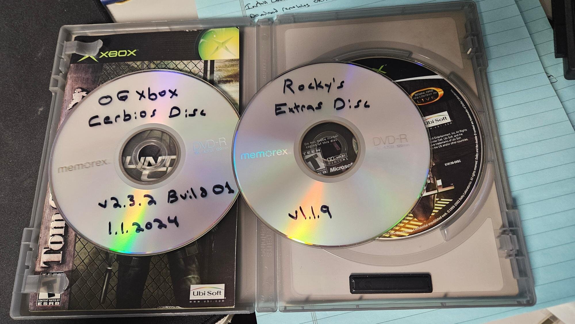

Hi everyone, new to the scene and the OG Xbox in general (had a 360 and One for many years). Bought an OG Xbox a few years ago for cheap to play some og Xbox exclusive games that are either not backwards compatible or are buggy on the 360's software emulation. I got as far as softmodding it to Rocky's v1.1.6 (this was in end of 2019 when I did this). Then I burnt the extras disc and my Xbox wouldn't read it. Then left the Xbox as is and did some other hobbies and life happened and put the Xbox in a closet for four years.
Recently pulled it out and want to continue where I left off. My main goal is to upgrade the HDD to copy my games to the hard drive and play off it. To do this I need the extras disc to get Chimp onto my xbox. My Samsung drive, while sometimes is reluctant to eject the disc unless there is a disc inside, reads the games just fine. However when I burn the extras disc using Img burn (4x speed is the lowest I can go), using either the iso from Rocky's GitHub or the "Build XISO"bat file, nothing seems to work. So discs I tried where Staples CD-RW and Staples DVD-RW. Both of these where pretty scratches. So then I tried three times with Verbatim CD-Rs, flawless discs brand new no scratches, the Xbox still will not read the disc. Again, it's the Samsung Drive so it should be able to read CD-R.
My next step is to buy a Verbatim DVD-R, Staples has a pack of 5 for $5.99. If that doesn't work the only way to do it would be I guess to FTP. Was wondering if a USB would work as well. Lost the generic 4gb 2.0.usb I used four years ago to softmod but ordered another one from eBay should arrive within a couple of weeks. But why is the extras disc giving me so much trouble? Can anyone chime in what I could be doing wrong?

Hi KaosEngineer, using a Verbatim DVD-R fixed the problem. The Xbox could not read the Verbatim CD-Rs or the Staples CD-RWs and Staples DVD-RW a though both Staples formats have heavily scratched discs. Tested my Xbox hard drive and it can ready (and copied to HDD) all my Xbox games as well as it can read audio (original) CDs.
