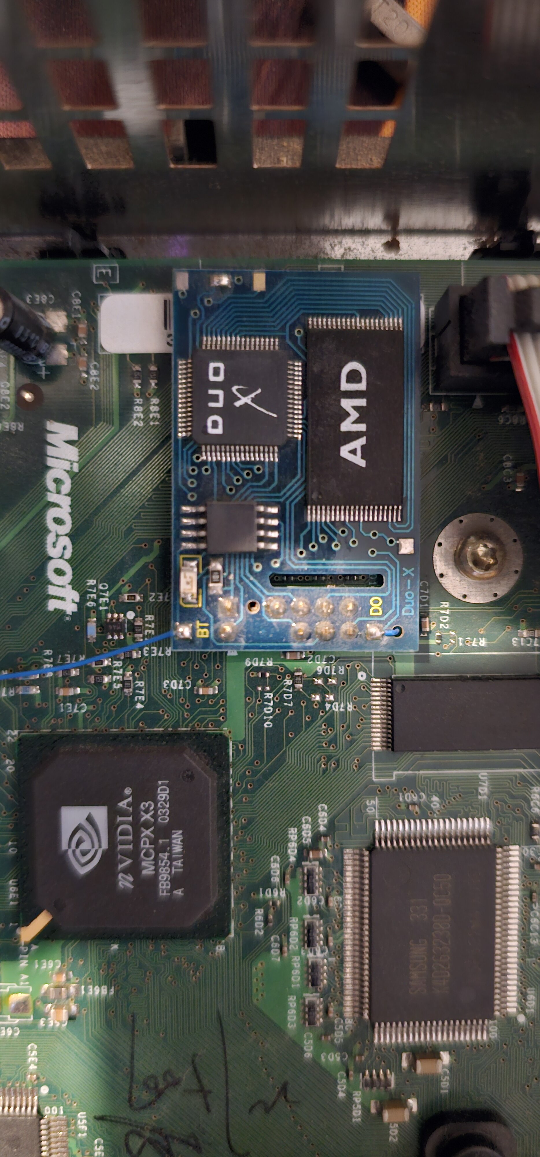

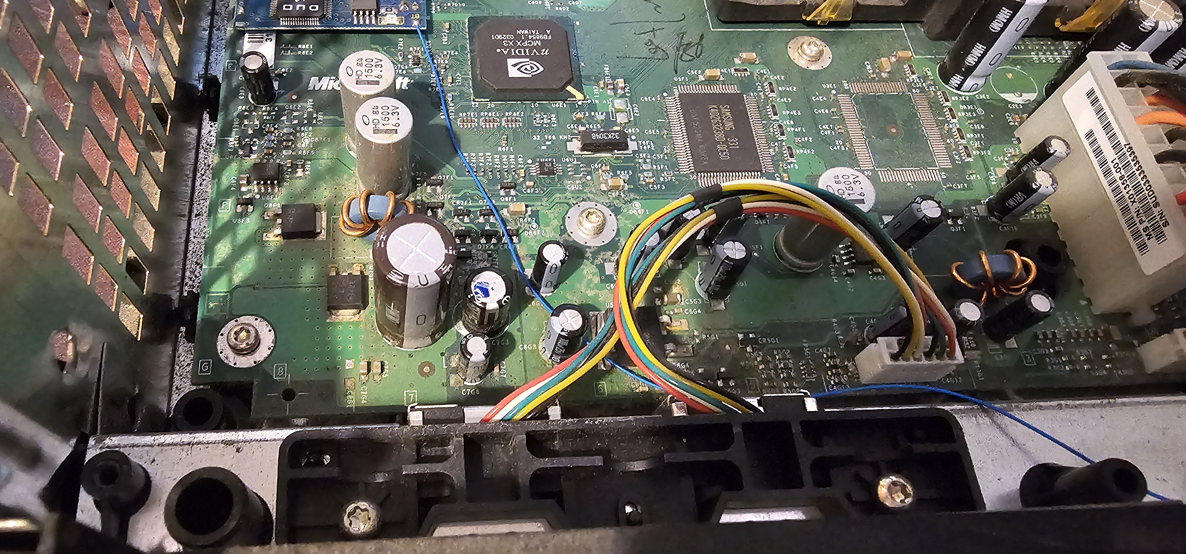

Hello,
I have had a1.4 xbox with a duox modchip (v1) and I'm a little confused about how I can flash it. I bought this xbox pre chipped 15+ years ago and I've never touched anything past keeping exox dashboard updated. I took it out of storage after a good few years, I would guess I've not used it bar the odd nostalgic game session (It's part of a setup in my living room with an OG xbox a 360 and a series x on shelves) in around 10 years so I have no idea what the latest best things are.
Also the xbox came with an 80GB hard drive installed.
I have purchased a xbox-HDMI adapter (powered by usb) because my TV has 3 hdmi ports and that's it. literally nothing else. This works.
I have an issue with my dvd drive in that the band need replacing, can't get more for a another 2 weeks. In the meantime is it possible to flash the chip without a disc? some places seem to say I must have a dvd and others allude to not needing a disk.
I've been researching this for hours and just decided to ask on here. it works ok but I didn't flash the bios so I have never done it before. I was looking at increasing the capacity further but may need a bios flash. in avox settings the BIOS is unknown.
So in short, what is the "goto" Bios and dashboard nowadays? Is it possible to do without a DVD drive? Could I do it by stripping the xbox DVD drive putting a disk in and reassemble? If I desperately need to? Bit drastic but I can't do anything for a few weeks.
A bit of a bonus question. I had a game of FIFA 2003 last night and it played strange. Like it was sped up. Best description is like an emulator running at 1.5-2x speed. Some games don't boot. I don't know where to start with testing it. If anyone has an idea I'd appreciate it.
EDIT: So I've backed up using evox. FTPd it to my PC. I noticed a bios folder. It has 3 files "EvolutionX M7 Bios.nfo" "EvoxM7_ef.bin" and "EvoxM7.bin" I can guess which previous version was. Can I just replace them and flash latest bios from evox launcher then?
Duox modchip on v1.4 xbox - got a few issues plus how do I flash?
