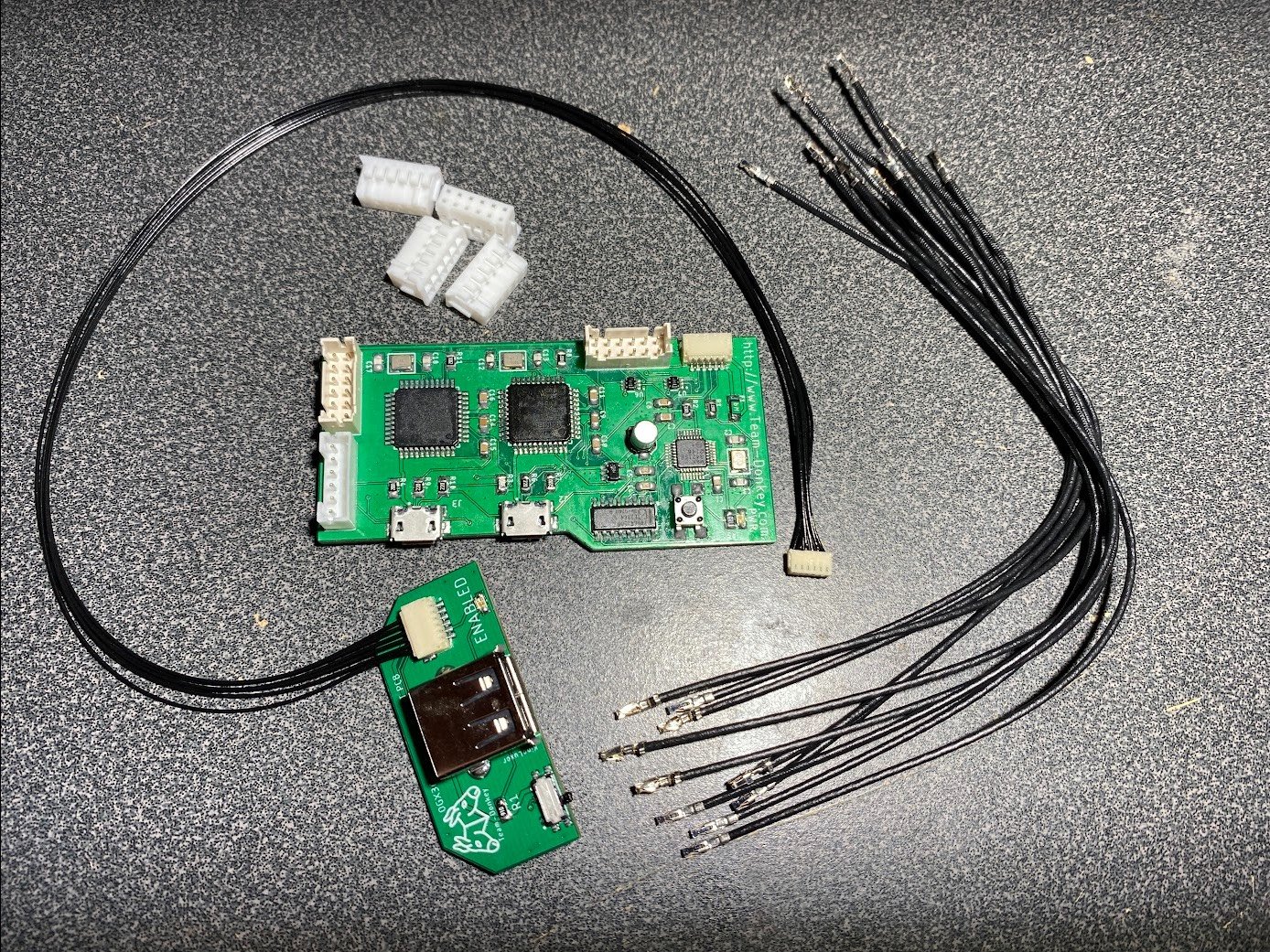

So the 2CH appears to be working great after I reversed the position for the LED on the mini board. I also mistakenly had the 12 pin JST cables reversed (from controller ports to ogx and ogx to xbox). Apparently wired controllers will still function as expected in bypass mode even with these cables reversed, however the wireless controllers will not work. In any case this means I can move on to the next project. The 4CH is on my todo list. I have the PCBs ready but I likely need to stock up on more components. I definitely cooked one or two ATMEGA32U4's from when I tried to burn the boot loader's with my bad breadboard setup...

Excellent! Great Work! In the meantime I had a look at the schematic for the 2CH and realized that I probably soldered the LED on the mini-board in the wrong orientation. Having flipped it around now gives the me the expected green light when the enable switch is flipped. Apparently I don't have enough experience to figure out which way a diode needs to point unless its explicitly spelled out on the pcb itself lol. I'll reconnect this back into the console in the morning to see if everything will work. Per the schematic it also appears that the extra 6 pin JST cable port is intended "to be used for future expansion board". I am not that good at reading schematics but I think it might be a method to daisy chain two of the 2CH units.

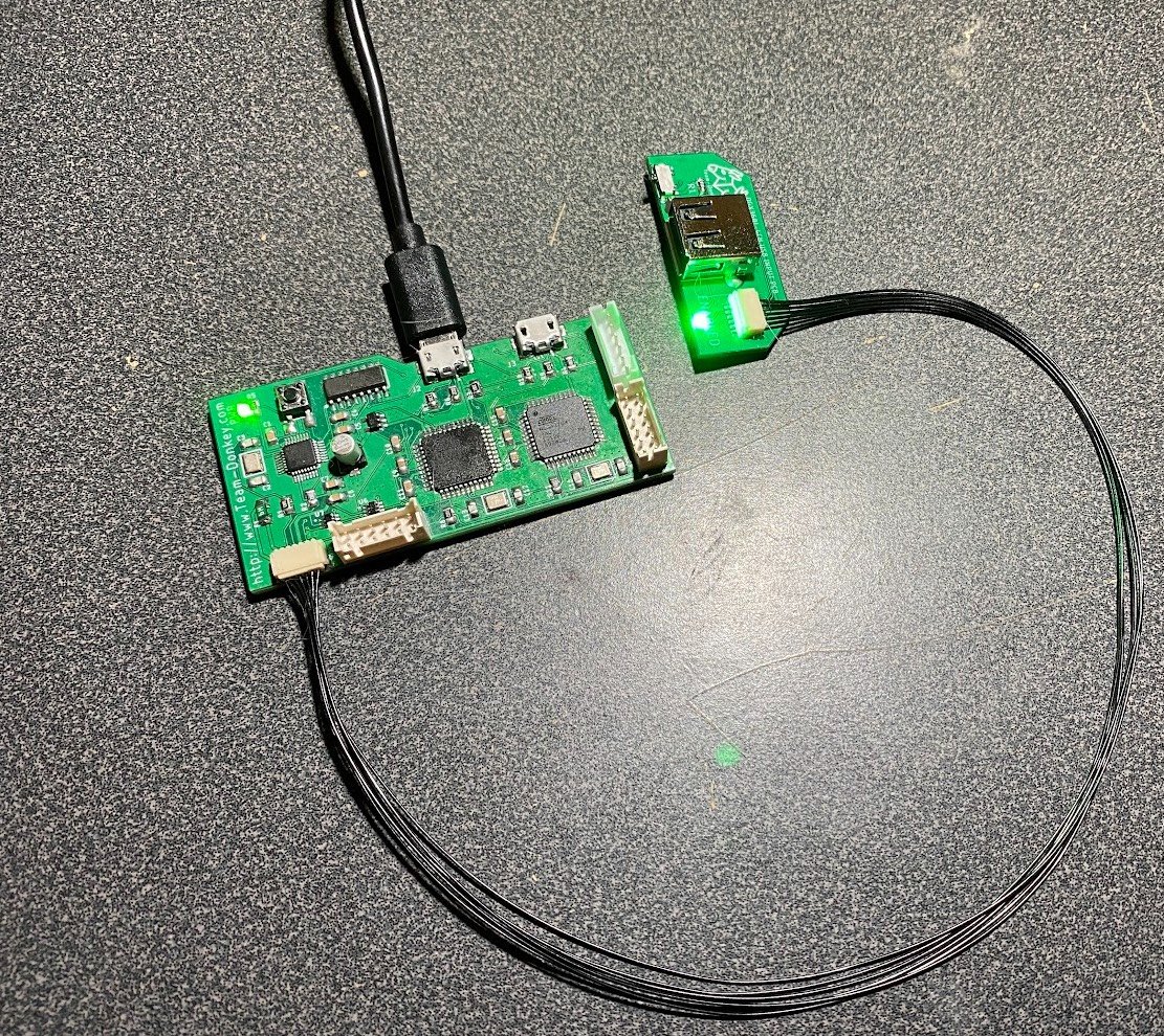

I think I figured out how to make the JST jumper cable. It was not anything special like I had previously imagined. Right now with the 2CH hooked up to the console I am able to get it working in bypass (i.e. flipping the micro switch to allow wired controllers to communicate to the console). In this mode the wired controllers (as connected directly to the console) work as expected. Beyond that however I am not getting much luck in getting the wireless mode to work. I am testing with a known working 360 wireless receiver however the green "enabled" LED on the mini board with the microswitch does not turn on regardless of what I do. The wireless controllers are pairing properly to the wireless receiver however manipulating the buttons on the controller has no affect on the console (this is with the microswitch set to either position).
To troubleshoot further I flashed Ryzee's debug firmware to the master Atmega32u4 and all the tests passed. This also confirms that the 2CH board can see and communicate properly with the wireless receiver.
So at this point I am stuck and unsure of what to do...
EDIT: I also have a 6 pin JST cable port on the 2CH that is not connected to anything. I have not yet figured out what this is for.

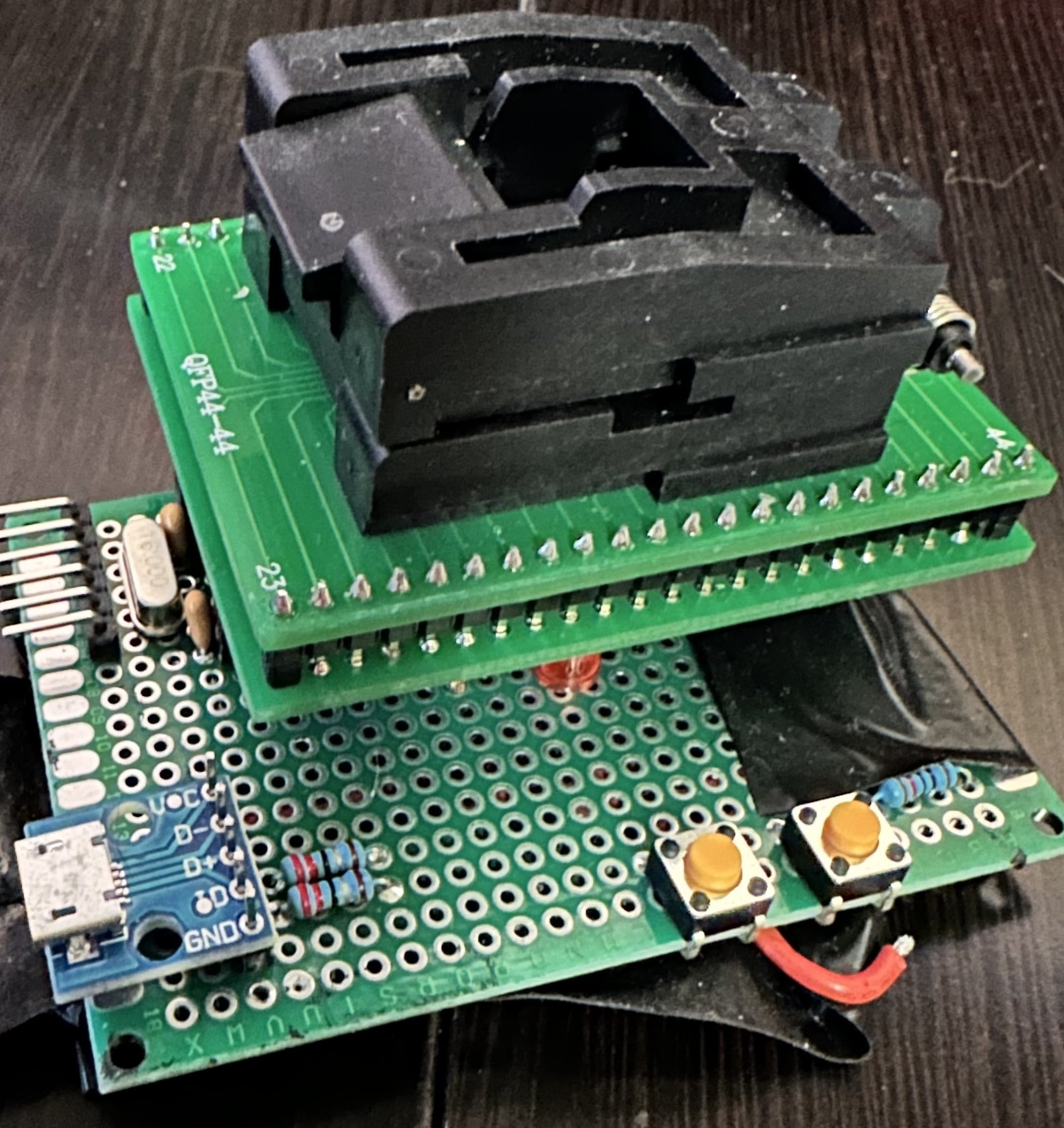

I took another crack at setting up the clamshell socket for burning the bootloader and thankfully this time it works. Like suspected my wiring was way off because I relied on the pin markings on the clamshell for how I should land my wires. Next step for me will be to start soldering the smd components for the 2CH.

3 hours ago, Dtomcat18 said:
Spacing inside to too large and pins on chip too short so one side can make contact… other side falls through
pins spacing is just over 12 mm (barely) and tip to tip pin spacing on atmega is 12mmx12mm.
That's weird. This is the one I bought and the pins appear to align properly: https://www.ebay.com/itm/383556932163
I looked for the test socket based on the package type for the ATMEGA32U4 which appears to be 44TQFP...
I don't understand. The clamshell adapter is too large? In what way?

1 hour ago, Dtomcat18 said:
Did you ever check the pins. Looks like same adapter I used and I bet the pins are off
Thank you for the reminder. I just beeped out a handful right now with a multimeter and its exactly like you suggested. The numbering for the pins on the chip and the numbering for the pins on the adapter are completely different. What a mess. Now I see why you designed your PCB to mate with the clamshell directly.

On 9/18/2022 at 3:37 AM, Dtomcat18 said:
Just thought of something. A lot of these clamshell adapters have messed up pin numbering. So chip pin one is like pin 5 or 6 on my adapter. Did you account for this? That may be your issue
Yikes, I never considered that as a possibility. I guess I will have to check everything with a multimeter. Thank you for the heads up.

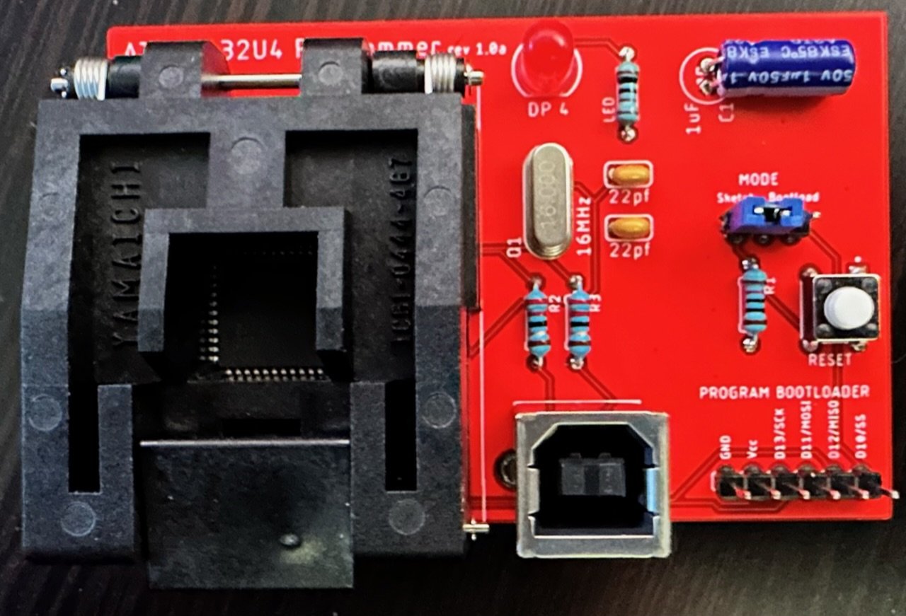

Some documentation would be great. The details on making the internal 2CH/4CH are pretty slim. I started the process of making the 2CH however I hit a snag with burning the boot loaders onto the Atmega32u4's.
I am curious how you are burning the boot loaders in your setup. My understanding is that you could transplant the 32u4's from existing Arduino's or you can use a clamshell adapter/ breadboard setup to program individual 32u4's on their own.
I am using these two pages as a reference:
https://murchlabs.com/monday-experiment-bootloading-an-atmega32u4-with-arduino/
https://electronut.in/bootloader-atmega32u4/
The main difference with my setup is that I am using the clamshell adapter instead of a breakout board. Here is a video of similar situation for a 328p:

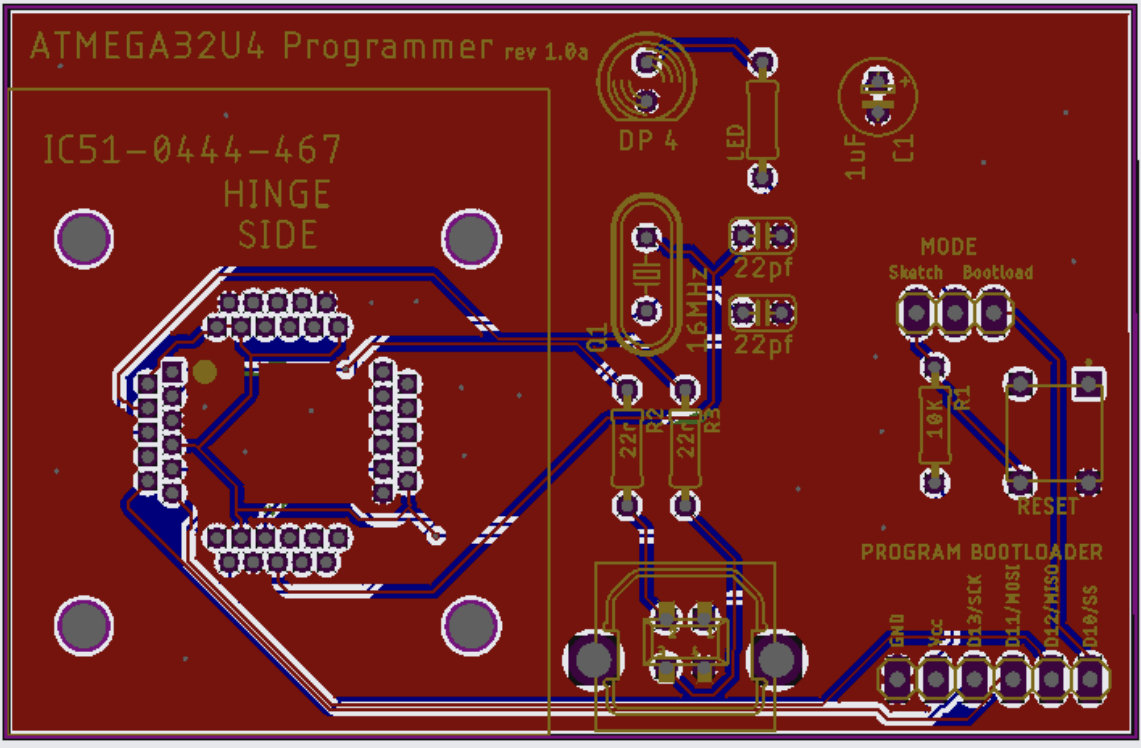

Thanks again for making the gerbers for this board available. I finally went ahead and placed an order for some pcbs so I can have one of these nice programming setups for my collection. This will also let me free up my breadboards for other projects.
Once complete I think I will start looking into making a 4CHi for my collection as well.
