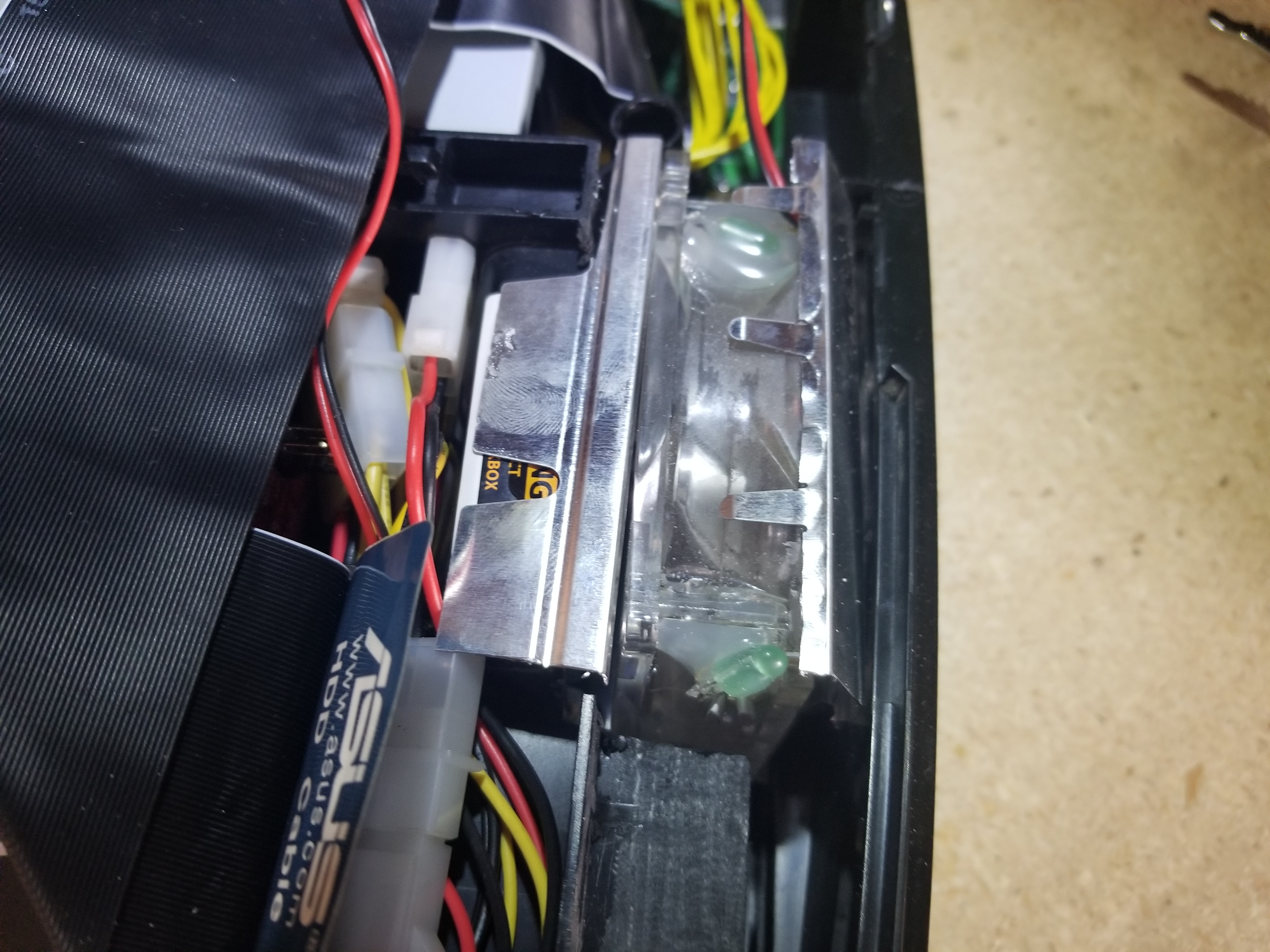

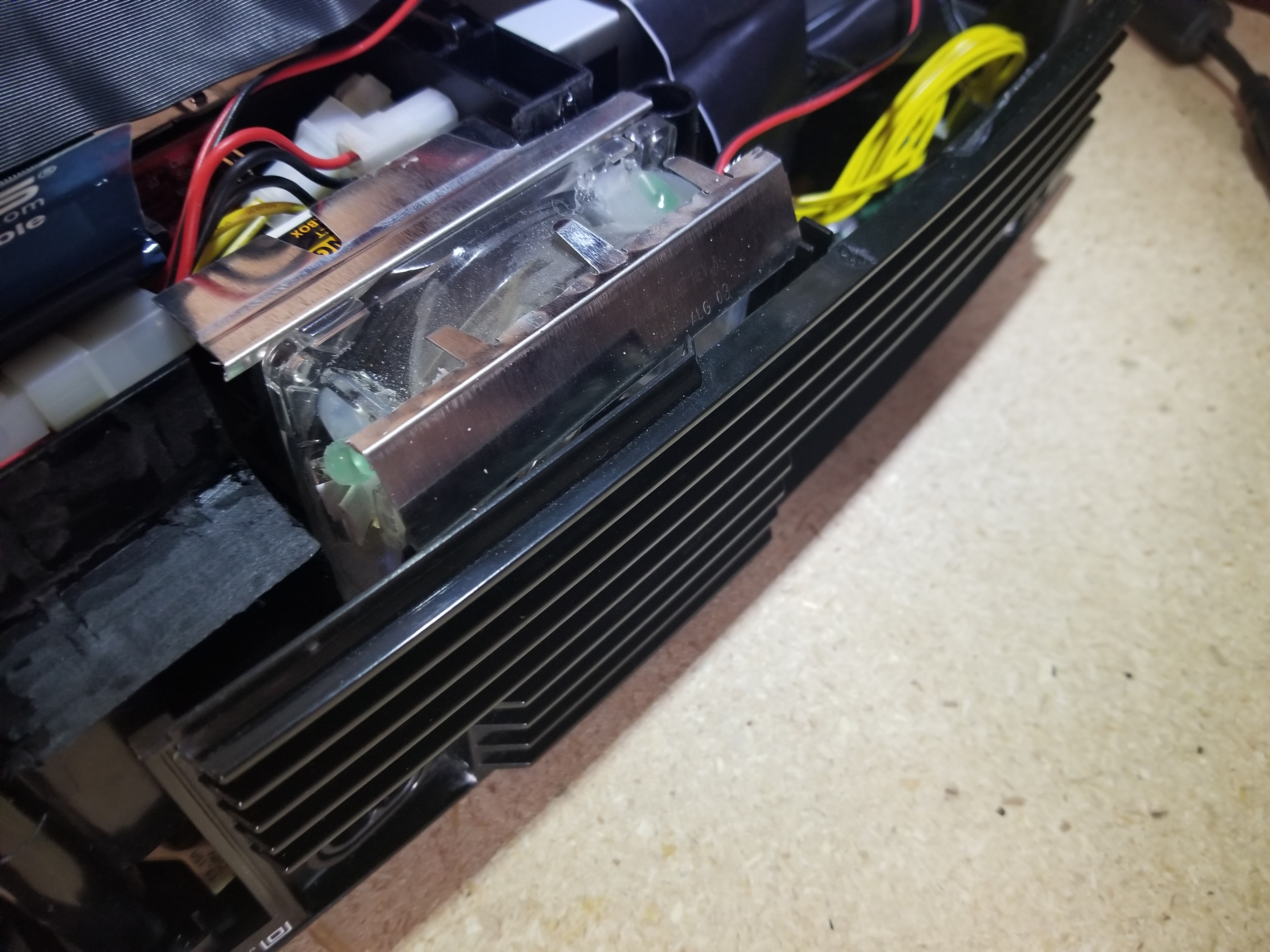

So I have put in an 80mm fan, did my best to shroud it to the hard drive caddy for best static pressure, and have redone the thermal paste with Arctic MX-4. But, I am still seeing around 60c temps just sitting at the dashboard while doing FTP transfers.
What are normal idle and load temps for an OG?
And how can I help the cooling even more?
I don't know how hot it should run but, I know if it were a PC I would want CPU temps below 50 at load. That may be unrealistic in the situation of the Xbox because I build "higher" performance PCs.
Edit: I have connected the fan via molex to in theory have it running max. Before this fan, I used a 3pin but changing it to anything higher that 2x in system settings it would stop spinning.

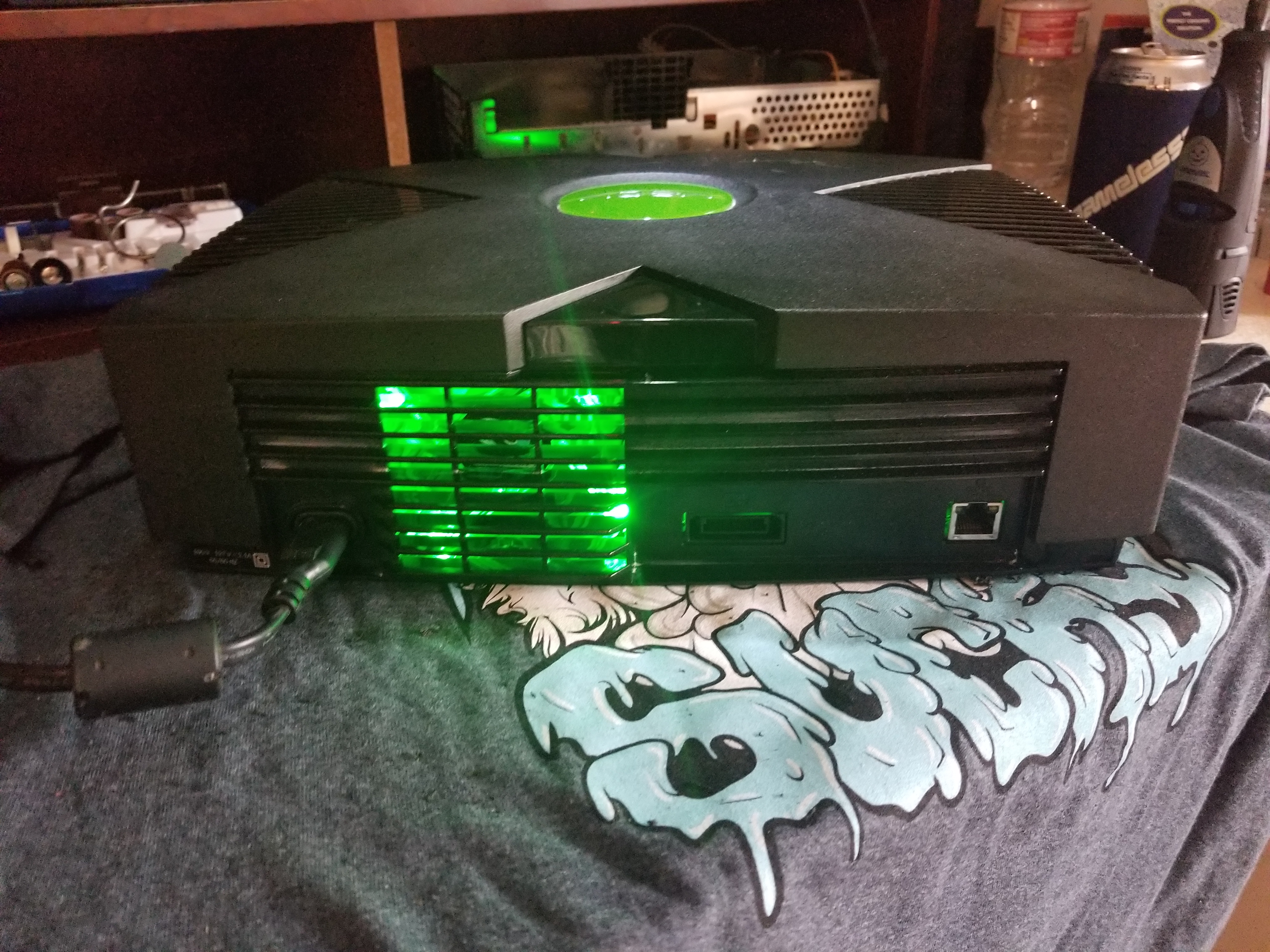

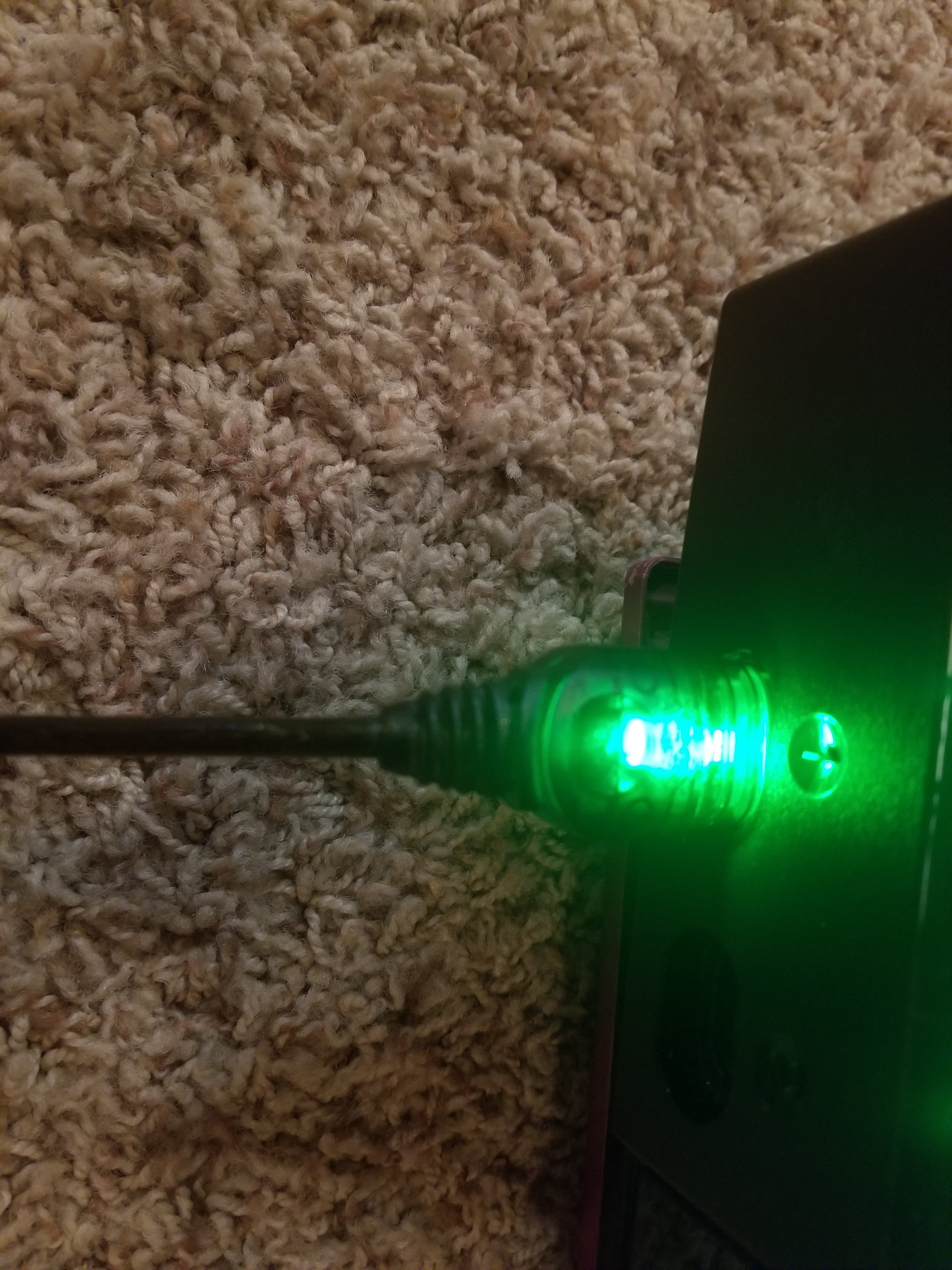

nice LED mods man. i always wanted to be a part of everquest, but at the time was just too busy and theres no way im starting now.... lol. the xbox is alot of fun. even if you dont play the games. a ton of resources out there, alot of it is dated and fragmented. but sites like these are finding ways to string it back together.
Thanks, LEDs are cheap figured id give it a shot.
Yeah EQ takes alot, I don't even want to see my characters online time because its probably close to 2 years.

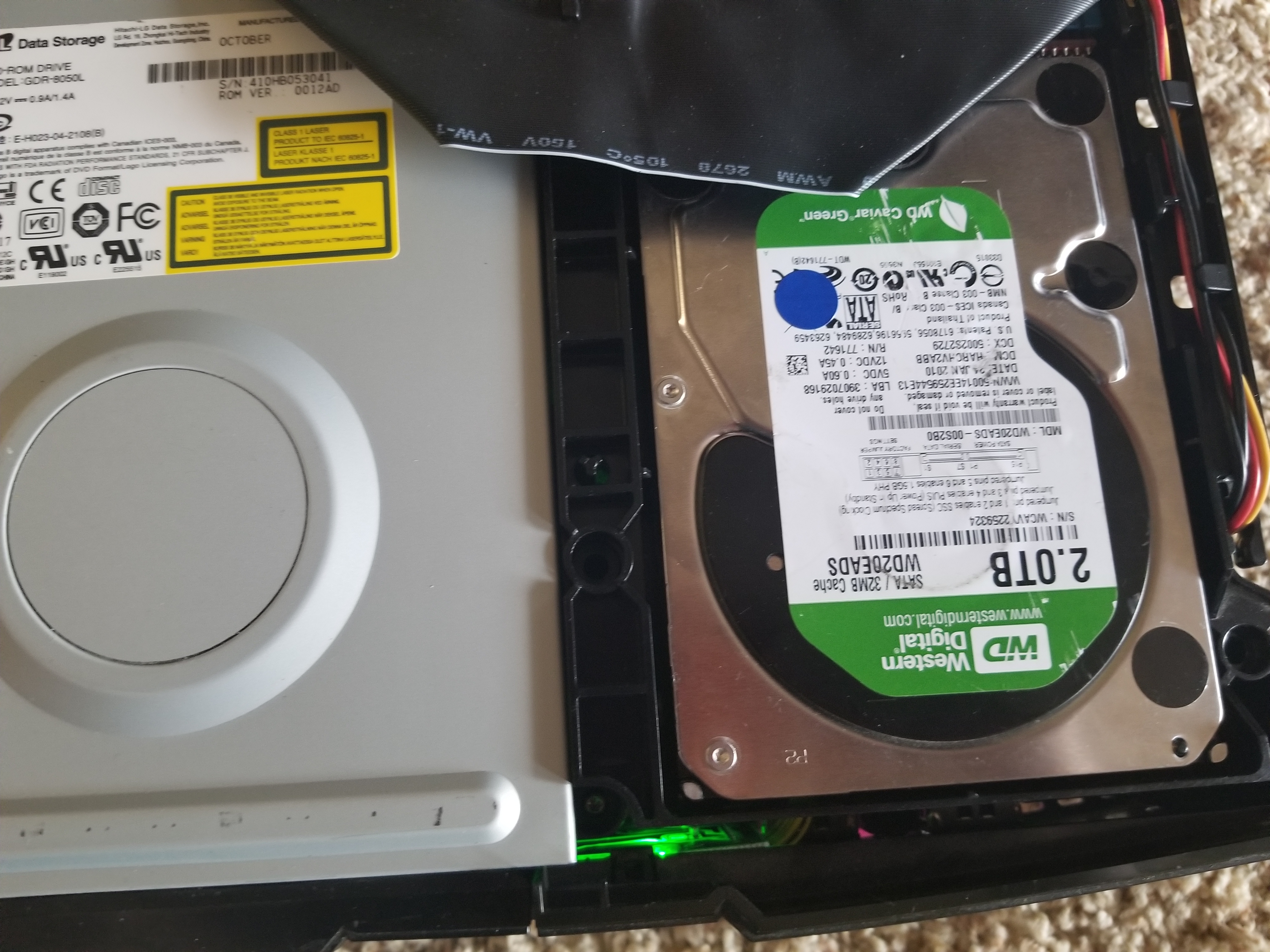

13 minutes ago, Forlorn Penguin said:Nice. That's a Hitachi DVD drive in the third pic. Those are uncommon.
For sure, TSOP flash all of your Xboxes though. Or chip them, if they're a 1.6. Make sure you also remove the clock capacitor from all of your 1.0-1.5 Xboxes, because they'll die if you don't.
I didn't realize that. I just grabbed it from another system as the Thompson that was in it was being problematic.

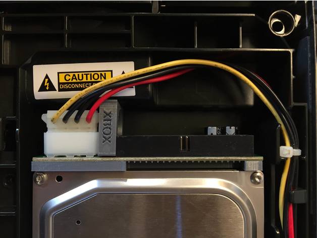

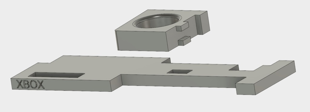

I have kept an eye on this topic as I would rather save a few bucks on the "mass production" machines I build and use the cheap adapter. And at this point I am not worried about failure and in these use cases, not worried about performance either. But, I don't want to lather it up with liquid electrical tape as thats just not good form to me.
So, here is my discovery. I stumbled this design and wondered why i hadn't thought of this before.
SATA_IDE_Xbox_adapter.zip
