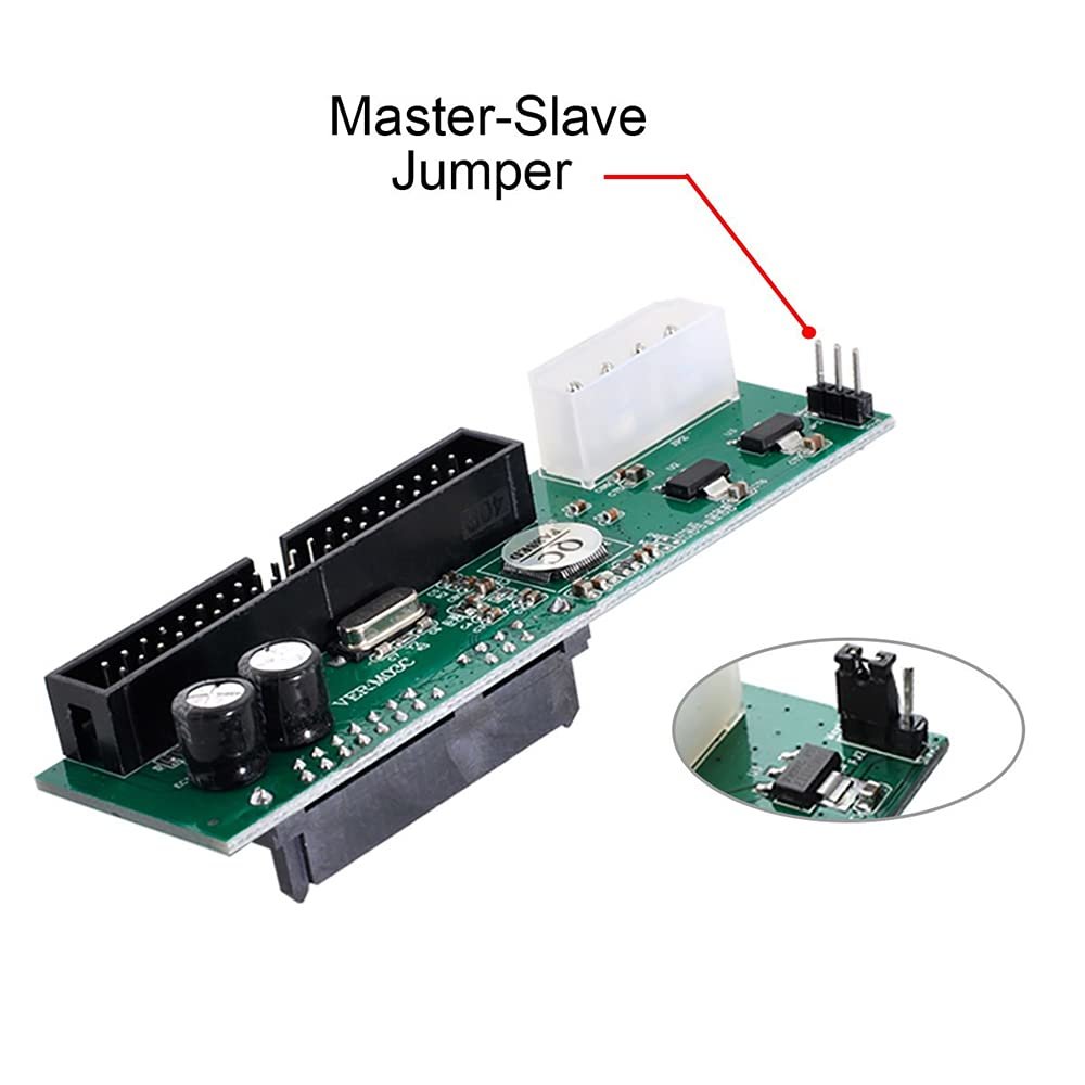

SS_Dave Posted February 12 Report Share Posted February 12 3 hours ago, Lexieye said: ; Drive Setup ; 0 = HDD & DVD, 1 = HDD & No DVD (Legacy Mode), 2 = HDD & No DVD (Modern Mode), 3 = Dual HDD DriveSetup = 2 Drive setup 2 is no DVD drive at all did you try Drivesetup = 0 Is you HDD set to master? What model is your DVD drive? What brand of Sta2Ide adaptor are you using? Are you using a 80 wire IDE cable? I would also set the FanSpeed = 20 or 30 Cheers SS Dave Soft modding is like masturbating, It gets the job done but it's nothing like the real thing. Quote Link to comment Share on other sites More sharing options...

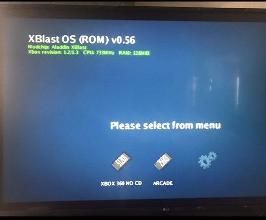

Lexieye Posted February 13 Author Report Share Posted February 13 (edited) thank you for explaining set the FanSpeed = 20 or 30 I have a 1.2/3 2003 NTSU XBox 128mb RAM upgrade jaffar modchip XBlast OS with 2 banks B1_256k IND_BIOS.5003.06.bin (XBMC4GAMERS) B2_512k CERBIOS_V2.21 BETA (XBMC ORIGINS) 1TB SEGATE 3.5 SATA (master dive is locked and EPROM backed up to modchip) 80 wire IDE upgrade cable SAMSUNG DVD drive that I modded to have a Perspex clear lid. There was a problem when the case was fully screwed-down. It put pressure on the tray making it force-eject! so I had to remove the metal bottom of the DVD drive and put a Raspberry Pi heat sink on the DVD drive conductor-pad Edited February 13 by Lexieye Quote Link to comment Share on other sites More sharing options...
greatcornholio Posted February 14 Report Share Posted February 14 SS_Dave is asking about your ide to sata adapter and if its set to master Quote Link to comment Share on other sites More sharing options...

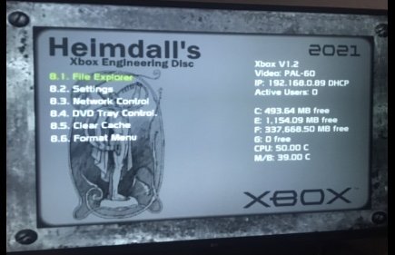

Lexieye Posted February 14 Author Report Share Posted February 14 (edited) Back to the original post CERBIOS will try and boot from a CD if there is one inserted at boot. This means if it’s a game or music CD then nothing happens! The screen stays blank (BLACK)! It’s almost like CERBIOS is acting like the CD is an actual OS? If I HARD-REBOOT without a CD in the tray it boots in seconds to XBMC….. if a CD is in the tray then NOTHING happens! It dose not try and load the CD. I have completely removed the CD drive with DriveSetup = 2 & i can use the other OS bank if I want to use the CD drive. the IDE/SATA_CONVERTER is set to Master. I haven’t touched it back from the original soft mod days Edited February 14 by Lexieye Quote Link to comment Share on other sites More sharing options...
Lexieye Posted February 14 Author Report Share Posted February 14 Quote Link to comment Share on other sites More sharing options...
Lexieye Posted February 14 Author Report Share Posted February 14 11 hours ago, greatcornholio said: SS_Dave is asking about your ide to sata adapter and if its set to master That is my IDE/SATA_converter Quote Link to comment Share on other sites More sharing options...

Lexieye Posted February 16 Author Report Share Posted February 16 CERBIOS will see a disc in the tray as an OS if inserted at boot. Tested: So buy changing the bios to DriveSetup = 2 and leaving a HEXEN disc in the tray at boot, then CERBIOS will load the UnLeash X on the CD and booted straight to HEIMDALL’s ENGINEERING DISC I DONT expect Cerbios to be an OS I expect XBlast-OS to be a light-weight operating system. Using XBlast you can choose the bios you would like to use at boot. Obviously CERBIOS has to have a path to boot the desired dash as described in my config.txt DashPath1 =\Device\Harddisk0\Partition1\Applications\Xbmc\default.xbe I have 150 XBox games & 4000 retro games. I have multiple dashboards installed but have setup CERBIOS to boot XBMC & IND to boot XBMC4GAMERS This whole thing is not a big deal anymore. And just to leave the tray empty at boot Quote Link to comment Share on other sites More sharing options...
SS_Dave Posted February 16 Report Share Posted February 16 10 hours ago, Lexieye said: CERBIOS will see a disc in the tray as an OS if inserted at boot. Tested: So buy changing the bios to DriveSetup = 2 and leaving a HEXEN disc in the tray at boot, then CERBIOS will load the UnLeash X on the CD and booted straight to HEIMDALL’s ENGINEERING DISC I DONT expect Cerbios to be an OS I expect XBlast-OS to be a light-weight operating system. Using XBlast you can choose the bios you would like to use at boot. Obviously CERBIOS has to have a path to boot the desired dash as described in my config.txt DashPath1 =\Device\Harddisk0\Partition1\Applications\Xbmc\default.xbe I have 150 XBox games & 4000 retro games. I have multiple dashboards installed but have setup CERBIOS to boot XBMC & IND to boot XBMC4GAMERS This whole thing is not a big deal anymore. And just to leave the tray empty at boot That sounds like a software setting in Unleash X Here is an extract of the config.xml file for unleash <Preference> <Games AutoLaunch="No"></Games> <DVD AutoLaunch="Yes">F:\Apps\DVDX\default.xbe</DVD> <AudioCD AutoLaunch="Yes">C:\xboxdash.xbe</AudioCD> <Data AutoLaunch="No"></Data> Why would you leave disk in the DVD drive when it's not needed Cheers SS Dave Soft modding is like masturbating, It gets the job done but it's nothing like the real thing. Quote Link to comment Share on other sites More sharing options...
