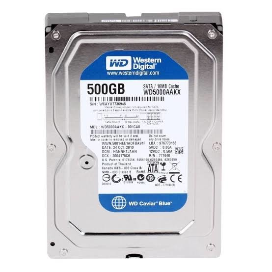

Felipe_Desenvolver Posted January 29 Report Share Posted January 29 (edited) Hello good evening guys, I need to clear a doubt about the Xbox HD and the chip.... Come on, My Xbox 1.6 already has the Pin headers installed, and I want to buy Chipmod PROJECT STELLAR, I just fit it in and ready? Since you have everything done.... and another thing I'm going to buy a HD Western Blue, would that be the right one? Edited January 29 by Felipe_Desenvolver Quote Link to comment Share on other sites More sharing options...
RetroEmulationNation Posted January 30 Report Share Posted January 30 AFAIK any hard disk would be fine. I have a 2TB WD Cavier Blue in my Xbox. And yes, if you already have the pin headers the Project Stellar modchip would just be a drop in replacement for whatever modchip you have. I do not recall if soldering any additional wires are required - you can always check in with Dustin at https://discord.gg/9aammkvj Quote Link to comment Share on other sites More sharing options...

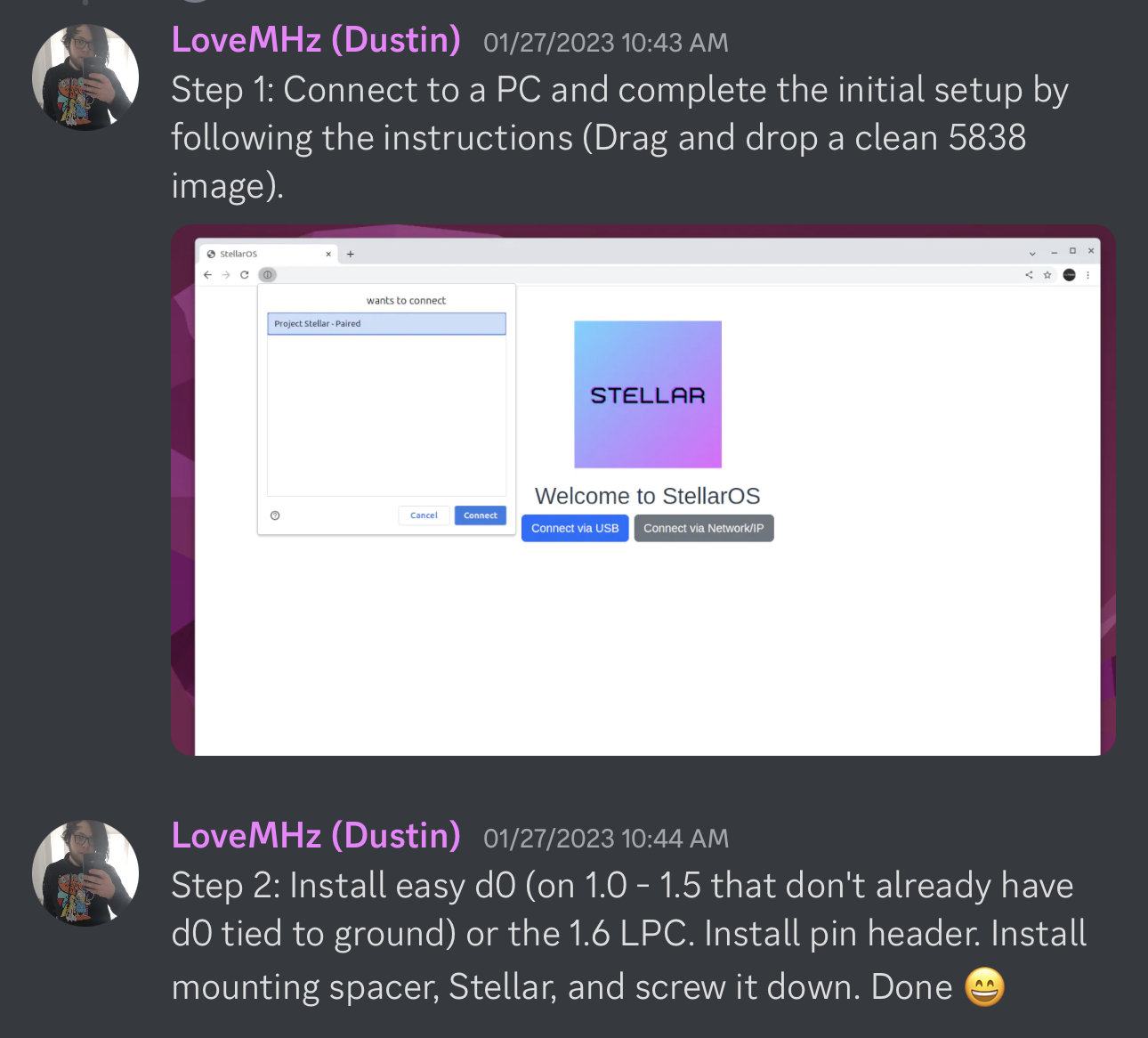

Dtomcat18 Posted January 30 Report Share Posted January 30 Stellar needs resources from the kernal image that can’t be supplied due to copyright laws. Quote Link to comment Share on other sites More sharing options...
Dtomcat18 Posted January 30 Report Share Posted January 30 Quote Link to comment Share on other sites More sharing options...
Dtomcat18 Posted January 30 Report Share Posted January 30 (edited) From that image… appears you can do so from network (but may not be supported at launch) Edited January 30 by Dtomcat18 Quote Link to comment Share on other sites More sharing options...
Felipe_Desenvolver Posted January 30 Author Report Share Posted January 30 1 hora atrás, RetroEmulationNation disse: AFAIK qualquer disco rígido seria bom. Eu tenho um WD Cavier Blue de 2 TB no meu Xbox. E sim, se você já possui os cabeçalhos dos pinos, o modchip do Projeto Stellar seria apenas uma substituição para qualquer modchip que você tenha. Não me lembro se é necessário soldar fios adicionais - você sempre pode verificar com Dustin em https://discord.gg/9aammkvj Does the Sata III Connection work on Xbox? Quote Link to comment Share on other sites More sharing options...
KaosEngineer Posted January 30 Report Share Posted January 30 38 minutes ago, Felipe_Desenvolver said: Does the Sata III Connection work on Xbox? No, not directly, the Xbox has an IDE interface that connects to the hard drive and DVD drive. You need an IDE-to-SATA adapter to connect a SATA drive to the Xbox's IDE interface. Suggested adapters include Startech's IDE2SAT2 or DeLock's 62510. You will also need a 24" long high-speed 80-wire 40-pin IDE cable to use instead of the stock 40-wire 40-pin IDE cable. Quote Link to comment Share on other sites More sharing options...
Felipe_Desenvolver Posted January 30 Author Report Share Posted January 30 (edited) 22 minutes ago, KaosEngineer said: Não, não diretamente, o Xbox tem uma interface IDE que se conecta ao disco rígido e à unidade de DVD. Você precisa de um adaptador IDE para SATA para conectar uma unidade SATA à interface IDE do Xbox. Os adaptadores sugeridos incluem IDE2SAT2 da Startech ou 62510 da DeLock. Você também precisará de um cabo IDE de 40 pinos e 80 fios de alta velocidade de 24" para usar em vez do cabo IDE de 40 pinos e 40 fios padrão. No, okay. these things I have. It's because I'm going to change mine which is a GREEN unit for a blue one and I wanted to know if Sata III (Desktop Harddrive) Blue it's compatible Edited January 30 by Felipe_Desenvolver Quote Link to comment Share on other sites More sharing options...
Felipe_Desenvolver Posted January 30 Author Report Share Posted January 30 1 minute ago, Felipe_Desenvolver said: No, okay. That's Good. It's because I'm going to change mine which is a GREEN unit for a blue one and I wanted to know if Sata III (Desktop Harddrive) Blue works fine Since My GREEN Has Already Gained Error 13 Twice, And To End This I Will Buy The BLUE Quote Link to comment Share on other sites More sharing options...
coldasijs Posted January 30 Report Share Posted January 30 If you only plan to buy 500 gb drive, why not go directly to SSD? Lifetime shouldn’t be a worry, especially since Stellar adds TRIM. Price is the same, but performance is better. 1 Quote Link to comment Share on other sites More sharing options...
KaosEngineer Posted January 30 Report Share Posted January 30 4 hours ago, Felipe_Desenvolver said: Since My GREEN Has Already Gained Error 13 Twice, And To End This I Will Buy The BLUE Are you using an 80-wire 40-pin high-speed IDE cable? If not, doing so fixes many with an error 13 screen that still try to use the stock IDE cable. Also, green drives need to have their green / eco features (IDLE timeout/spindown) disabled. WD Blues are what I last used to upgrade the hard drive in an Xbox - 2TB CMR (Conventional Magnetic Recording) version of the drive with 64KB cache instead of SMR (Shingled Magnetic Recording) version with 256KB cache. 1 Quote Link to comment Share on other sites More sharing options...
Felipe_Desenvolver Posted January 30 Author Report Share Posted January 30 1 hour ago, KaosEngineer said: Você está usando um cabo IDE de alta velocidade de 80 fios e 40 pinos? Caso contrário, isso corrige muitos com uma tela de erro 13 que ainda tenta usar o cabo IDE padrão. Além disso, os drives verdes precisam ter seus recursos verdes/eco (tempo limite/redução de rotação IDLE) desativados. WD Blues é o que usei pela última vez para atualizar o disco rígido em um Xbox - versão CMR (Gravação Magnética Convencional) de 2 TB da unidade com cache de 64 KB em vez da versão SMR (Gravação Magnética Shingled) com cache de 256 KB. Yes, I have the 80-way cable, but I didn't modify the IDLE of the HD, because I'm going to buy a new HD BLUE, and leave the GREEN for my computer Quote Link to comment Share on other sites More sharing options...
Felipe_Desenvolver Posted February 1 Author Report Share Posted February 1 On 30/01/2023 at 04:07, coldasijs said: Se você planeja comprar apenas uma unidade de 500 GB, por que não ir diretamente para o SSD? A vida útil não deve ser uma preocupação, especialmente porque Stellar adiciona TRIM. O preço é o mesmo, mas o desempenho é melhor. Here in Brazil it costs more, an HD found for R$96 while the SSD is on average R$300 1 Quote Link to comment Share on other sites More sharing options...
