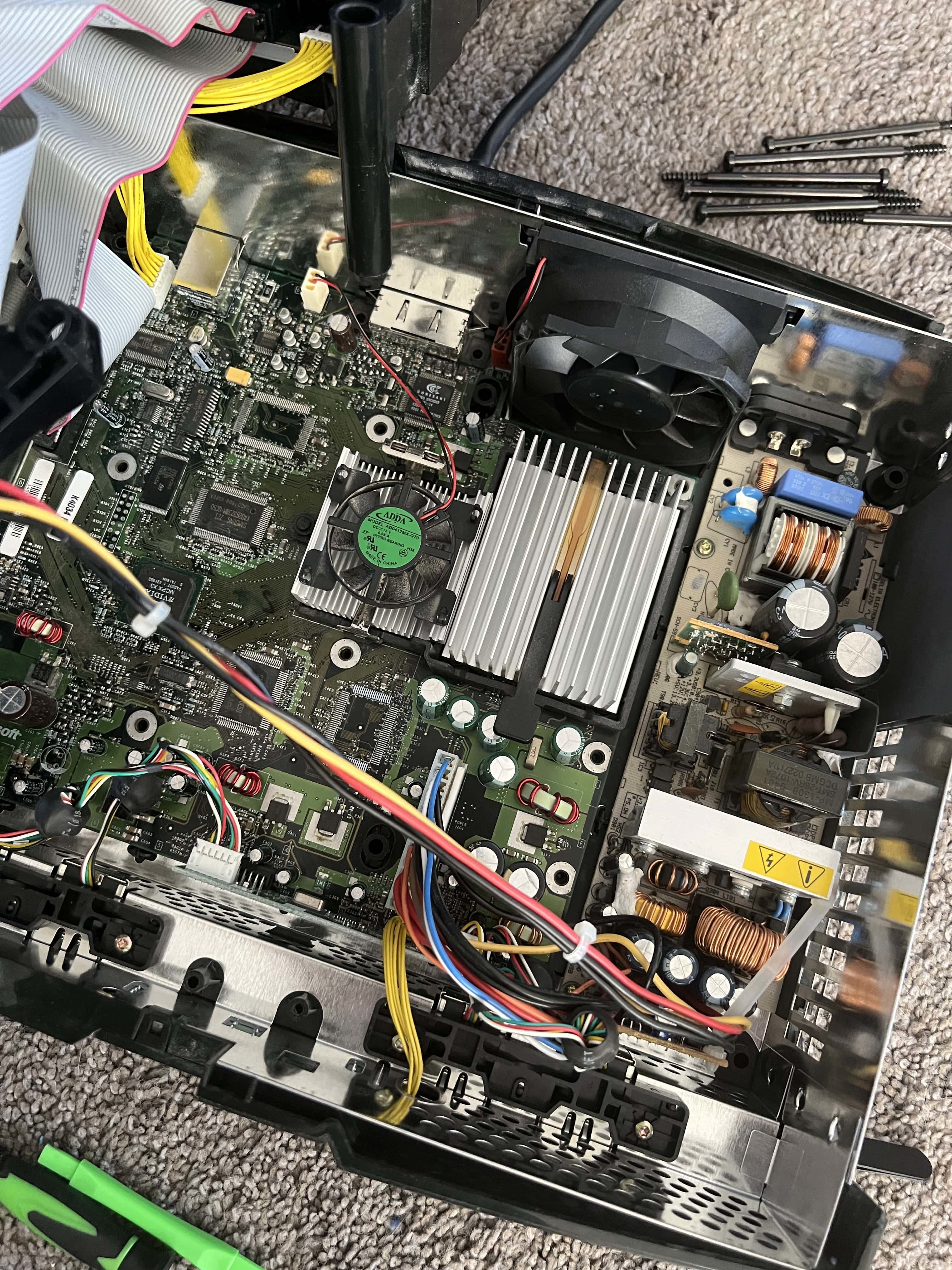

I have a 1.0 Xbox. It’s really close to
the 1.1 change over but pretty sure it’s a 1.0. It was starting up fans and drives originally but still FRAGing. I tuned up the disc drive and I can tell the HDD sounds like it’s not running well, but still no boot at all. I could at least tell that the clock Cap had leaked so I decided to pull that. I got it out nice and clean and cleaned up the area around it but it didn’t look bad. No corrosion on front or back really. I reassembled for testing and now I’m getting the same FRAG but with no boot sounds. No disk spinning, no fans, nothing except the FRAG light. All I did was take out the clock Cap. Thinking about doing a full Cap replace on the board and PSU. Any other advice or things to test first?
At this stage don't recap it until you get it booting to a dash
What happens if you power on with out the two drives connected?
On the version 1.0 it may not show any error code on the screen but it may be frashing the LED slightly different patterns
