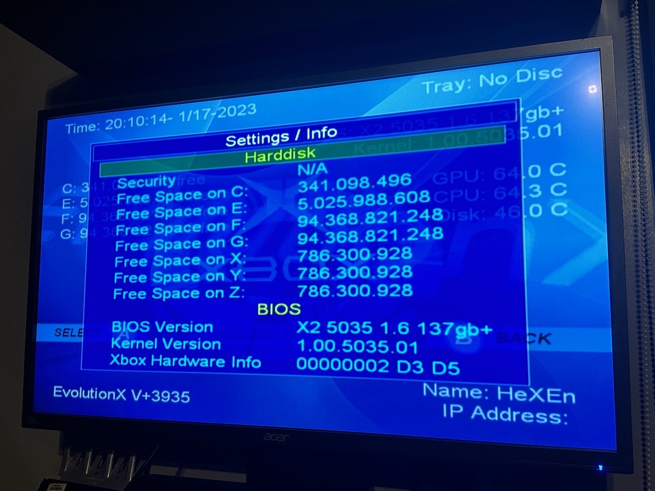

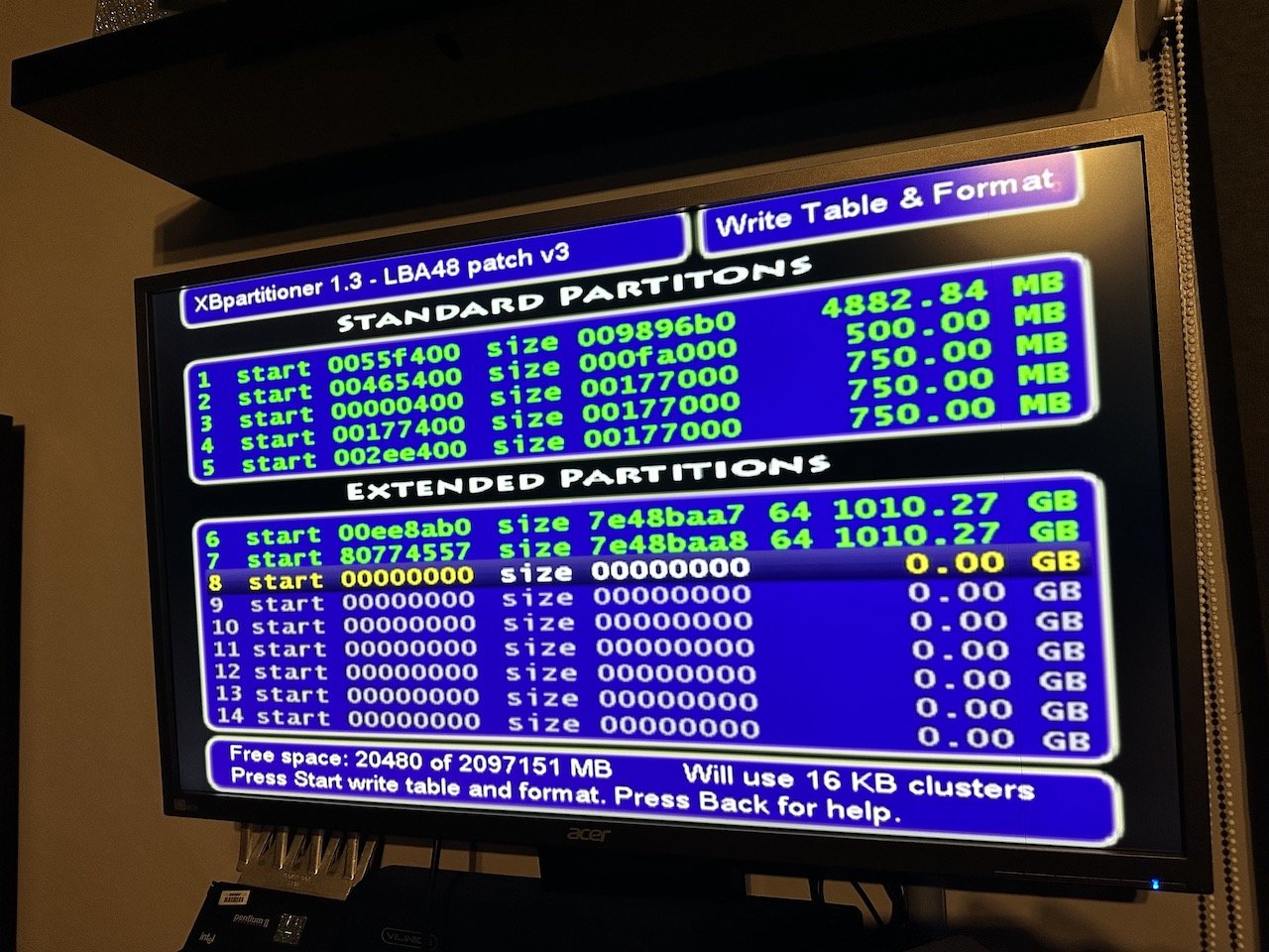

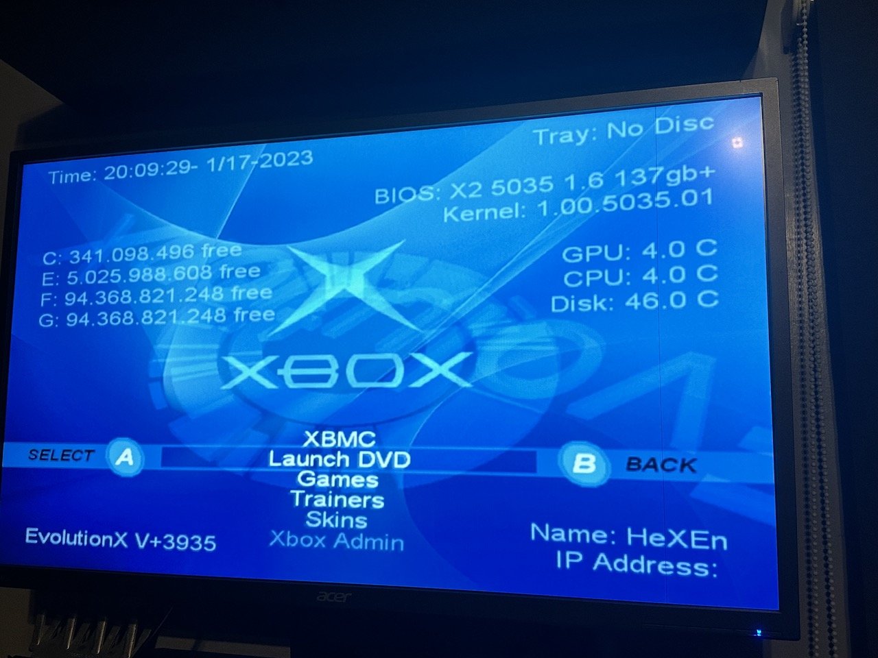

McFarTech Posted January 17 Report Share Posted January 17 Hi Team. Can i have a sanity check please. I have a Crystal Xbox 1.6 with a Xecuter 2.6CE i think. I have put a 3TB drive in the XBOX. Used HeXEn and setup the F & G drive and formatted. Am i now seeing 1TB on the F & G Drive correctly? Quote Link to comment Share on other sites More sharing options...
MadMartigan Posted January 18 Report Share Posted January 18 (edited) I believe you might be capped out, at right over 2TB for the bios you’re using. So you’re not able to take advantage of the 3TB HDD. Up until the last year or so that was the xbox’s maximum capacity. Now, You could change your bios to Titan or Cerbios and run up to around 16TB I think. If you do swap to either one of those, then you can just put everything on F: and save the hassle of opening different partitions when you go to add new games. Edit: I could have something wrong there, so someone more knowledgeable can update. Edited January 18 by MadMartigan Quote Link to comment Share on other sites More sharing options...

Geeba Posted January 19 Report Share Posted January 19 Been out of the scene for a long time now but from memory pretty sure MadMartigan is correct.... your current BIOS can not see past 2.5Gb 2 Quote Link to comment Share on other sites More sharing options...
KaosEngineer Posted January 19 Report Share Posted January 19 7 hours ago, Geeba said: Been out of the scene for a long time now but from memory pretty sure MadMartigan is correct.... your current BIOS can not see past 2.5Gb 2.2TBs 1 Quote Link to comment Share on other sites More sharing options...
