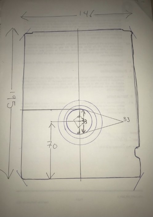

i want to do a DVD Perspex mod on my XBox Samsung player.
i’ve looked all over the internet and the only place I found supplying a MOD is GhostCase.com.
There is a company that will cut the Perspex for me but they want a DXF file or ai formats.
I want to do a similar MOD to STUDIO-FR
has anyone done this MOD before?
how can I make a DFX file?

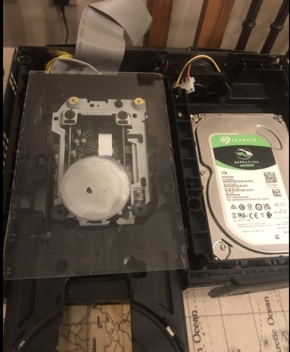

I am thinking of cutting the circle magnetic disk and round holder + circle lid out of the aluminium tin DVD lid and gluing it to the bottom side of the Perspex.
this will ensure that the disk is the right hight from the laser to lift its arm.
i will try and test everything first and then maybe document it if perfect
Ok

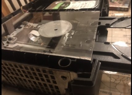

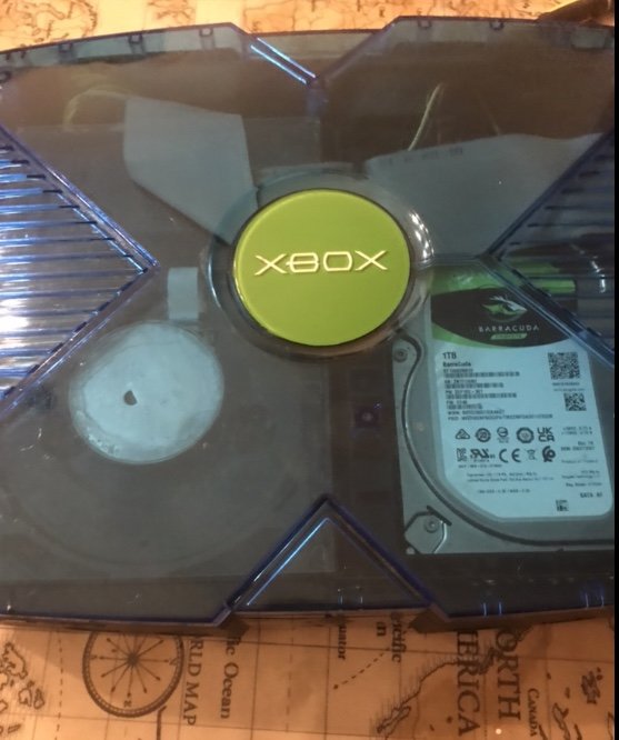

so I have completed the mod
i used normal super glue & not Arodite.
Arodite would have been quicker but I couldn’t find any that dried transparent only clear.
im scared to test it just yet & found to leave it 24hrs to dry before playing around
