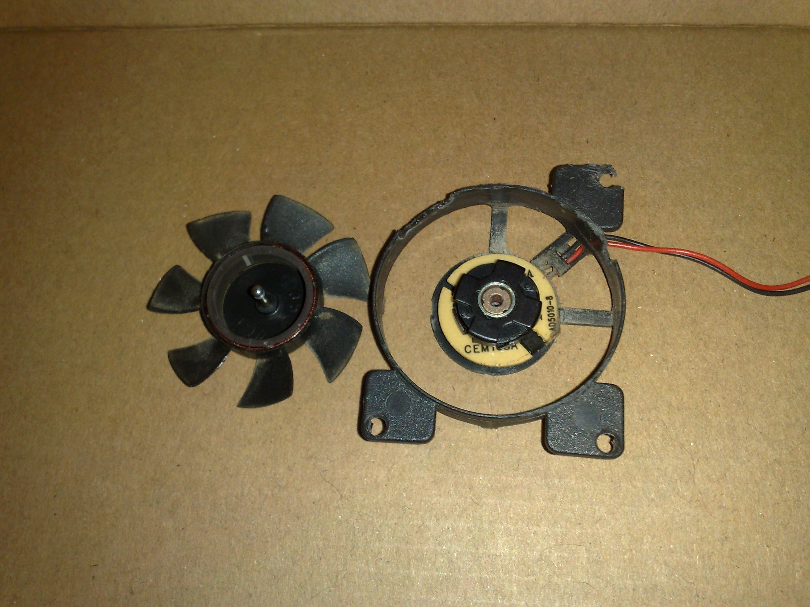

prtscn Posted November 19, 2022 Report Share Posted November 19, 2022 Recently discovered that it is possible to fully disassemble GPU fan and service it properly. Fan is not using ball bearings, it simply pops off if you force it gently with both fingers equal amount of pressure on fan blades as close to the base of assembly. Loud fan is quite again. 2 Quote Link to comment Share on other sites More sharing options...
JackedLynx Posted November 21, 2022 Report Share Posted November 21, 2022 Good to know! What grease should be used for this? 1 Quote Link to comment Share on other sites More sharing options...
prtscn Posted November 21, 2022 Author Report Share Posted November 21, 2022 2 hours ago, JackedLynx said: Good to know! What grease should be used for this? Simple sewing machine oil will do. Other options are welcome, but sewing machine oil is easiest to find and tested. 1 Quote Link to comment Share on other sites More sharing options...

corona2222 Posted December 22, 2022 Report Share Posted December 22, 2022 i plan to get around to this, does the oil just go in the central hole or around the outside as well? i could use WD40 or oil that came with the hair clippers. Quote Link to comment Share on other sites More sharing options...
prtscn Posted December 22, 2022 Author Report Share Posted December 22, 2022 56 minutes ago, corona2222 said: i plan to get around to this, does the oil just go in the central hole or around the outside as well? i could use WD40 or oil that came with the hair clippers. hair clipper oil will do, you put oil inside the center hole only. And a little bit on the shaft, just coat it thinly. 1 Quote Link to comment Share on other sites More sharing options...
coldasijs Posted December 22, 2022 Report Share Posted December 22, 2022 7 hours ago, corona2222 said: i plan to get around to this, does the oil just go in the central hole or around the outside as well? i could use WD40 or oil that came with the hair clippers. The standard WD40 is not intended for this type of use. It will lube stuff, but it won’t last that long, it’s a very thin and light solution. Stuff like sowing machine oil are better suit for the task. 1 Quote Link to comment Share on other sites More sharing options...
KaosEngineer Posted December 23, 2022 Report Share Posted December 23, 2022 4 hours ago, corona2222 said: i plan to get around to this, does the oil just go in the central hole or around the outside as well? i could use WD40 or oil that came with the hair clippers. Do NOT use WD40. It is not a lubricant but a water removal spray and gets tacky/sticky when it ages. It will gum up the works! Quote Link to comment Share on other sites More sharing options...
