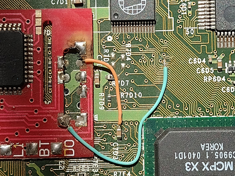

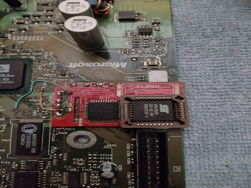

Hello everybody; I bought an xbox with chip as in the picture (an aladdin, but I don't know the exact model).
As soon as I turn it on I see the EvoX logo in the left corner, but as a bios entry, it gives me "unknown". Naturally the burned games start.

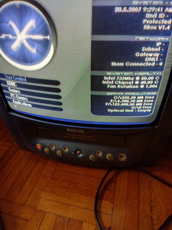

Using Xbpartitioner 1.3 FROM TRUHEXEN seems to work, but not and if i put all space (458,31GB) in F it give "ER"....if i split F and G, when i restart the dash
does not see G and F is 120gb...moreover, If I launch xbpartition from ssd, it gave me error "LBA48info not found!Custom partition will not work with this bios"
(but from dvd start).

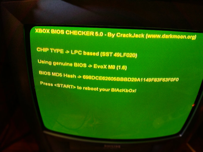

Installing the new dashes (and basic program) and launching unleashX dash, I see the bios entry "EvoxM8 (1.6) and xboxV 1.4" .... do I have to flash the bios?
1 minute ago, localgamerz said:
am amazed that even turned on. It's probably barely hanging on. did you use flux at all?
flux is must
too high temperature and prolonged exposure to soldering iron. High temperature is not that bad when you know how to handle it quickly.

I used fatxplorer and put the dir inside E partition, launch "Bios Chekers", and (see below);
now i don't know how flash bios with hexen disk....

1)if i launch Xbox bios cheker, i see unknow and a long list of thing
Bios Checker does not have the MD5 hash required to match all customized modified Xbox BIOSes.  Neither do all of the replacement dashboards.  It is up to the creator - you - to add the correct MD5 hash to all of the various bios id files for all of the apps.  Each one has its own slightly different format to include a BIOS's MD5 hash and name to be displayed for it when a match is found.
Edit: If there's no matching MD5 hash present, the BIOS's name is display as Unknown and in Bios Checker that long string of hex digits is the MD5 hash value it computes when accessing the BIOS address space of the Xbox.
Even more complex technical jargon follows :
16 MBs of address space is allocated to access the Xbox's BIOS; however, only 1MB of that address space is fully decoded to select the flash memory chip on v1.0 and v1.1 motherboards. This 1MB flash memory chip holds 4 copies of the same Xbox BIOS one after the other to fill the memory chip.  In a cost savings plan for v1.2-1.4 models, Microsoft switched the flash memory chip from a 1MB device to a smaller less expensive 256KB chip that holds only 1 copy of the Xbox BIOS; however, the bytes of the 256KB BIOS are accessible 64 times at muliples of 256KB blocks throughout the allocated BIOS address space of the CPU.
Some modchips break down the 1MB address space into either 4 individually addressable 256KB chunks to hold a 256KB size BIOS or 2 512KB regions to hold 2 512KB size BIOSes.
The reason Bios Checker displays 2 512KB MD5 hashes and 4 256KB MD5 hashes.  Each one could be different based on which modchip and BIOS is being used with a modchip.
