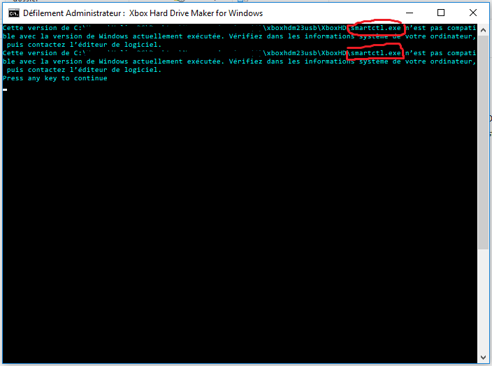

thank you for replying ,but i have a problem with SMARTCTL.EXE it said its not compatible
I think you'll need to edit 18 lines in xboxhd.bat:
if "%drive0%"=="PHYSICALDRIVE0  " if "%entry%"=="0" call lockhdd.bat a & goto menu
if "%drive1%"=="PHYSICALDRIVE1  " if "%entry%"=="1" call lockhdd.bat b & goto menu
if "%drive2%"=="PHYSICALDRIVE2  " if "%entry%"=="2" call lockhdd.bat c & goto menu
if "%drive3%"=="PHYSICALDRIVE3  " if "%entry%"=="3" call lockhdd.bat d & goto menu
if "%drive4%"=="PHYSICALDRIVE4  " if "%entry%"=="4" call lockhdd.bat e & goto menu
if "%drive5%"=="PHYSICALDRIVE5  " if "%entry%"=="5" call lockhdd.bat f & goto menu
if "%drive0%"=="PHYSICALDRIVE0  " if "%entry%"=="0" call unlockhdd.bat a & goto menu
if "%drive1%"=="PHYSICALDRIVE1  " if "%entry%"=="1" call unlockhdd.bat b & goto menu
if "%drive2%"=="PHYSICALDRIVE2  " if "%entry%"=="2" call unlockhdd.bat c & goto menu
if "%drive3%"=="PHYSICALDRIVE3  " if "%entry%"=="3" call unlockhdd.bat d & goto menu
if "%drive4%"=="PHYSICALDRIVE4  " if "%entry%"=="4" call unlockhdd.bat e & goto menu
if "%drive5%"=="PHYSICALDRIVE5  " if "%entry%"=="5" call unlockhdd.bat f & goto menu
if "%drive0%"=="PHYSICALDRIVE0  " if "%entry%"=="0" call checklockhdd.bat a & goto menu
if "%drive1%"=="PHYSICALDRIVE1  " if "%entry%"=="1" call checklockhdd.bat b & goto menu
if "%drive2%"=="PHYSICALDRIVE2  " if "%entry%"=="2" call checklockhdd.bat c & goto menu
if "%drive3%"=="PHYSICALDRIVE3  " if "%entry%"=="3" call checklockhdd.bat d & goto menu
if "%drive4%"=="PHYSICALDRIVE4  " if "%entry%"=="4" call checklockhdd.bat e & goto menu
if "%drive5%"=="PHYSICALDRIVE5  " if "%entry%"=="5" call checklockhdd.bat f & goto menu
All of these calls to lockhdd.bat, unlockhdd.bat and checklockhdd.bat need to have 32 added before the extension dot bat (e.g., change lockhdd.bat to lockhdd32.bat).
Better still make a copy of xboxhd.bat named xboxhd32.bat and change all those lines in it.  When using XboxHDM23USB on a 32-bit installation of Windows, start XboxHDM23USB using xboxhd32.bat instead of xboxhd.bat
