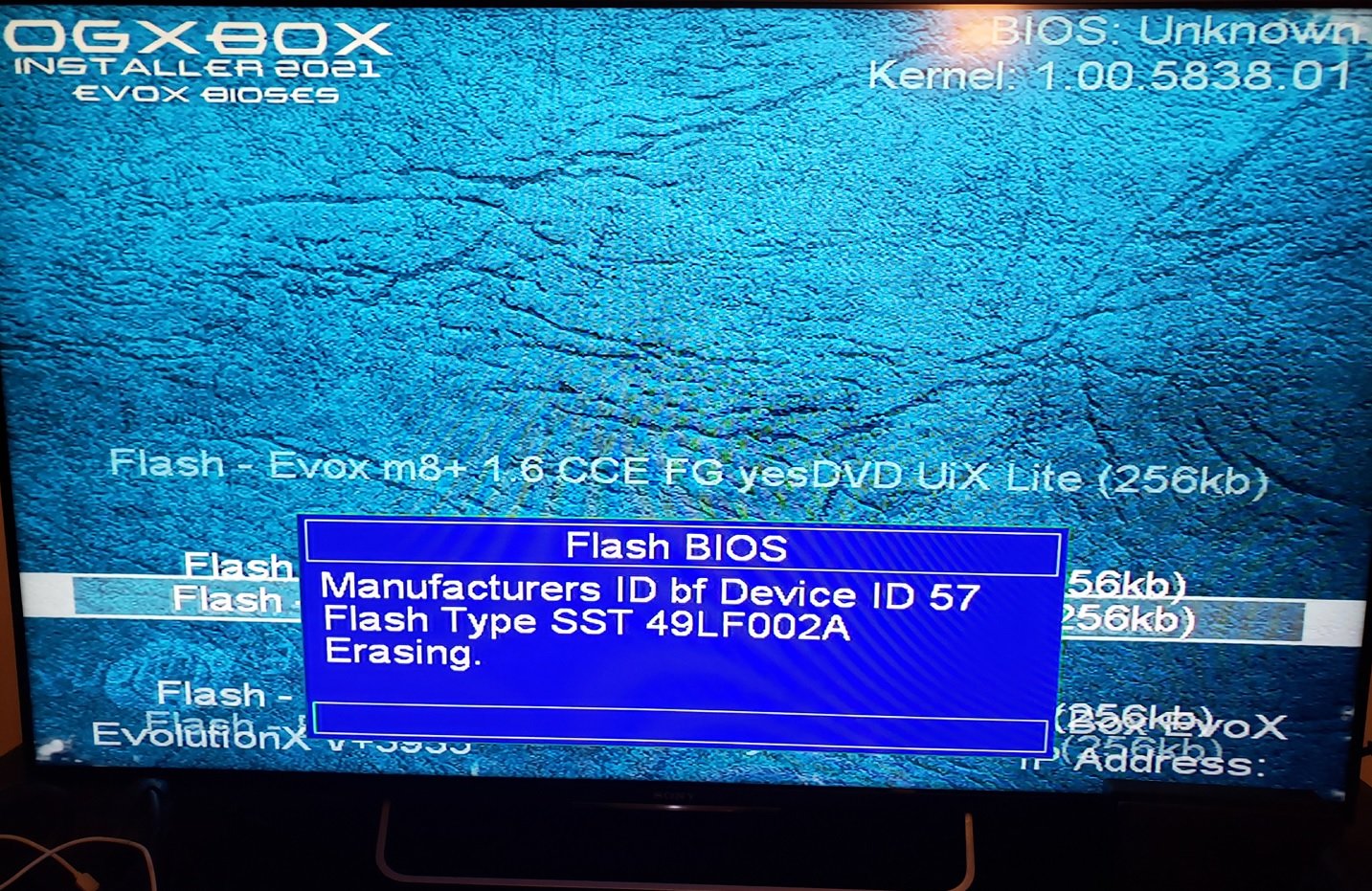

Now i tried to flash Evoxm8+ via OGXbox Installer but it just freez on erasing
That is the second 49LF002B which is not flashable. EvoX should be able to flash the chip without a problem but, like Dave said, try XBlast.

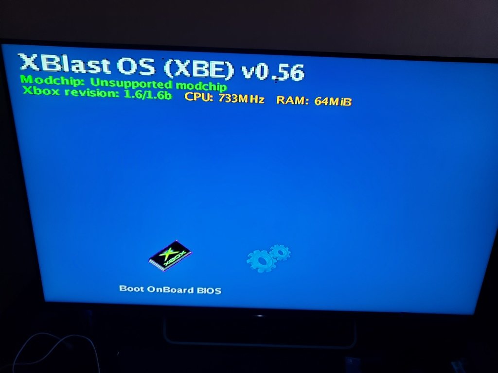

Unfortunately when i run XBlast i get "Unsupported modchip".
There are few screens of error and modchip itself.

You can ignore the "Unsupported modchip" massage. This is just if you would like to flash XBlastOS to the Modchip.
So just select the wheel symbole on the right and try to flash the chip (HDD Flash option).

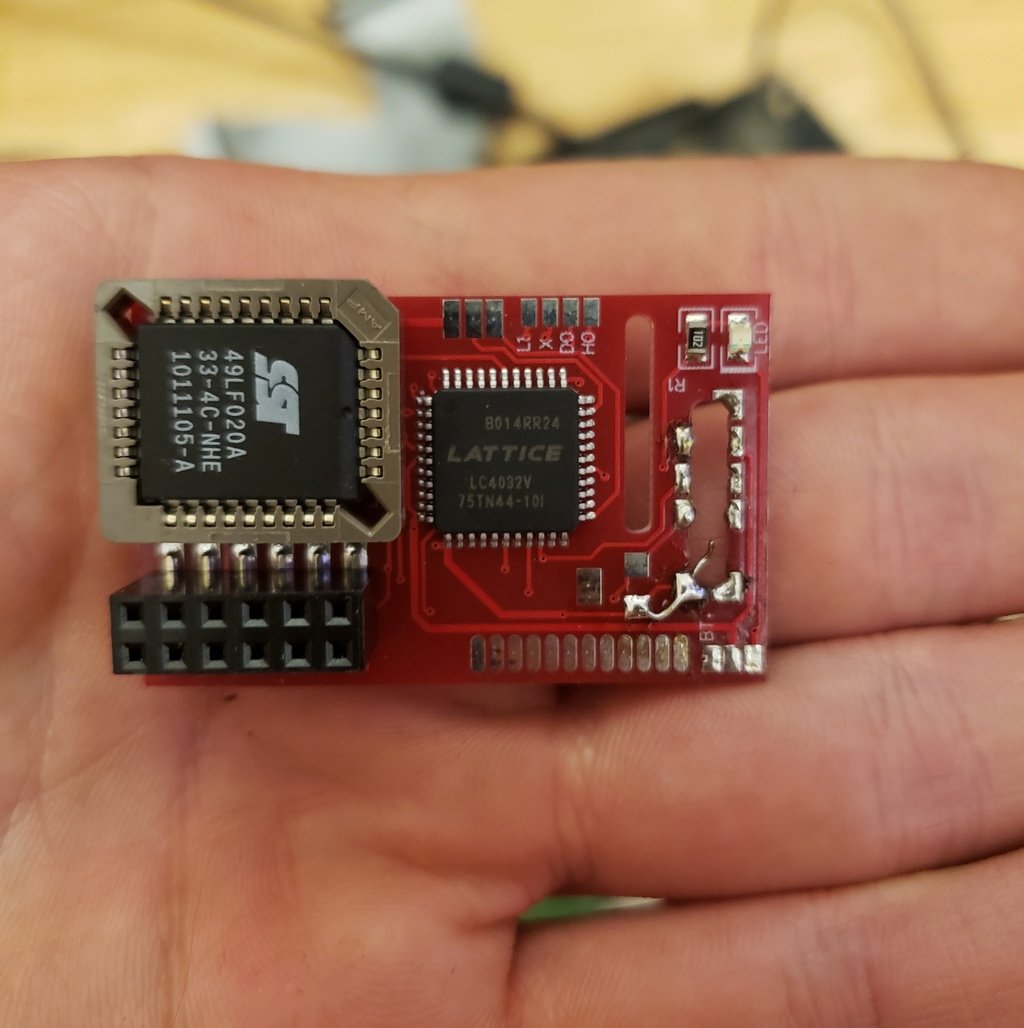

Thanks for the pictures. Thats the same chip the other user had which was also not flashable. I begin to wonder if that Lattice controller causes the problem. To me it looks like a "fake" controller chip. The SST though is fine and looks original. In case you have an external programmer on hand, you could flash the SST with it.
However, the SST chip is mislabeled as an 49LF020A, not 49LF002B
The flash chip's JEDEC ID reports the  manufacturer ID of 0xbf (SST) and the device ID of 0x57 (49LF002B), not 0xbf (SST) 0x52 (49LF020A).
Edit: I too am trying to help another user with their similar looking Aladdin modchip.
Right, now that you say that, I see it as well. Didn't paid to much attention to the "stuck on flash" screen.
I have quick checked the evox.ini and both are supportet there:
  • Flash = 0xbf52,"SST 49LF020A",0x40000
  • Flash = 0xbf57,"SST 49LF002A / 49LF002B",0x40000
So the problem could maybe the lattice which tries to use 0xbf57 instead of 0xbf52 because of a misslabeled SST? That would meen, that it would be impossible to flash these chips whitout reflashing the Lattice with an programmer or flashing the SST external.
Some weeks ago, I had some fake DuoX2 chips which I was not able to flash. I needed to desolder them and flash them with my programmer. But after that they worked fine but still not flashable when soldered (Not even when I used the fix which was on the website to force them into flash mode).

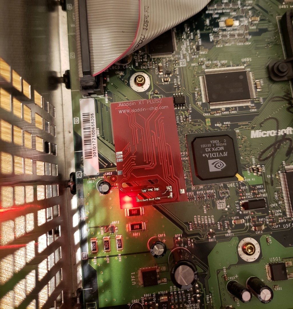

In this pic the chip would not be active and it will never flash...
