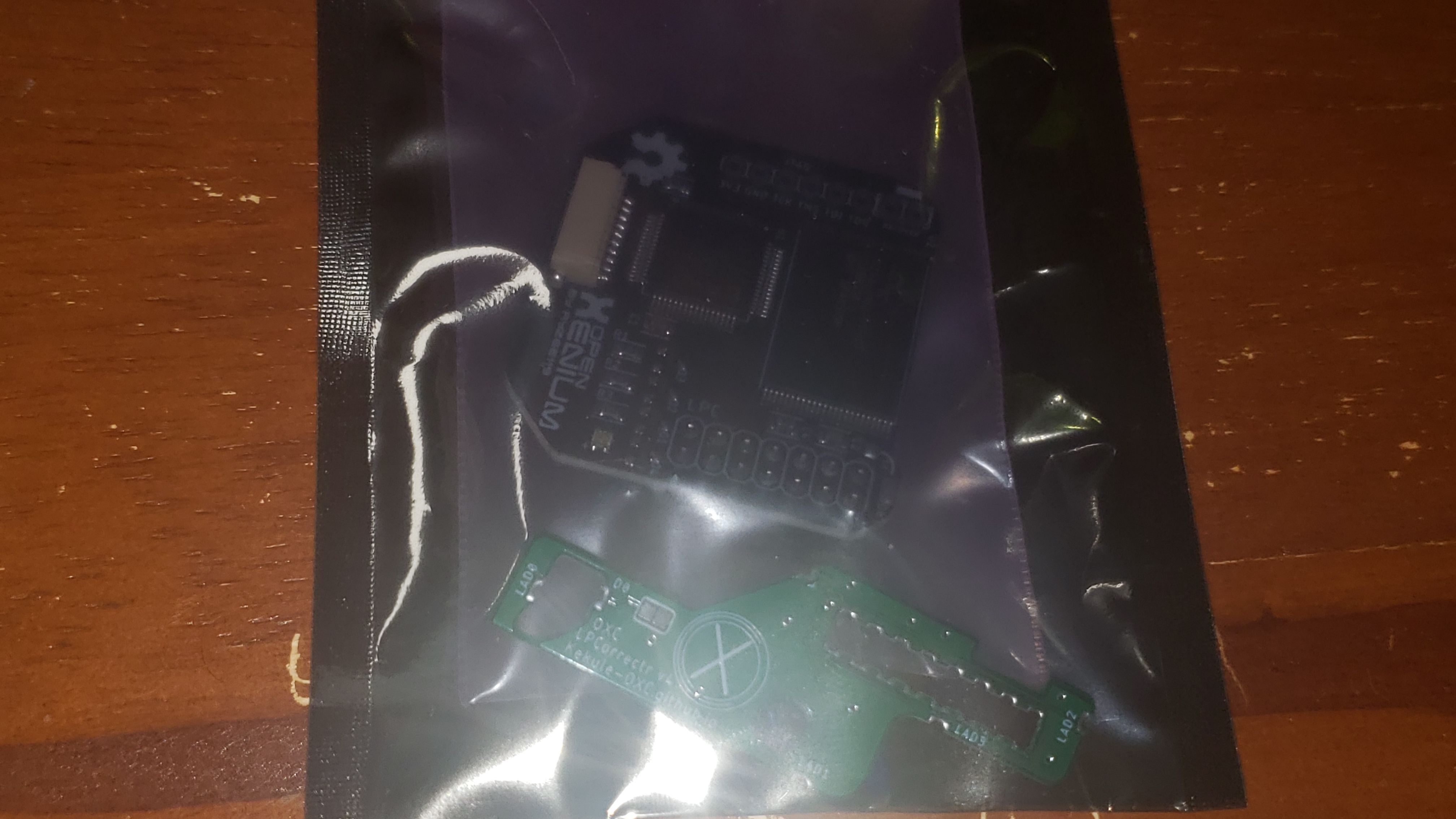

I finally have a open xenium
Logh3f82
If you are not confident at soldering then find some old circuit boards and practice on them 1st.
If you are fitting to a version 1.0 - 1.4 you don't need that small board
Work in a well lit location and take you time and don't forget Flux is your friend.
If you are not sure Stop and ask questions

I know my system is a 1.6 so i think i need that board. will use lots of flux.

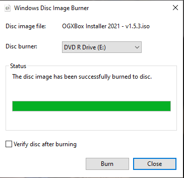

The ISO file is about 4.5gb and it will fit on a DVD-r blank, When you burn it write as slow as the software will go and use a brand name blank (Verbatim).
I use a freeware program called Express burn by  NCH software.
I tested Imgburn and it took 18.5 minutes to burn disk at  1X speed from the (OGXBox Installer 2021 - v1.5.3.iso) file
Use the Write image file to disk option
I also set the write speed to 1 and unticked the verify option
When it's finished the PC will not be able to read the DVD disk.

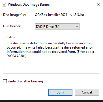

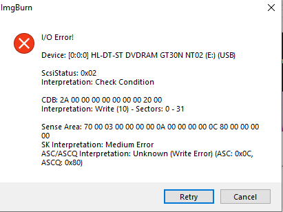

Yes i did that. Just i got errors and it would not complete.
On 4/25/2021 at 5:39 PM, SS_Dave said:
What errors and what was the iso file name ?
Sorry for late reply i just got back from a trip but this is an error i got from a recent attempt.
2 hours ago, SS_Dave said:
Did you have the Verify option Unticked as after the disk has burned a PC can not read it
Yes it was unticked just right after i pressed start i got hit with errors.
