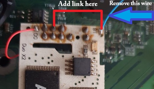

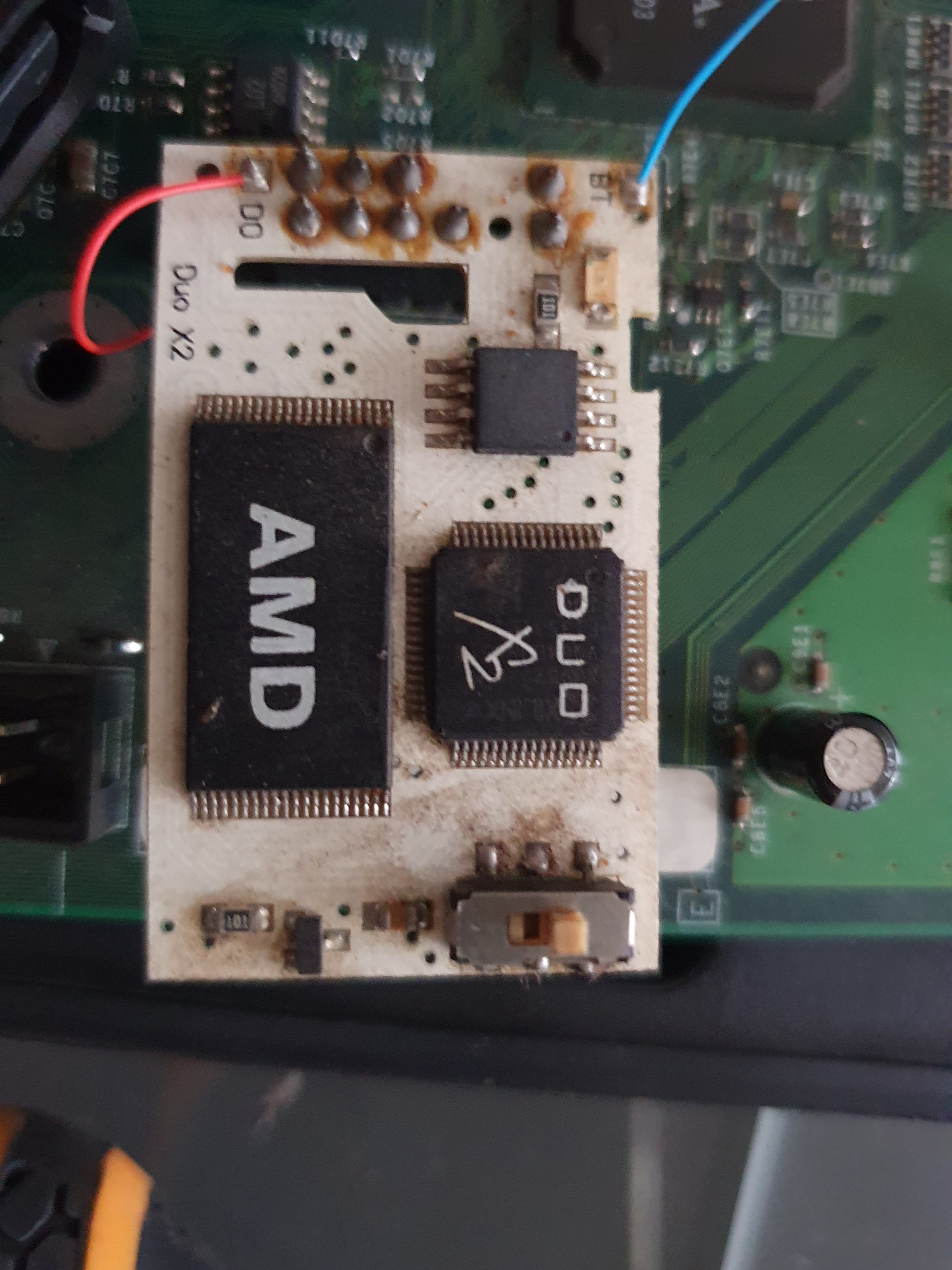

Hello,
I am new to Xbox. I recently bought a Xbox v.1.6 and when I opened it I saw a modchip Duo X2 AMD. My problem is as follow: when I turn it on pressing the power button sometimes it boots to a blue screen (Linux Cromwell) and sometimes it boots to to xbox dashboard with a Evo M8 on the top left corner. How to control this boot process? How to know whrn to boot to each of the screens?
There is a switch on the modchip and when I turn it tl the other bank it boot to FlashBios 3.0.3.
My real problem is that I dont want to boot the blue Cromwell screen. Can somebody help me?
Regards
